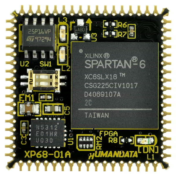

Perhaps members here have seen and used one ?
Seems convenient and useful like PSOC.
http://www2.hdl.co.jp/en/index.php/plcc ... -menu.html
..lak
 Post subject: Re: FPGA in PLCC68
PostPosted: Mon Jul 07, 2014 8:23 am
Posts: 10962

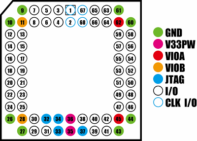

Thanks - that does seem interesting! (A module format with standard pinout in a socketable PLCC68 format, with a variety of CLPDs and FPGAs to choose from. 50 user I/Os available. A Spartan6 LX16 is £72 / $130.)
http://www2.hdl.co.jp/en/index.php/plcc ... -01-m.html

I wonder if they doubled up on the I/O's. Don't the FPGA's usually have more ?
I'm supposing the other IOs are basically lost and not exposed on the PLCC pins. For certain applications logic cells are more useful then IO pins, I guess. Video for an 8 bit micro being one of them. :)

If 64K is enough, the CHOCHI may be a better (and cheaper) alternative for a video controller; it has an FPGA plus 128KB RAM. There are also a couple of compact FPGA boards on tindie that look like promising, and also a TMS9918 reimplementation at http://codehackcreate.com/archives/30
