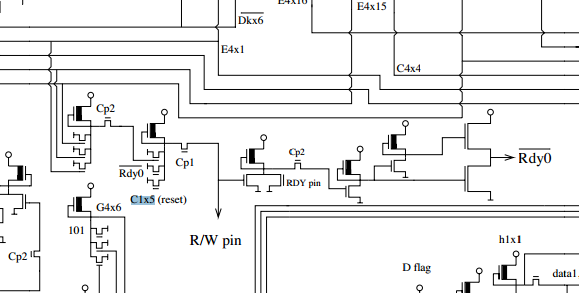

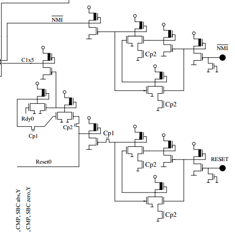

I had a look using visual6502 and also the giant schematic (pdf) by Balazs Beregnyei.
It turns out that there's an extra transistor to suppress the writes during reset. The crucial signal is called C1x5 in the schematic, and C1x5Reset in the visual6502. It's produced near lower right of the schematic, or here on the chip:
File comment: This corner of the 6502 - bottom right in Balazs' schematic - derives the internal signals Reset0 and C1x5

Here's the C1x5 signal in action, the logic is a bit lower left of dead centre of the schematic:
File comment: The RnW logic takes in the C1x5 signal

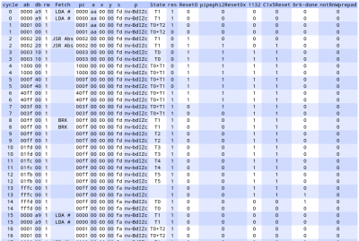

Here's a 6502 simulation showing the latching of the reset value, which is held until the end of the BRK sequence, and which suppresses the three writes to the stack.
Here's the crucial pull-down transistor t3455 on the chip.
