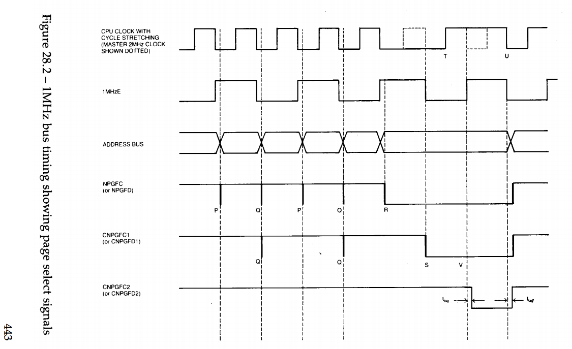

Unfortunately this method may result in duplicate accesses - see App Note 3 or Figure 28.2 on page 443 of the Advanced User Guide:
Anyone got a reliable, simple and glitch-free solution to the problem of accessing slow peripherals?
