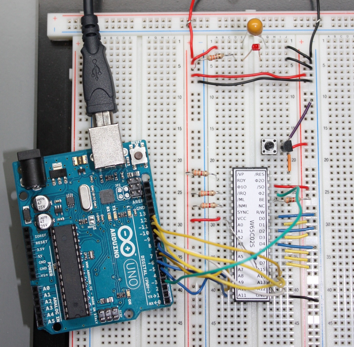

For those of us without a logic analyzer, the first steps of a free run (without ROM) will work with an Arduino. Based on Coronax' example (http://coronax.wordpress.com/2012/11/11 ... n-circles/), I set up a 65c02 with the A15-A08 address lines leading to digital input pins of the Arduino. An output pin provides the clock.
The output is a bit basic -- just the high byte of the address -- but, meine Güte, it's alive!
USq Prototype Free Run Output 20131013.png (21.02 KiB) Viewed 1847 times
I'm not sure if the Arduino is fast enough for a 1 MHz clock can, will try to find out in the coming days. The little thing is really cool. Just should have bought the Mega for the extra I/O.

I can now state that the Arduino method of signal detection works with a 1 MHz system clock (comment out the delay instruction). I'll be rewriting the sketch for more general use when I find the time, though blinking lights are more dramatic, I must admit.
