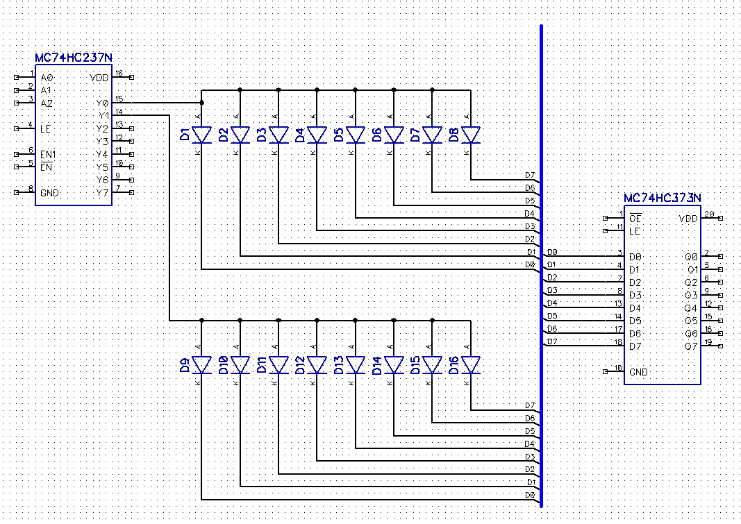

Just another idea, to build something like this as a TTL-Version.
Several 4-to-16 or 3-to-8 decoder could be cascaded to create a 8-to256 or 7-to-128 decoder providing simple address-line decoding for the"ROM"-input.
A octal latch could aggregate the data-lines to provide a 3-state output.
Just take the picture as example. If you remove a diode, you set a bit to "0" if the diode is present, the bit is "1".
It should be possible to create a PCB the provides two pin-header for each byte in rows of the several "bytes". Up to 4 or 8 bytes could go in one row.
Then you can start to set bits to "1" with a diode, or leave it "0" by let the connection open. A set of 100 schottky diodes is about 8 or 9 bugs maybe less if you get a good price.
You end up with a PCB that has 7 or 8 address lines, 8 data-lines and a "/OE" line that could act as a simple 128 or 256 byte ROM you can mask by your own.
are 128 bytes enough for bootstrapping code?

Yes, you can surely do it with diodes, and despite Arlet's "Practical guide"(!) I think diodes might be more practical than cores...
In a previous thread it looked like 32 bytes should be enough for a minimal bootstrap over a UART. Bootstrapping from other kinds of peripherals might be harder, of course.
(See http://research.microsoft.com/en-us/um/ ... 000356.htm)
