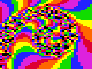

And since it's a Mandelbrot program here are a few pictures for your viewing pleasure/annoyance. First up is a recreation of Figure 2 from the article, using the new routines. I used this for testing and comparison since it doesn't take very long to run, compared to the other pictures from the article. An explanation of why this isn't exactly the same as the picture from the magazine is in the documentation, so I won't repeat that here.
Next up are two higher resolution pictures (each 200 x 150 pixels and more colors), which use the same X and Y coordinates and magnification as the lo-res picture. (The aspect ratio is 1.)
In this picture, the timeout value was 256 (the "distance" returned by MANDEL ranging from 0 to 256 was used as a color), and the 8-bit (per color) RGB values are:
color 0: R = 0, G = 0, B = 0
color c+0*51+1: R = 255, G = 5*c, B = 0
color c+1*51+1: R = 255-5*c, G = 255, B = 0
color c+2*51+1: R = 0, G = 255, B = 5*c
color c+3*51+1: R = 0, G = 255-5*c, B = 255
color c+4*51+1: R = 5*c, G = 0, B = 255
color 256: R = 255, G = 0, B = 255
where c = 0 to 50
In this picture, the timeout value was 258 (the color is likewise from 0 to 258), and the 8-bit (per color) RGB values are:
color 3*c+1: R = 255, G = 0, B = 3*c
color 3*c+2: R = 3*c, G = 255, B = 0
color 3*c+3: R = 0, G = 3*c, B = 255
where c = 0 to 85
