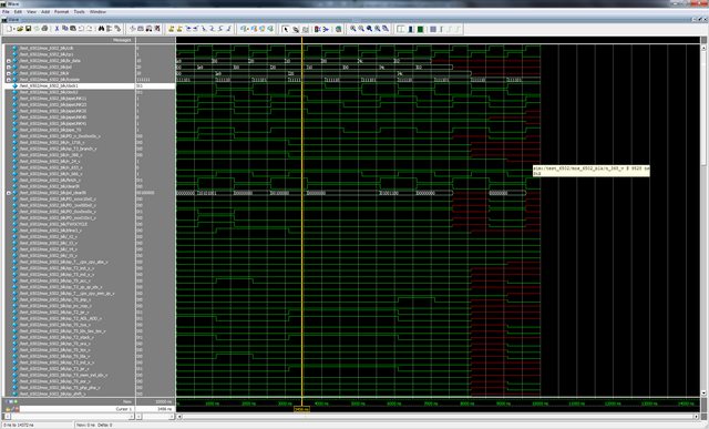

After putting in the PLA, IR fetching logic, and fixing a few mistakes, I got it to work:
For now, the test module manually feeds the correct data to the external databus. I'll need to add the logic for the address lines before it can run on its own.
Anyway, for the quick test, tcstate[0] and tcstate[1] were correct, which is what I've been working on.
With a little duct tape here, some bubble gum there, and a one paperclip I should have a fully working 6502 :P
By the way, whoever coded the "Trace These Too" feature on visual6502: many, many thanks! It's been so fantastically useful in debugging my code.

PostPosted: Thu Jan 13, 2011 7:14 am
Looks good. I'm also interested in the progress.
I did wonder about the dual clock. Right now you've inverted the clock, and are testing both edges. The simulator won't care, but have you tried running this through a synthesizer ? As far as I know, they usually aren't too happy with dual edge clocking.
An alternative may be to double the clock frequency, and run the phi1 stuff from even edges, and phi2 from odd edges using an extra enable signal.

Arlet, yeah, the clocking is a little weird. I updated the clocking code to more closely model how the 6502 generates its clock. From what I remember in the documentation it pushes the edges of the two clocks away from each other; far enough that it satisfies setup and hold times.
When I synthesize I'll try to setup a PLL or two to correctly generate the dual-clock.
Thank you for commenting on that!
After a bit more muscle work I've extracted the necessary bits for running the AB, ADL, and PCL. So the chip can now manage its own PC and set its AB correctly. The other tcstates are also simulated correctly now.

      pd <= bi_data;
      // Bus Control Signals
      ADL_ABL <= !n_653_v & n_24_v;
      ADD_ADL <= !n_256_v;
      PCL_ADL <= op_T5_jsr_v | op_T2_branch_v | op_T2_abs_access_v | ( !( op_brk_rti_v | x_op_jmp_v | op_jsr_v ) & !clock1 ) | !n_666_v;
      S_ADL <= op_T2_stack_v | op_T0_jsr_v;
      DL_ADL <= op_T2_ind_v | op_T2_zp_zp_idx_v;
   end
   always @ (posedge cp1)
   begin
      n_24_v <= !pipeUNK40;
      n_653_v <= !pipeUNK41;
      n_666_v <= pipeUNK23;
      if(ADL_ABL)
         ab[7:0] <= ADL;
      // Increment PC?
      I_PC <= pipeBRtaken_v | PD_xxxx10x0_v;
      if(!I_PC)
         {pch, pcl} <= {pch, pcl} + 16'd1;
      if(fetch_v)
         ir <= pd_clearIR;
      // Timing Control
      tcstate[0] <= (pipeUNK35 & !TWOCYCLE) | !pipe_T0;
      tcstate[1] <= pipe_T0;
      tcstate[2] <= tcstate[1];
      if(!tcstate[0])
         tcstate[5:3] <= 3'b111;
      else
         tcstate[5:3] <= tcstate[4:2];
   end
endmodule

Arlet: To be honest, I would much prefer to have done a single clock implementation from the beginning :P My job affords me the luxury of working with single clock systems all the time, with only the occasional need to cross clock domains (which I despise doing and debugging). But building this accurate implementation of the 6502 is a great learning experience for me, if for nothing else than working with dual-clocks.
As a side note, I believe the code I've written thus far is ever so slightly incorrect. It's registered, whereas the 6502 uses latches. So, for example:
begin
end
Should really be:
always @ *
if (cp1)
begin
end
which should correctly simulate a latch. I've always worked with registers, so I'm not even sure if the above would synthesize on the FPGAs I work with.
So far I've just worked around the differences but I may go back and update the code to be more accurate.
