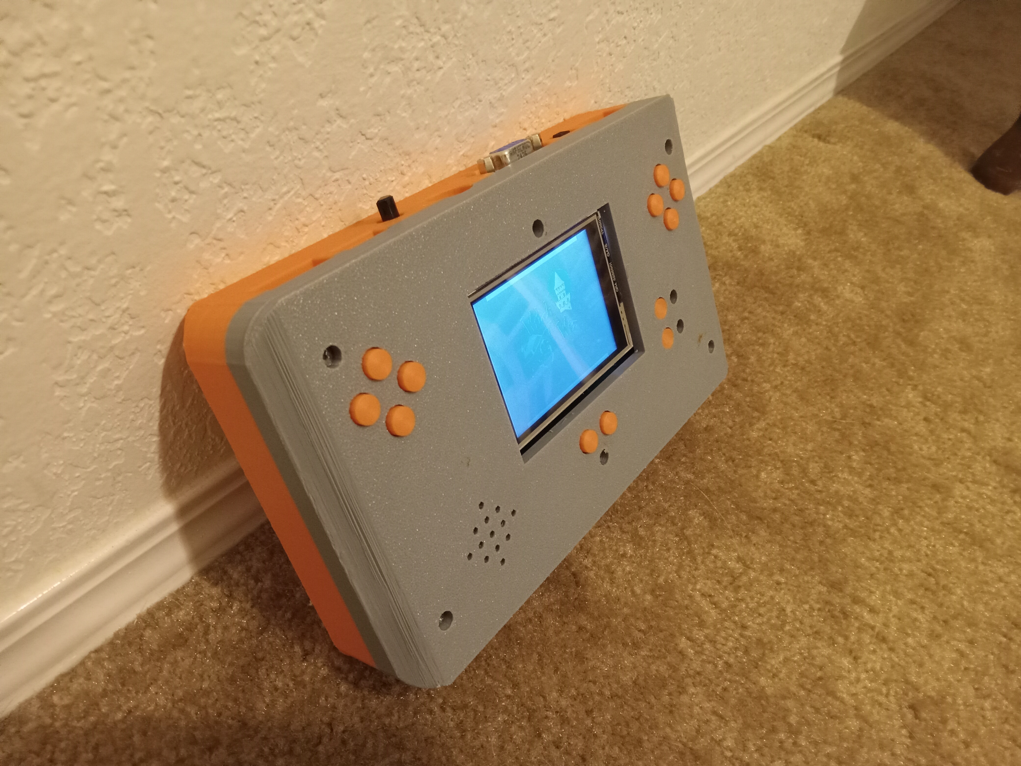

I got the GitHub page up and running!
https://github.com/stevenchadburrow/AcolyteHandheld
It has been a LONG week of coding this thing. Everything from USB woes to LCD glitches, I've seen them all now. Meanwhile I had to replace two broken components as well: the SDcard holder just popped off for some reason, and I snapped a button stem when trying to force something.
I reprinted the case and buttons, looks better! Still needs a bit of improvement.
Overall it's running great. About 90% of older NES games run on it without issue, another 5% need some adjustments. I'd say around 50% of homebrew games run on my NES emulator, I just don't have as much luck with them for some reason. Speed-wise somehow Mario 3 got 10% slower, I don't know why. Not sure what I included in my new code to slow it down so much *shrug*. Little readjustments like that will come over time.
That's all I got for now! Thank you everyone
Chad
