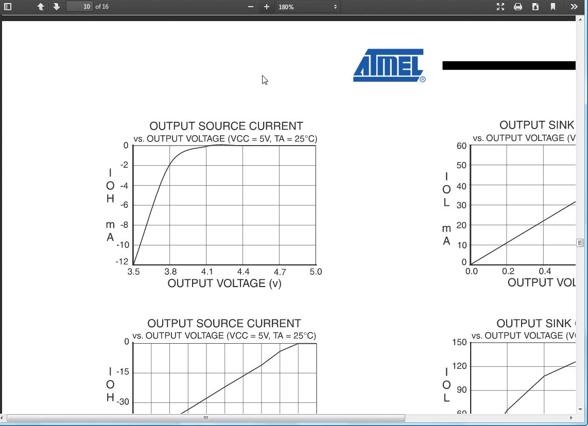

  1. Regarding the use of the 74HC11 to aggregate IRQ sources, VOH of a 22V10 is guaranteed to reach 2.4 volts minimum, regardless of loading.  In practice, the ATF22V10C usually does better if lightly loaded, but it is not assured.  The 74HC11’s outputs are guaranteed to exceed VCC × 0.7 under maximum loading, which is 3.5 volts in a five volt system.  If lightly loaded, the HC11’s VOH will reach approximately VCC - 0.1.  The 22V10’s unloaded VOH is nowhere near that.
    The problem isn’t merely one of can the device driving the MPU’s IRQB input get it high enough to clear an interrupt.  The problem is in how quickly that device can drive IRQB above the “trip point” at which the MPU will recognize that no interrupt is pending.  The rate at which the voltage at IRQB rises is determined by how quickly the device driving it can charge parasitic capacitance.  Depending on circuit design, PCB layout and how soon in your interrupt service handler the interrupt source is cleared, you could be inadvertently creating conditions for the generation of spurious (aka “ghost”) interrupts.
    Even with its relatively sedate output rise/fall performance, the HC11 will drive IRQB high enough to clear an IRQ faster than will the GAL.  This is because once the GAL’s output exceeds the theoretical 2.4 volt threshold, the rate of rise is not guaranteed and could be relatively slow under the not-insignificant loading imposed by parasitic capacitance.  As you ramp up the clock rate and hence reduce the time available to drive IRQB high, this lag could become a sticking point.
    Incidentally, I’d use a 74AHC11 to reduce prop time when an IRQ is cleared; prop time when an IRQ occurs is usually non-critical.  The AHC11 has the performance of 74AC logic, but the gentle edges of 74HC, reducing problems with ringing and other assorted noise.

The counter to #1 is this figure in page 10 of ATF22V10B datasheet. It shows output can drive to 3.5V sourcing 12mA or 3.8V sourcing 2mA or 4.1V with no load.
Counter to #2 is my experience with BB6580 ( viewtopic.php?f=6&t=7868 ). It is a design with 6502, RAM, and 22V10. RAM chip select is grounded. power consumption is 75mA at 7.37MHz. My guess is 90mA at 7.37MHz with addition of SST39SF010. I had an epiphany this morning while testing SST39SF010 that a flash can be easily added to BB6580 thus emulating the design currently under discussion. I'll build up a modified BB6580 but publish the results under BB6580 topic so not to hijack this thread.
Experienced designers frequently have different opinions. These opinions are generally valid, but you should always push ahead. The worst outcome of design review is "paralysis by analysis".

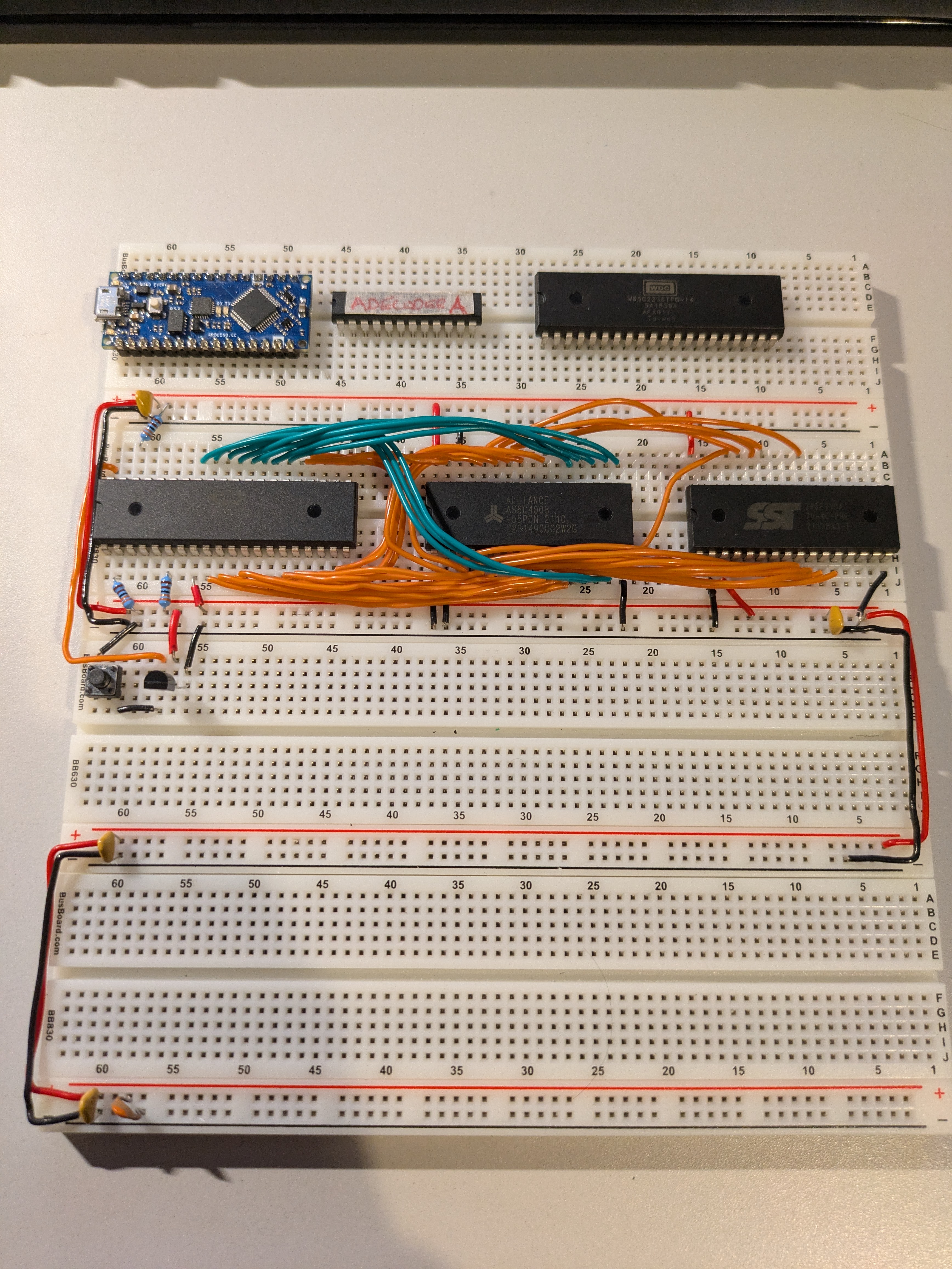

Well, it's been a while (Dec 24) since I did my last lot of 6502 tinkering. I ran out of spare time back then (and a little enthusiasm too), but I have a little more time on my hands now, so I'm picking up where I left off. In re-reading my posts to recall what configuration I had settled on, I'm not sure what was I thinking when I said...
