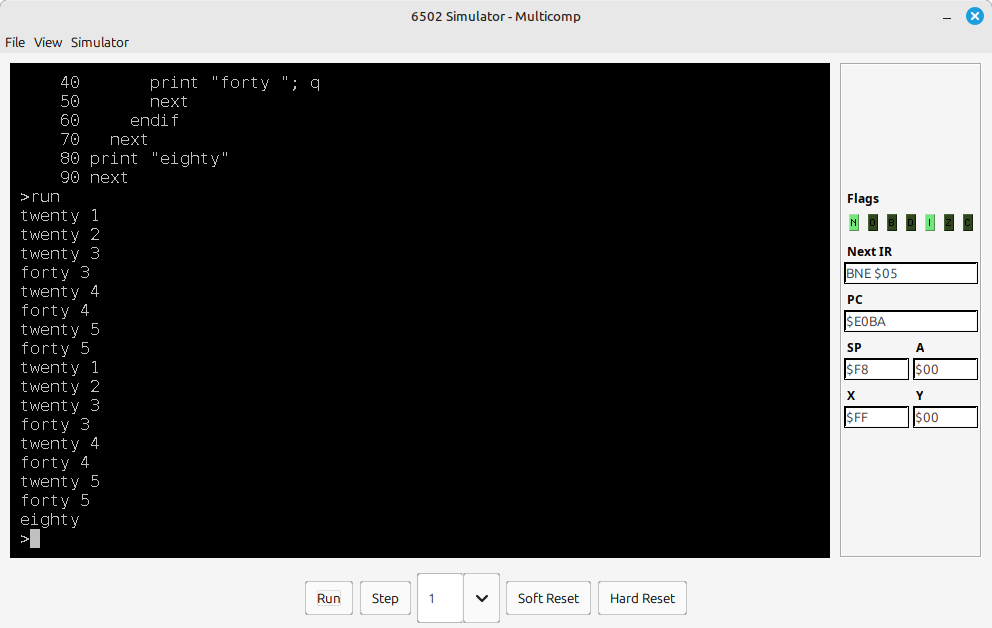

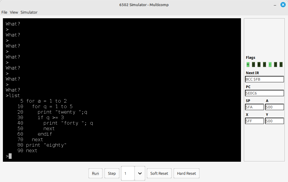

I very often write code where a FOR might have two or three NEXTs, or similarly for UNTILs. Perhaps I'm just a very naughty boy. Or perhaps such code should be illegal in a particular dialect which does try to match loop start with loop end.
<shudders> Ye gods and little fishies, I'd forgotten that such shenanigans were even legal, let alone expected... that sort of code's going to break my basic, I think. So, er, in my basic it's not legal, OK? :mrgreen:
p.s. yup, it breaks it; it mostly works, but this code with two nexts from a single for:
executes both the inner and outer loops the expected number of times, but it's clearly not matching the nexts correctly; line 80 is executed only once and its next is being treated as an end (reasonable: an endif, next, or return all do the same thing: nothing; they're considered markers rather than executable keywords).
