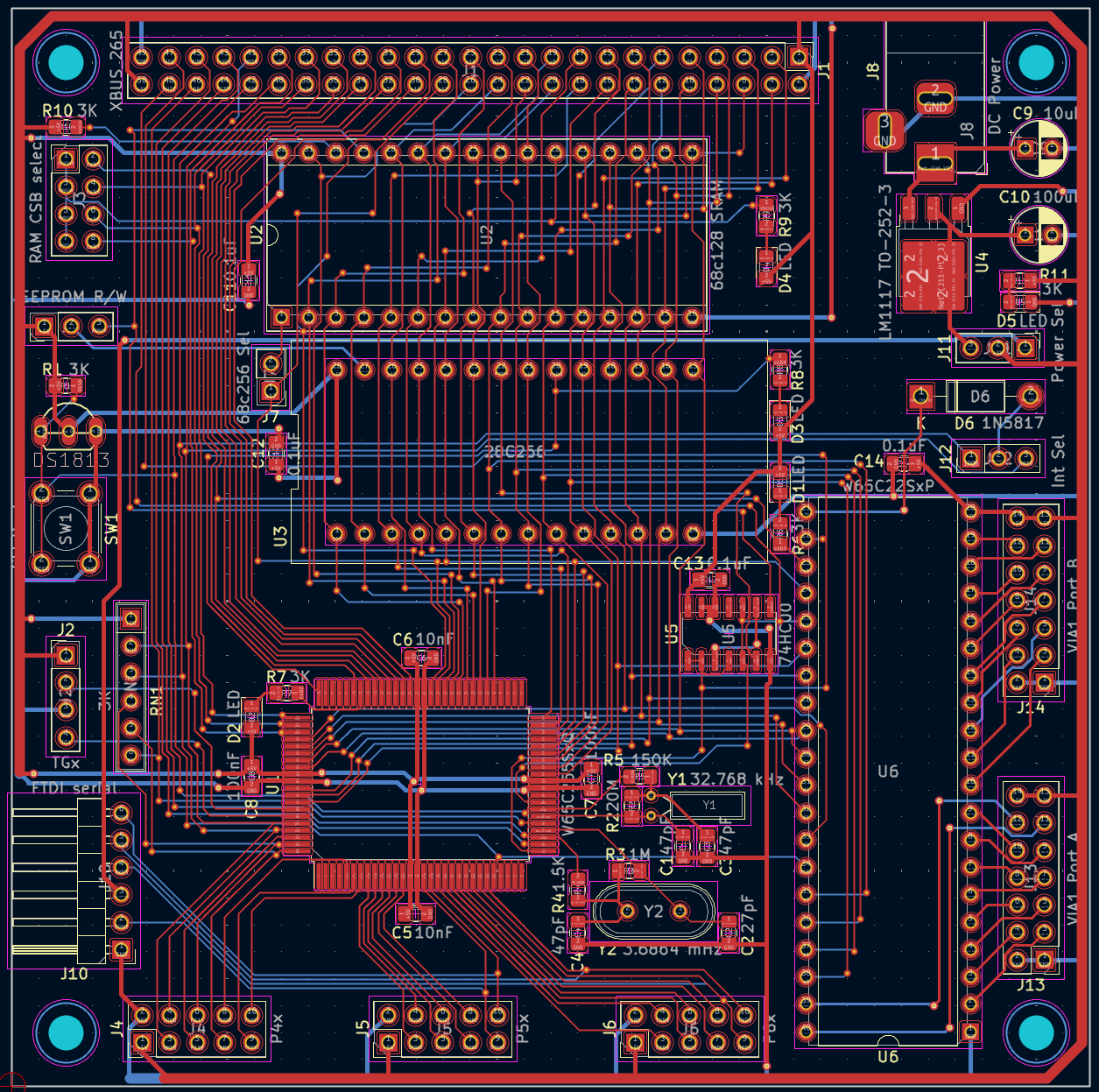

It was slow going but I managed to do the following:
I think I'm getting close. Unless I want to try and migrate all components to the front side.
Changed the mounting holes to 3.2mm which should allow either M3 or 4-40 bolts.
Double checked XBUS, J4, J5, J6, and VIA headers to make sure they're aligned with each other.
Moved some resistors to the front side of the board to allow routing traces under the w65c265.
Routed all bottom jack traces.
Changed EEPROM footprint to the low-profile ZIP socket.
Move components and traces to make space for the ZIF socket. It has about a 1/2 mm clearance between it the RAM socket.
Changed the width of the power traces to 0.4mm. That should be enough as this is only five CMOS ICs.

Just two thoughts. I prefer to have all my surface mount components on the front side (as you've mentioned) because then I can hot-plate solder them in a single go. Very often I can't and then that's just a bit of time with a soldering iron.
I would suggest moving the power lines slightly in from the edge of the board in case the router is misaligned during manufacturewhich happened on the board above. The mouse-bites are correctly placed* but the router is off my more than 0.5mm on some edges.
<edit>* I should have said correctly drilled rather than correctly placed. The router should have run straight towards the centre of the mouse bites.

I wondered if moving the SMD components to the front was worth it. Ideally the board would be useful to others, and they might use a hotplate for the SMD components. So, I will move them as it should be straightforward, except for C6 and C11 which are in in space constrained areas.
I had an inkling that putting the power rails right up to the edge might not be a good idea. But I was waiting until I was done with everything else before moving them in a mm or two.

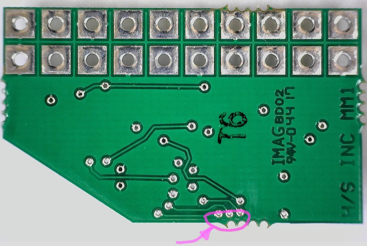

I've never seen routing errors as gross as the 0.5mm mentioned above, even from the cheap board houses; but if the boards are panelized (rather that separate), you do have to be careful of the mousebites, unless the boards are just scored. Typically you just present the gerbers for one board, and the manufacturer decides how to panelize them and where to put the mousebites. (I think Dave Jones of EEVblog recommended sending the gerbers for an entire sub panel, including where to put the mousebites; but his CAD is a whole lot more expensive than mine.) I have had this kind of problem at work:
This is the bottom of an SMT board that's about the size of our common postage stamps in the US. It wasn't too big of a problem in this case; but you can see that if I had put a signal trace or chip capacitors that close to the edge on the other side, it would definitely be a problem.

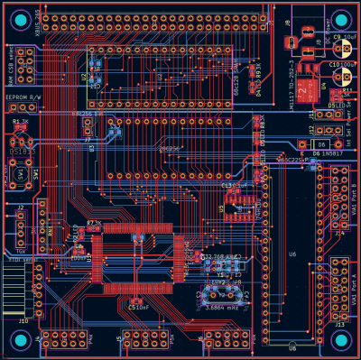

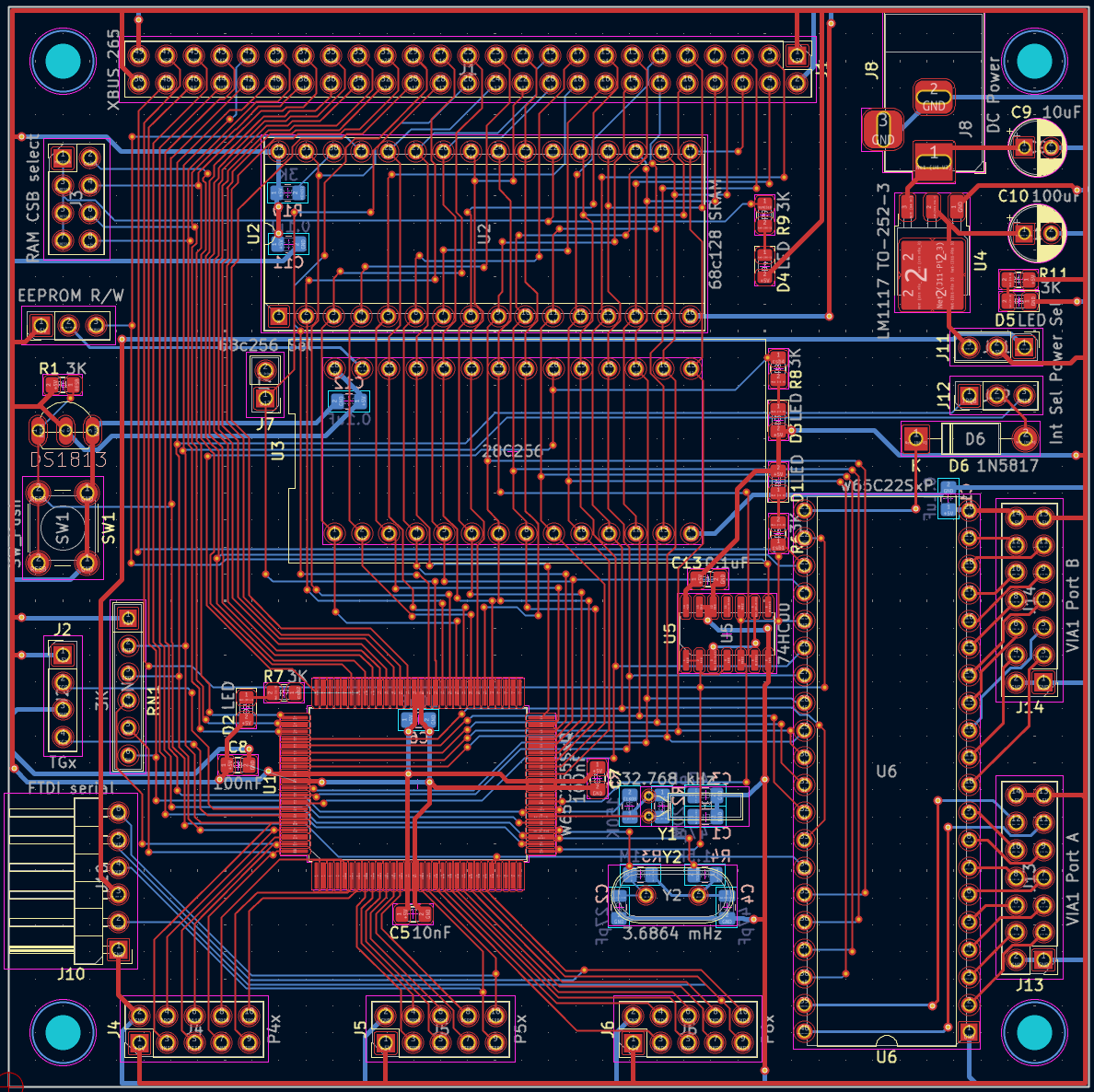

I reworked the PCB so all SMD components are on the front side of the board. Hot plate users rejoice.
I pulled the power rails back from the edge of the board a bit, cut the corners, and increased their width to 1 mm.
KiCad made a change to the project file to change pad defaults from 2.7 mm to 1.6 mm, and drill size to 0.8mm. I didn't make that change, but I checked it in assuming KiCad knows what it's doing.
Attached is a picture of the latest revision. Tomorrow I will go over it with a fine-tooth comb looking for errors.

@all, I have done the following QA steps.
* I spent time eyeballing the PCB and it looks good.
* I used the net inspection tool to validate the power and ground networks. All IC's get power and ground from the main power tracks with no loops inside the board. Nothing looked like it was missing power.
* I ran the design rules checker, and it found a number of small errors I corrected. However, the DS1813 footprint library has many problems, and I am not sure how to correct it.
* I ran the Electrical Rules Checker" as gilhad recommended. Most of the output was weird warnings that I am unsure about. Here's a sample:

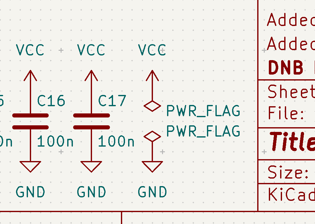

Apparently, I need to assign PWR_FLAGs to the schematic, but I haven't found where I need to do this.

@Martin:
Power flags define a particular network and to be honest I don't know exactly why (beyond the obvious setting of trace width) but it's easy to handle: you'll find them in the Power Symbols (use the button "Add Power Symbols"). Connect one to each circuit wide power and ground (usually Vcc and Gnd) - you don't need one, for example, for an unregulated power input between the fixed power plug and the regulator. As you've discovered: Kicad tries to enforce a no unconnected pins requirement; this ensures that you have no inputs floating, and that any unused outputs are intentional. As you've discovered, the 'Place No Connect Flag' button provides a way to mark those on your schematic. (In general, Kicad is good at making sure inputs are connected to outputs and so on, by pin type from the original symbol definition. Sometimes you'll disagree and get a warning or error, but like a compiler, it's worth listening - also like a compiler, I tend to correct only the first error and then run the check again; often errors are caused by an earlier error and will go away when that's fixed).

I think the idea is to attach PWRFLAGs to the thing that is supplying the power as that's not obvious to kicad - e.g. a barrel jack might be input or output. So apply one to VCC and one to GND in the schematic near your power source pins.

[power_pin_not_driven]: Input Power pin not driven by any Output Power pins - use PWR_FLAG to mark something as powersource, you know, where your power cam from, KiCad just try to make sure, that you did not forget power anything - place the flag anywhere on +5V and anywhere on GND nets.

@all, thanks for your feedback.
I updated the schematic, and this silenced all but six warnings in the ERC. The remainder were about the symbol library not containing the DS1813, the w65c265, and the RAM I am using. These don't appear to be critical, so I am ignoring them.
I updated the PCB from the schematic, and it only resulted in changes to description fields. I reran the DRC and 20 errors remained, and were all related to the DS1813 silkscreen errors mentioned previously. I believe it's because I downloaded a footprint for the DS1813 and the creator ignored these errors. As this is cosmetic and I don't want to create a custom footprint for this component, I will ignore it.
