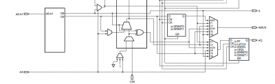

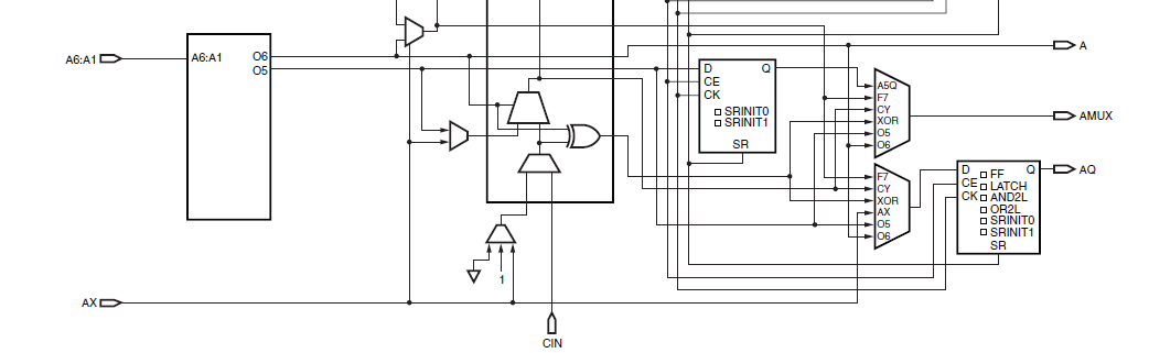

I'm trying to come up with a better way to do the ABH path. It is supposed to be simpler than the ABL path, because it basically needs to incorporate a mux, plus a carry from the ABL. However, there are a couple of annoying properties that make it hard to come up with a very simple solution.
First of all, there are 3 fixed values it must produce: 00 (zeropage), 01 (stack) and FF (vectors), in addition to 3 choices coming from registers: previous ABH, PCH, or DB. In some cases, we need to add a carry from ABL, but in other cases we must not, even though the ABL could produce a carry. For example, when doing (ZP,X) instruction where ZP + X generates a carry, we don't want to use that carry to propagate into upper byte of address. Instead, we want to wrap around zero page. Another example is any stack pull instruction when S=FF, where we want to wrap around inside the stack page. And then finally, we have the case of a backwards branch where we have to calculate ABH - 1.
Combining all these options in a nice design is quite challenging. The operations seem simple enough that you'd think that maybe it could all be combined in a single LUT, which was indeed my first try. It almost works, except for having to introduce some logic between the ABL carry out and the ABH carry in, and not being able to produce FF as an output. The FF can be hacked in a number of ways: when the output goes into a flop, we could use the extra 'set' input, or we could use the slice output latch to create an OR gate. Neither is very elegant, though, but the bigger problem was the extra logic layer in the carry path, since the carry out from the ABL is already slow.
The second plan was to use carry-select, where I would generate both the ABH for when C=0, and C=1, and then pick the winner. The problem is the backwards branch, which means these blocks need to be able to perform +1 and -1 operations, which then means access to carry chain logic, forcing these blocks into SLICEM/SLICEL slices.
My latest plan is to have 2 layers: first layer is a simple mux, selecting between 00, ABH, PCH, DB. Second layer then does +0, +1, -1, or +C, which can be done in 2 slices with carry chain logic (instead of 4). Also, by not using the carry input of the slice, but instead feeding the carry into a regular LUT input, we can combine the adder with the select logic (and maybe some microcode decoding) in the same LUT. It's a fairly clean structure, requiring 8 identical paths, and no extra logic. There's no extra logic in the carry path, and the carry isn't needed until the 2nd layer.
In the slice diagram you can see the "CIN" input at the bottom, where you would normally feed the carry input. Instead, I want to feed the carry in the LUT on the left, and then use the LUT logic to suppress it, based on the operation select. In the same diagram on the right, you can see that the ff/latch has an option to turn into a AND/OR gate instead of a latch or flip-flop.

Indeed, I now make the 3 constants by having the mux select 00, and then perform -1, +0, +1 in the adder. Similarly, when the mux selects the ABH input, we can create ABH-1, ABH, and ABH+1 for backward branches, same page, and next page overflow.
Because the carry chain requires 2 inputs (as you can see in the diagram above), the input LUT is configured as 2 LUT5s. One input goes to the mux output, another input to the carry in (only for bit 0). That leaves 3 bits for encoding 3 different operations, which may create some opportunities to decompress microcode at the same time. I'll still have to look into that. Similarly, the mux has also 3 bits for encoding 3 selections.
There is also the option of replacing the carry chain adder with lookahead adder, but since we have to do both +1 and -1, this requires more resources than the simple incrementer I'm using for the PC.

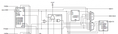

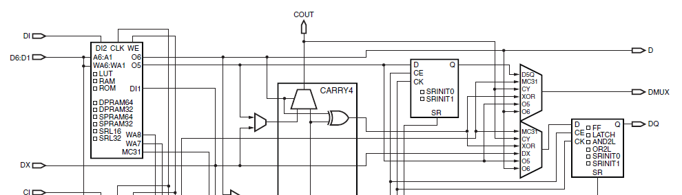

This is slightly annoying. In order to use the core with internal memory, I need access to the combinatorial output of the address calculation, but at the same time, I need a registered version to feed back into the logic.
The slice allows both, so I can place the flop inside the slice, and use the "DQ" output for the registered signal, and use the "DMUX" output for the combinatorial one.
However, I also need access to the "COUT" output of the carry chain. The signal that comes out of the top only goes to the next slice and attaches only to the "CIN" signal so that the carry chains can be extended. When you need access to the carry out, it needs to be routed out the DMUX/DQ output, but then it can't be combined with the other 2 outputs I need.
Edit: in addition, the only way to get both the data and the carry out, is to route one of the signals through the latch to the "DQ" output, causing an extra delay.
Edit2: even worse. As soon as one latch is used as pass-through, all the other latches have to be placed in the same configuration, which means that none of the flops can be used.

I'm looking into the ALU logic for BCD adjust and flags right now, and I realized something useful. In order to calculate the overflow flag and the BCD adjustments, it is necessary to examine the intermediate carry outputs.
However, as I showed before, when you need both the regular output of the sum as well as the carry, then one of the signals is forced to go through the latch, which restricts all latches in that slice, but probably also adds a little bit of extra delay.
However, looking at the slice diagram again, there is also a "D" output that comes straight out of the O6 port of the LUT without any muxes or latch in the path. When you're doing an addition, the O6 port produces the XOR of the two inputs (carry propagate), while the O5 produces the AND (carry generate). The O6 signal then goes into the carry chain block, and is XOR'ed again with the carry from below, producing the sum output bit.
That means if we take the "D" output and XOR it with the "DMUX" output, we can reconstruct that internal carry signal. Obviously, this is only useful when you can combine that XOR with other logic in the same LUT so it is free. Otherwise, it would be a better idea to feed the internal carry through the latch.
