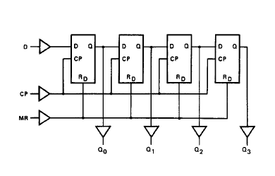

I'm not keen on them either, but I agree the margins are probably quite forgiving. Edit: I see you've just posted again, but I'll finish what I started...
I've thought about latching a single '595 after nine clock pulses, but that would require something like a counter and some gates.
Instead of using a counter, you can make the shift register count by adopting a "sentinel bit" approach. The shift reg can initially be cleared to all zeros, and you can arrange for the Start Bit to always be 1 (it's actually 0, but there's no great inconvenience to inverting all the incoming serial data).
Now you can be certain Qh' of the 595 will go high after exactly 8 clocks, and not before. And I would extend the shift reg by feeding Qh' into one of the two 4-bit shift registers in a 74HC4015. 8) This is an active part, in stock at Digikey in both SMD and TH. Or, its predecessor the low-speed 4015 might suffice.
74HC(T)4015.pdf
(49.25 KiB) Downloaded 168 times
4015 (one half).png (8.5 KiB) Viewed 3626 times
Now you have four more outputs, and they can dictate specific actions. One of them will go high when it's time for the '595 to copy its internal shift register into its internal output register, and a later 4015 output can clear both shift registers back to all zeros. (On these last two points, be mindful of the timing.)
Half of the 4015 remains available, so I would just ignore 3 of the bits and use it as a flipflop. It should be adequate to store the "I need interrupt service!" flag. :mrgreen:

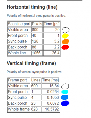

I have wired up a couple 12-bit counters and some diodes that generate VGA sync signals (I'm amazed that such a mess works). That is for a 800 by 600 resolution, of which I may be using 200 by 150 (divided by 4). That would result in 25 columns by 16 rows of 8 by 8 characters (some amount less than the VIC-20) See attached, each square (and lack of) would be a character.
It would be 25 columns + 7 to complete 32. It's wasted RAM, but simplifies hardware.

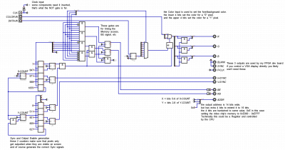

If you want to test a VGA circuit before actually building it in RL, i'd recommend Digital
It has a component that behaives exactly like a VGA Monitor and it allowed me to test my own VGA video chip.
and the simulated display was identical to the RL one when i tested it.
here a comparation:
the colors are a bit washed out on the RL one but that's more of a monitor thing than a circuit problem.
it also has a lot of 74xx chips build in, so you can build a circuit that you can also do in RL with the same components.
anyways, I'm trying to understand your notes by building the circuit in Digital. (or something very similar to it)
the sync signal is the easiest part to get right. you just count and check, and set the H/Y Sync with some flip flops.
the actual drawing of pixels though, oh boy that took me some time.
a few things i noticed with your design that confuse me a bit.
1. why the RAM chip? as far as i understand your notes it looks like you read from System Memory into your "VRAM" and directly afterwards into the shift register.
so why not skip the middle man and read directly from System Memory into the Shift register?
2. your notes state that everytime the bottom 3 bits (bits 0-2) of the X (ie horizontal) counter are high it loads a new byte into the shift register,
which confuses me a bit as i thought your target resolution was 1/4 of the original one, so you would need to shift everything 2 bits higher, but you still need to check the first 2 bits as well... so you would need to check for bits 0-4 to be high to load new data.
3. this is kinda connected to 2.. because the clock you seem to use for your shift register seems to be the full 40MHz clock, right? technically if you use 1/4 of the original resolution the speed at which you output pixels should therefore also be divided by 4, so the shift register would need to run at 10MHz instead.
that way the pixels are being strechted to be 4 times longer than originally, and each line should also be drawn 4 times in a row. (which seems to be the case in your notes). so that it fills out the whole screen.
ok so, after too many hours... here is what i made based on your notes.
the circuit i made is kinda like me, it's a mess... but a functional mess.
if this circuit were to be implemented 1:1 in an FPGA it should work like you desribed yours.
just without the RAM inbetween, this one generates a Bus Enable signal to disable the CPU while reading from Memory.
also those comparators could easily be replaced by some larger AND gates but i was lazy and wanted it to be more compact.
I hope i explained everything in the image...
maybe it helps you design your own chip with discrete logic ICs, or you'll get yourself some GALs/CPLDs to simplify the circuit and make it smaller.
i really hope it helps atleast somewhat because i actually spend a lot of time designing this and perfecting the timings and everything...
Originally this was meant to be asynchronous, the Video Card would work on clock unrelated to the CPU clock, thus the extra RAM. I'm now working on deriving the CPU clock from the Video Card (for peace of mind), but reading from system RAM would require a way of tri-stating the CPU's address bus (data bus is floating on phi2 low). My CPU currently has no Bus Enable, so that would require additional bus transceivers on the CPU side, which I have no room for (without doing some ugly stuff that is). It just seemed simpler to have a local VRAM.
Horizontal counter is running at 10 MHz, which is also the pixel clock, 1/4 of the 40 MHz pixel clock of the SVGA standard I'm implementing. So yes, my target resolution is 800/4 by 600/4, so 200 by 150. The bottom 3 bits of the horizontal counter dictate when the RAM is read and written to. Each 8 pixels, a new byte is read from VRAM into the shift register. Note that the horizontal counter runs 8 pixels ahead of the actual pixel index (see sync signals diagram on the first sheet), this is to have the VRAM address ready ahead of time to meet the RAM timing requirements. Edit: Also note that I'm taking off pixels from the top and bottom (extending blanking), so actual screen resolution is 200x128 px.
You are correct. I should have clarified that on the schematics (these are just me scribbling ideas on a sheet of paper, don't expect much). Pixels are 4x4 regular pixels, as you state.
i really hope it helps at least somewhat because i actually spend a lot of time designing this and perfecting the timings and everything...
Thanks for spending the time. I hope it was a learning experience for you too. I see that you have gone for the full horizontal resolution, as discussed above. That should be easy to change if needed. The image is pretty clear, thanks.
I am planning into getting into programable logic, and this seems a suitable project. But I'm keeping this using discrete ICs, if I manage to get it working. Good thing is that I can change cards easily in my system, so I could make a more powerful Video Card later on.
Juan

JuanGg wrote:
Looks great, I may give it a try.
beware though, the VGA component has no chill, if your timing is off by a single cycle it will not work, but luckly it tells you exactly how it got the signals, so you can compare it to online to see the correct values. http://tinyvga.com/vga-timing/800x600@60Hz
JuanGg wrote:
Keep in mind that:
a) My schematics could use some accompanying text for clarification.
b) I have only done brain-level simulation (which often misses quite a few things)
c) I've got no idea of what I'm doing.
a) true but i assume it was just quickly made to write down what you had in your mind before you forgot it overnight.
b) hope i helped with the "finished" circuit
c) well i got sort of an idea on how video output works. thanks to me having worked on my own multi-color, tile based video chip. which i think you could try to do as well once you "finished" this first video output thingy.

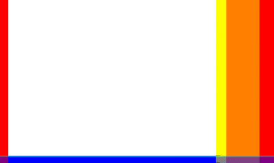

This image is a Pixel perfect representation of a 800x600 VGA screen, it shows the visible area in white, and the various sync and porches in other colors.
This image is based, again, on your notes. they said that the screen is offset by 8 pixels, since your horizontal counter is already divided by 4 it should mean the whole screen is offset by 32 actual pixels. which you can see here. the top left corner is where both counters are 0.
you may also notice 2 black lines near the bottom, those are the places where i would let the Video chip cause an Interrupt, or around that area atleast. if you have vector interrupt it would make this a lot easier.
one interrupt tells the CPU that a frame has just been finished, so the CPU should be able to write into the VRAM in rapid pace as the video chip itself no longer needs to access it.
and the other warns the CPU that it is about to start drawing the next frame so it should probably stop writting into VRAM.
anyways, interrupts are not really important at the time, but just food for thought for the future. :p
also in case you want the colors:

Some updates:
I've thrown in a ROM filled with random data to try out the shift register loading and shifting pixels. It sort of worked. I somehow assumed that the shift register would keep its output unchanged until the next clock pulse, but obviously, when it's being loaded it doesn't. This caused some vertical blank lines on the output, see attached. The shift register was shifting one pixel too early, and first pixel of every byte was too short, as the register had to be loaded. On the scope screenshot, the yellow trace is the shift/ld, and the dark blue trace is the output from the shift register. Bright blue is one of the data bits from the ROM I think.
I temporarily fixed it by delaying the shift/ld pulse with an RC network, and feeding the A input of the shift register to its own serial input. This reduces the with of said black lineas and extended the last pixel of each byte to fill them entirely. It works, but it is nothing more than a bodge.
Adding a flip-flop makes it work as I originally intended, so I think I'll add the extra IC. I've tried with another shift register acting as a flip-flop on a breadboard and it works flawlessly. Well, there is a bit of an extra pixel at the end of each line, but that shouldn't be too difficult to fix. See last photo.
I'll see if I can get the foreground and background colours working, so I don't have to rely on an external breadboard to attach the VGA cable. Then, it'll be time for RAM writes from the CPU.
