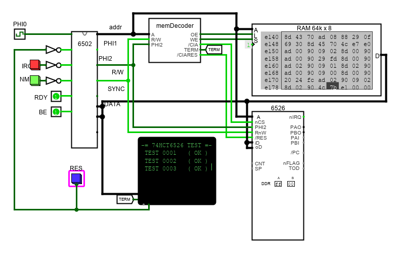

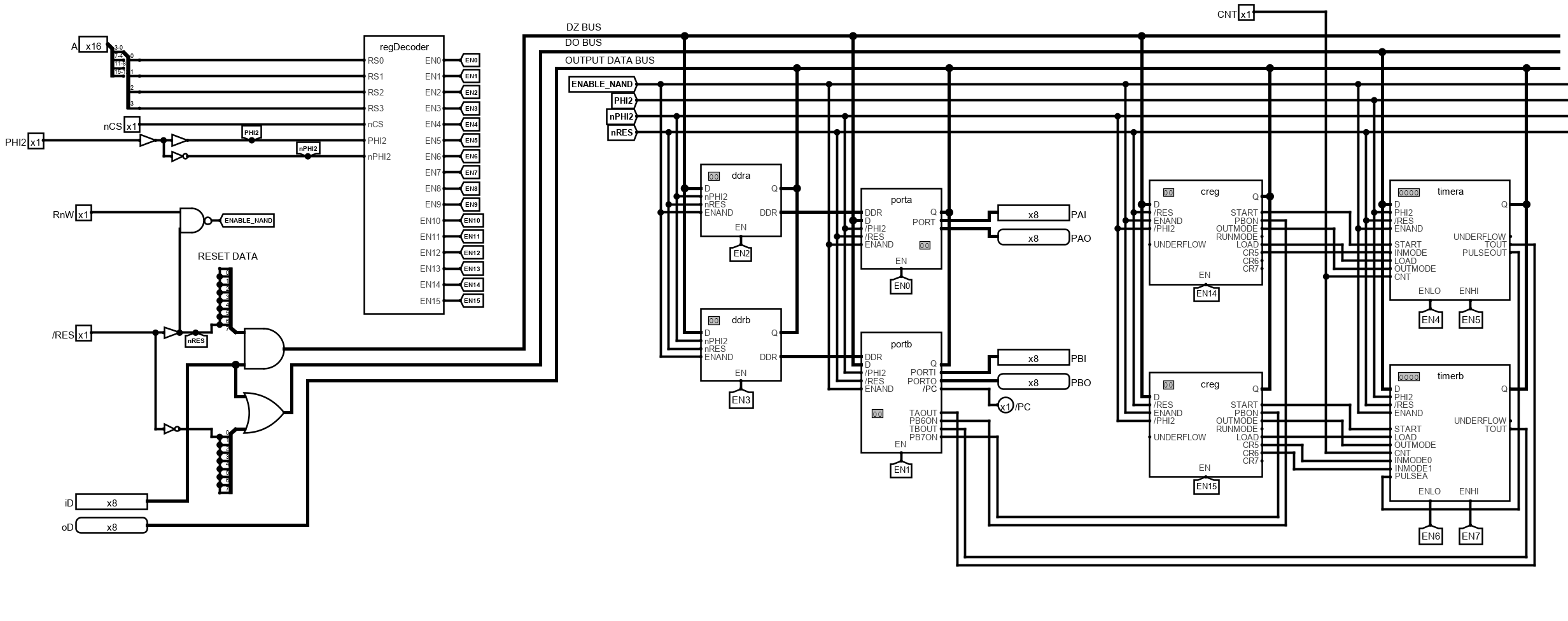

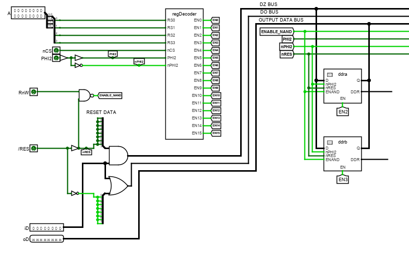

Definitely, as it is still unclear when I'll be able to properly setup my lab again, I decided to move to a virtual one. @Drass model of the 6502 in logisim has proven extremely useful
This is my first crude attempt at a 6526 in logisim. With both DDR modules implemented.
And this is the very same logisim6526 working with Drass CPU, running the same code I've been using until know for my SBC6526 with just very minor tweaks.
I plan to implement mu current design of ports, control registers and timers during this weekend. We'll see how they behave.
Cheers!

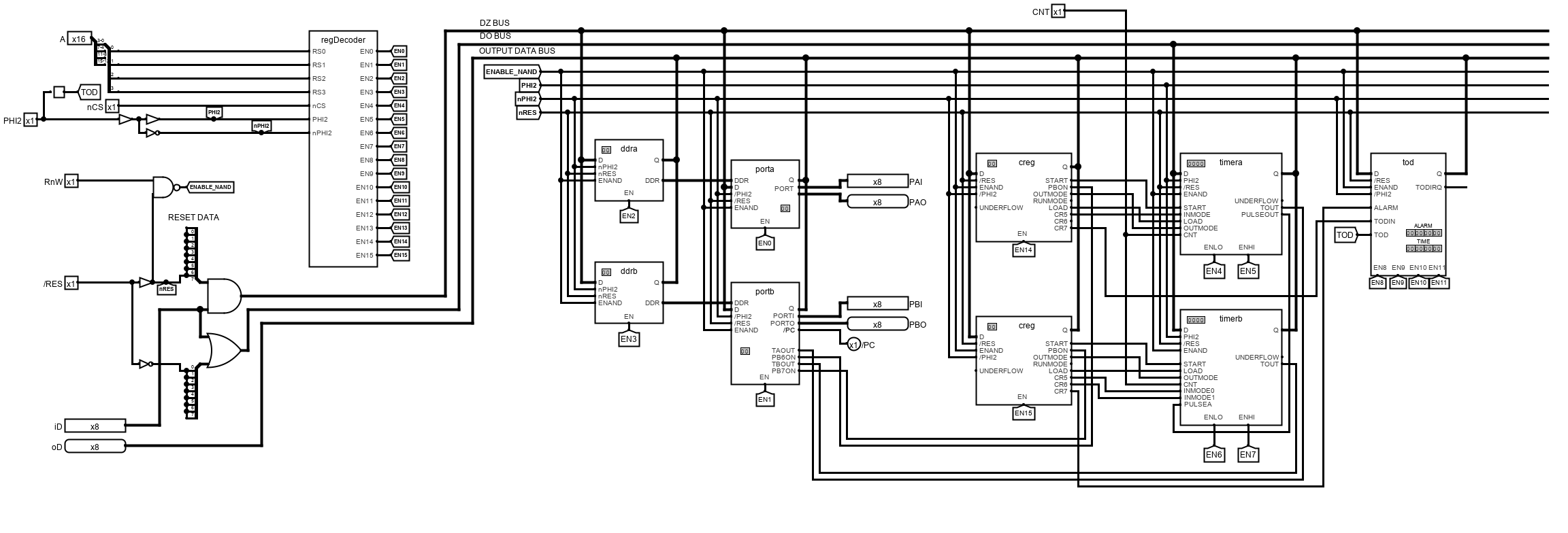

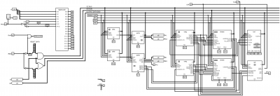

It took a bit longer than expected but..
DDR, PORT, CREG, and TIMERA. Done, and more importantly, working.
I have tested all the test cased I had... and they all work just as expected. I'm now coding a 6502 test suite for them, but it's quite reasuring so far.

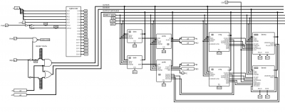

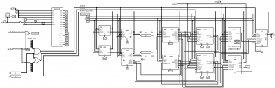

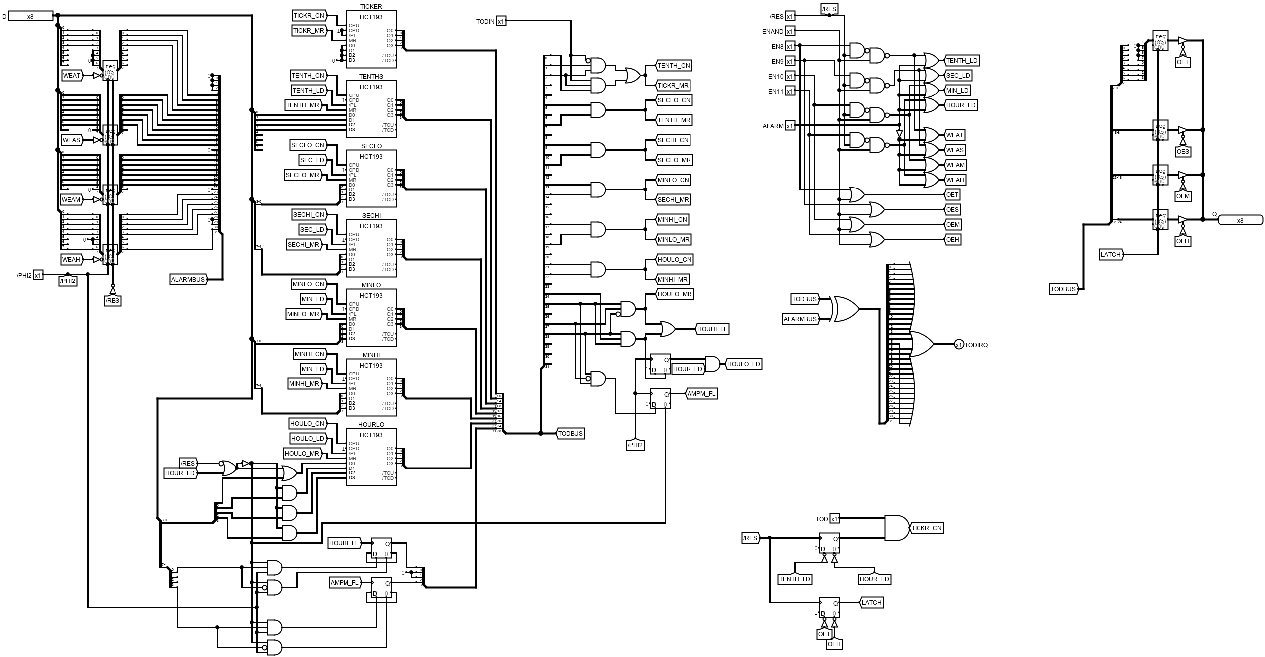

Please welcome the new member of the family:
We now have a working TOD! This is 4 registers more done, with now only SDR and ICR left.
I knew TOD was going to be massive... but wow!
With 4 registers for the alarm, 7 counters for the Time, plus half a dozen DFF for control, and the HH and PM bits... add 20 gates for the register write and read enable signals, and to compare the ALARM value with current TOD to trigger the interrupt... well... I'm looking at no less than 35 ICs in the 7400 implementation, making this the most dense board I'll have to face.
And this is not the whole story. My current implementation works pretty much the same as the original if you stay within valid values. For example:
On a real TOD. the Minutes low nibbled advances when, and only when, high nibble seconds goes from 5 to 6. I've implemented this detecting when bits 1 and 2 are set, so I will also flip the minutes at other values. Invalid time representations, yes, but no 100% accurate. For this I will need 4 input gates and a bunch of inverters. I haven't do the math... but this could take no less than 5 additional ICs.
I'll leave like this for now. This may only fail on some very specific cases where unorthodox TOD use exists.

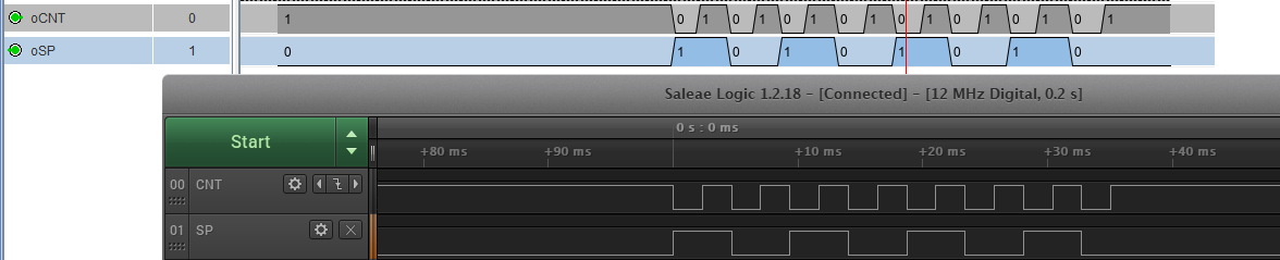

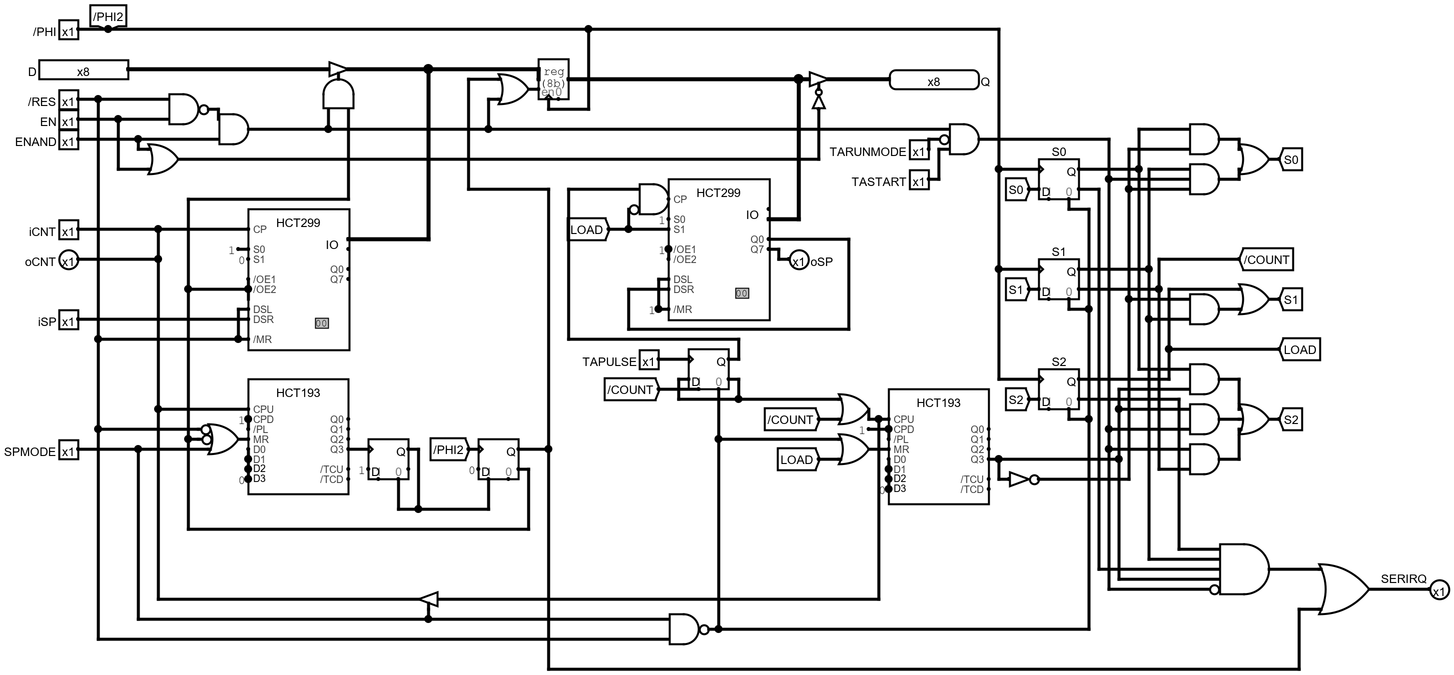

3 days, and SDR is almost done. I can shift in 8 bits and store the resultant byte on the SDR, I can write a byte to the SDR and it is sent via the SP pin as it should. An additional write to the SDR while it is sending results in the new byte being "enqueued" for sending, and any new writes, overwrittes the 1-byte queue.
I'm using a 74299 for the shift register, and a 74193 to keep track of how many bits have been sent/received. I've tried to used just one of them for the whole SDR but, I was having some issues, as the clock pulses do need to behave slightly... I ended up having two separate 299/193 pairs. One to handle the input mode, another for the output.
I still need to do some tweaks to some control signals, and I think I need to shift CNT phase a bit, in output mode.
As per the datasheet:
"Data shifted out becomes valid on the falling edge on CNT and remains valid until the next falling edge."
Right now, I do have data valid at the falling edge, but it changes on rising edge of CNT. Which is not correct.
On another subject. I'm facing a dilemma right now. Glue logic has been manageable until now. But with TOD and SDR.... yikes!
I'm considering using a GAL here. It will reduce my chip counts by a significant amount. (For TOD, from 30 to 24 ICs, for SDR, from 16 to 10 probably) but I do feel this is like cheating somehow :lol: . But I will probably stick with 74xx parts. Anyway, if I wanted to do this in an efficient way, I would've gone for the CPLD/FPGA from the very beggining right?

TOD is a couple of posts above. It has 4 mayor "logic" groups.
- On the lower right, a bunch of gates to control the Hours register, including the AM/PM Flag. Lot of transitions happen here at weird points. Like MSB of the Hours fliping when going from 12 to 01, and from 09 to 10. Then AM/PM flips on transition from 11 to 12, and any time 12 is written to the register.
- In the middle, another group controlling when all the registers advance, or reset. Most are a simple 2-input AND gate. Tenths has the TODIN input to complicate things (Control if we're on 50hz or 60hz). And of course, the HOUR register again.
- In the upper left corner, the register selection logic. 4 register enable inputs, together with the ALARM control signal to select OE on 4 registers, or WE on 8.
- And last but not least, the moster 32 bit XOR compare. I'm using a 32 bit here for convenience, but actually only 24 bits are important. The others are always 0. In real world implementation, this could be 3 74688 comparators.
Now with the SDR.
The bulk of gates is on the left. 3 DFF and a ton of gates to implement a sequential state machine. This handles the output behaviour of the serial register. This has 2 inputs: Regiter write and Shift End, and actually, 4 states.
- 000 Shift register idling. Not sending data, and no data to send in the register
- 100 We transition here on data write. The byte written into the register is transferred to the shift register.
- 010 Transition where from above on next PHI2 cycle. We start sending the byte, MSB first.
- If a new write is done before ending, we go to 011. We have a new byte waiting in the register. Move again to 100 when current byte has been sent. Reload the shift register again and continue transmiting
- From 010, is no new byte is written, jump back to idle, and trigger a interrupt in the transition.
Even though it's only 4 states, and it could be solved with only 2 bits for them, it needed bigger gates (3/4 inputs) for the transitions. This way, S2 and S1 conveniently match my control signals.
Everything else is simpler, with just gates to enable/disable the input and output parts of the circuit.
I'm only missing a few buffers to multiplex CNT and SP pins, as they are bidirectional. I still haven't figured bidirectional pins out in logisim.
It's probably been 20 years since I've done a sequential state machine. It works, which is nice milestone.
Schematic is a mess so far. I need to untangle it, very much.
If you really fell like taking a look at it, and need more details, just let me know.

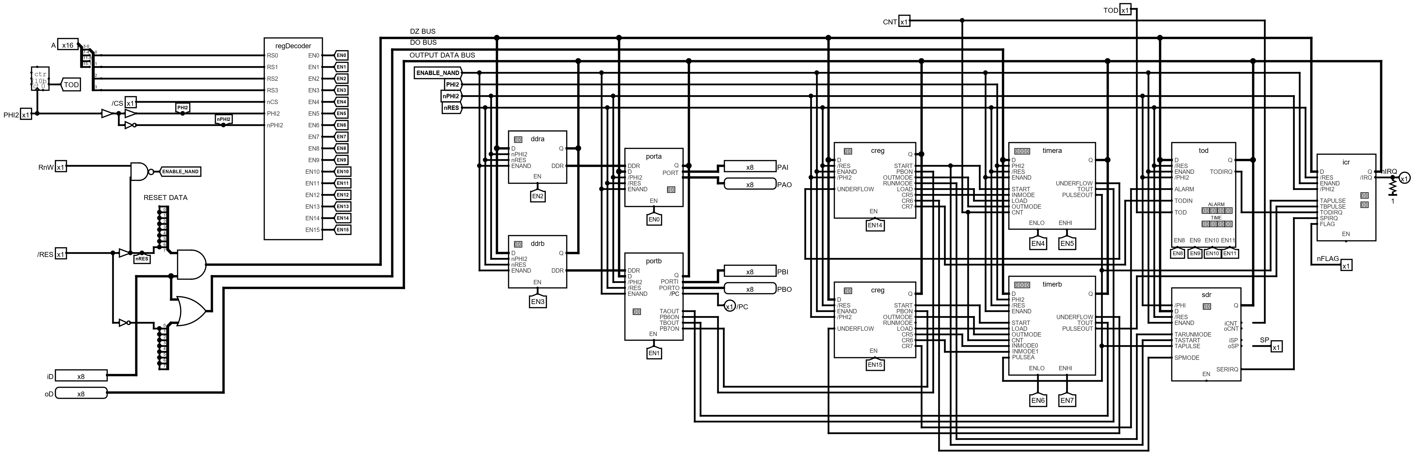

To close for today, the latest family photo:
Only ICR missing!

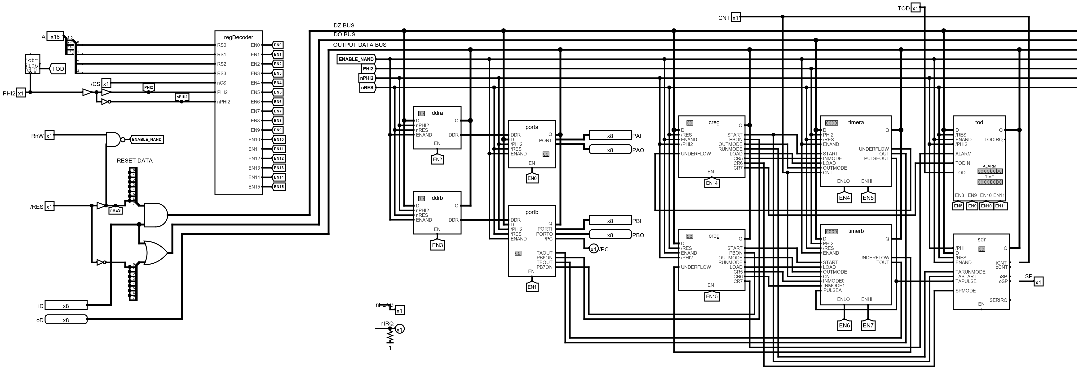

Oh wow, this was fast.

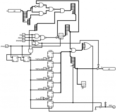

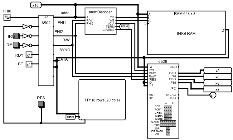

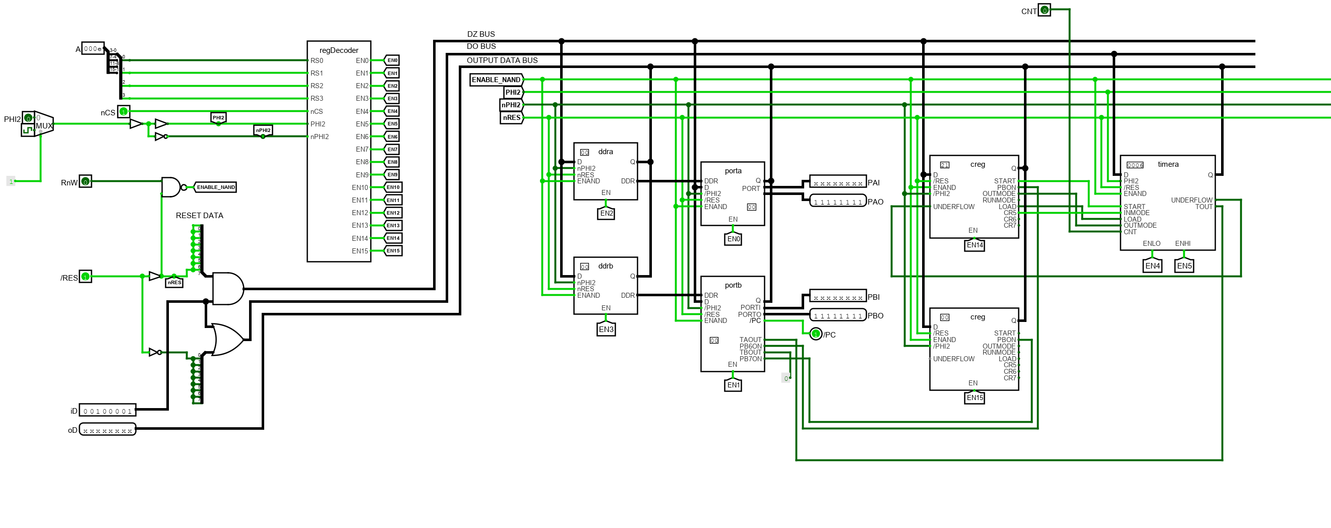

It took me about 2 hours to implement ICR. I had it drafted since like 1 year ago maybe. It turned out to work pretty well.
ICR:
The full 6526:
And how it looks inside my Logisim SBC:
I really do like how it looks with all the registers there... It actually gave me the idea of adding little 7 segment displays to the physical impementation showing the internal values. We'll see how that goes.
You may see there are still some unconnected pins in the SBC, and a couple inside the 6526 itself. There's plenty of stuff on my to-do list still!!
- Cleanup and tidy the LOGISIM implementation. Both inside the registers, and in the block diagram
- Complete the LOGISIM SBC so all pins are connected and can be tested
- Complete a full test suite. I will gather as much as I can from VICE test suite, and all other 6526 lying around
- Then, back to the real world! i'm working in parallel in a new version of my SBC. Besides fixing some first version issues, It will have two 6526 slots. In the first version, I could connect either a MOS6526 or my 74HCT6526. Also, all SBC core functions will be handled by the 6522. Right now, the 6526 drives the LCD, and as I'm resetting the 6526 all the time for the tests, it's messing up with the display.
- After all of this... time to finally break up with Eagle Cad, and recreate the LOGISIM6526, this time with KiCad
- And of course... order the pcbs, build the pcbs, test the pcbs, watch them fail, and repeat until success, or exhaustion :)
