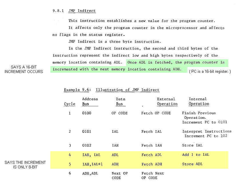

Posts: 3526
Re: 6502 redundant, missed, and suggested features
If a bug involves hardware it means there is some aspect of the hardware's behavior that doesn't follow published specifications.
If the published specifications were clear then that'd be a valid outlook. But even the original MOS specifications are not clear.
IMO, anyone who has a right-vs-wrong, black-and-white perspective on this debate is being blind to some important subtlety. Arguably litwr is guilty of this, but he's not alone.
The doc does and doesn't imply a page crossing. And, for the coders out there dealing with the reality of the silicon, cases have been illustrated for the desirablility and the undesirablility of a page crossing.
(FWIW, I become more and more receptive to the notion the ambiguity in the spec was intentional, as I suspect the company was reluctant to be 100% candid regarding errata in their yet-to-be-accepted new product. But the reason for the ambiguity doesn't affect my point above.)

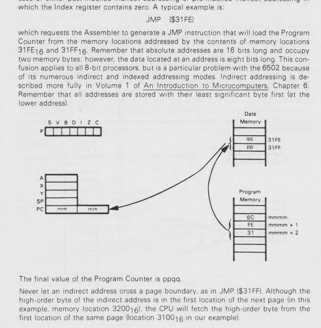

I've been trying to recall when I first run into the JMP ($xxFF) bug in a program that I had written. I do recall that the documentation that my employer in the 1970s was given when a prototype device was designed around the 6502 made no mention of the JMP ($xxFF) bug but did list the addressing mode in the detailed instruction description. That would have been in 1976, which was when I learned the 6502 assembly language. I do know I ran into the JMP ($xxFF) bug later on. The earliest I remember it being mentioned in any literature was in 1979 in 6502 Assembly Language Programming, by Lance A. Leventhal. My copy, which is the second edition that was published in 1986 (my original 1979 edition completely fell apart from much use) describes the problem on page 3-13. This same edition of that book also mentions that the JMP ($xxFF) bug was fixed in the 65C02.
Posts: 11464
Thanks BDD, that's very interesting - although we don't know exactly when Leventhal wrote the book published in 1979, there is usually a fair delay between writing and publishing, and evidently he was aware of the behaviour. (Edit: I see the book's references include one to an article from April 1979)
From page 63 of this PDF of the first edition, page 3-13 of the book:
1979 warning from Leventhal
Never let an indirect address cross a page boundary, as in JMP ($31FF). Although the high-order byte of the indirect address is in the first location of the next page (in this example, memory location 3200₁₆), the CPU will fetch the high-order byte from the first location of the same page (location 3100₁₆ in our example).
