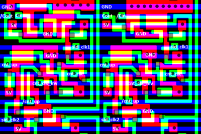

Now that we have a good overview we can dive into the details. Let's start from the core, the envelope counter, built as an 8 bit ripple counter with inverted odd bits.
This is the layout of two adjacent bits:
The even bits are comprised of an XOR logic, that sums the Carry in and the previous bit value, and an inverted XOR gate that inverts the output when counting downwards. The bit value gets inverted when the cnt_clk_inv is high, which happens when counting direction switches.
The carry output is calculated as following:
Cout = ¬(/Cin ∨ /bit_old)
The new bit value is obtained with this formula:
bit_new = ¬(Cout ∨ (/bit_old ∧ /Cin)) = /Cin + /bit_old
And the bit output is calculated as:
cnt_out = ¬((bit_new ∧ ¬cnt_up) ∨ (¬bit_new ∧ cnt_up)) = ¬(bit_new + cnt_up)
(bit_old is used in place of /bit_old when cnt_clk_inv is active)
For the odd bits the first XOR logic is inverted.
/Cout = ¬(Cin ∧ bit_old)
And the new bit value is obtained with this formula:
/bit_new = ¬(/Cout ∧ (bit_old ∨ Cin)) = ¬(Cin + bit_old)
/cnt_out = ¬((/bit_new ∧ ¬cnt_up) ∨ (¬/bit_new ∧ cnt_up)) = ¬(/bit_new + cnt_up)
(/bit_old is used in place of bit_old when cnt_clk_inv is active)
These tables summarize the bit logic:
Even:
/Cin|/bit_old|Cout|bit_new
  0 |    0   | 1  |   0
  0 |    1   | 0  |   1
  1 |    0   | 0  |   1
  1 |    1   | 0  |   0
cnt_up|bit_new|cnt_out
  0   |   0   |   1
  0   |   1   |   0
  1   |   0   |   0
  1   |   1   |   1
Odd:
Cin|bit_old|/Cout|/bit_new
 0 |   0   |  1  |    1
 0 |   1   |  1  |    0
 1 |   0   |  1  |    0
 1 |   1   |  0  |    1
cnt_up|/bit_new|/cnt_out
  0   |    0   |    1
  0   |    1   |    0
  1   |    0   |    0
  1   |    1   |    1
As expected the bit_new value is the sum of bit_old and the carry from the previous bit. The input carry for bit 0, active low, controls the counter clocking while the cnt_up signal controls the counter direction, inverting the output when low. The feedback loop is controlled by the cnt_clk signal except in the cycle when counting direction changes during which cnt_clk_inv is used to invert the bit values.

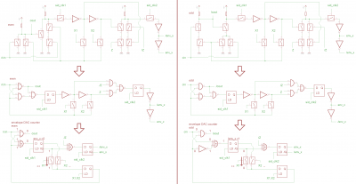

Envelope DAC counter.
Even bits: low_active carry input, counter bit is stored active high, high_active carry output.
Odd bits: high_active carry input, counter bit is stored active low, low_active carry output.
Note, that the counter really is an up\down counter,
but it usually counts up.
When the envelope DAC counter is "incrementing",
the counter usually counts up while the XOR gates fed by Z,/Z don't invert the counter outputs.
When the envelope DAC counter is "decrementing",
the counter usually counts up while the XOR gates fed by Z,/Z do invert the counter outputs,
what makes the counter that counts up just look like a counter that counts down...
And I'm sure that this will cause quite some confusion to some of our readers. :)
Looks like drfiemost has changed the notation of some of the signals.
IMHO the new signal names won't be too helpful for understanding the circuitry,
so I'm going to stick with the old notation I had in my envelope generator block diagram, sorry.
In my schematics above, X1 makes the counter count up, X2 makes the counter count down.
(X1 or X2 are active when sid_clk2 =1.)
Z=0, /Z=1 does not invert the counter outputs //up_counter looks like up_counter.
Z=1, /Z=0 does invert the counter outputs //up_counter looks like down_counter.

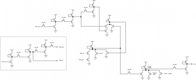

This is the circuit that generates these signals:
R0 and cnt_up reflects the counting_direction signal state with respectively one and two cycles delay.
The cnt_clk and cnt_clk_inv signals are derived through an XOR gate, that checks when counting_direction has changed from the previous clock cycle, and two NOR ports, that make one of the signals active during the sid_clk2 phase based on the XOR output. The result is that cnt_clk_inv is high only the cycle after counting_direction has changed.

The inverted and non_inverted outputs of the envelope DAC counter
are feeding 7 AND gates, which check for:
$00, $06, $0E, $1A, $36, $5D, $FF.
The outputs of two of those AND gates goes to the envelope\counter
control circuitry, detecting if the counter is $00 or $ff.
But those 7 AND gates also feed five RS flipflops through transparent
latches (transparent during sid_clk1 =1.)
Circuitry for one of those five RS flipflops:
During 'Decay phase' and 'Release phase', the outputs of those five RS flipflops
which are feeding the small PLA above the LSR5 counter cause a non_linear decrease
of the envelope DAC counter value by slowing down the DAC counter...
according to the value the DAC counter has at the outputs.
In my big block diagram, I had simplified things by drawing just one transparent register
between the RS flipflop outputs and the small PLA instead of 15 tiny registers, sorry. :)
The FPF output of those five RS flipflops is wired together with a pullup to +5V,
so if all five RS flipflops are cleared, FPF isn't tied to GND and thus '1',
what makes the envelope DAC counter run at a normal (not slowed down) speed
during 'Decay phase' and 'Release phase'.
BTW: not more than one of those five RS flipflops is supposed to be set.

Great work! I'll keep on posting my annotated layers and transistor schematics for reference.
Here is the input carry for bit 0 (the rest of the circuit is included in previous picture):
Again two cross-connected NOR gates forming an SR flip-flop which enables the counter when gate raises or on chip reset and disables it when the 0x00 signals triggers.
Another NOR gate controls the clocking of the counter when it's active based on the release_reset and count=sustain signals.
The counter_enabled label is a bit misleading but I've left it untouched from the original layouts, sorry for the laziness.
One interesting "feature" of this logic is that when the counter is locked at $00, by switching on the gate and then turning it off before the counter is clocked again the envelope will count down wrapping to $ff until it gets back to $00.
A similar trick, in the opposite direction, can be achieved when counter is at $ff.
