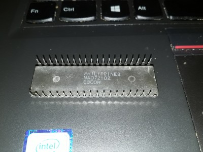

@socram, I think it would be best to double check your conclusion, just in case something else is causing your program to fail. How about trying the following? This should loop even on an NMOS CPU.
cheers
start:
CLC
BCC start
BRK
cheers
start:
CLC
BCC start
BRK
START
A:0007 D:EA R
A:8007 D:00 R SYNC
A:8007 D:00 R
A:0007 D:EA R
A:0006 D:EA R
A:0005 D:EA R
A:8004 D:00 R
A:8005 D:00 R
A:0000 D:18 R SYNC
A:0001 D:90 R
A:0001 D:90 R SYNC
A:0002 D:FE R
A:0003 D:00 R

(note only A15 and A2 to A0 are connected, thus 8004 above is RESET vector fetch)
They come from this seller: https://www.ebay.es/itm/-/171727464113

Alright, that is the behavior we expect. :) It certainly looks as if it's an NMOS 6502 you've got.
Is there any reason you can't use one of your CMD 65C02's instead? Really the NMOS CPU's have almost no advantage, unless you need to run programs that rely on NMOS behavior for the undefined opcodes.

From adeleparts2010? That's supposed to be an OK ebay seller. I'll be more cautious about what I buy from them in the future.
Please please give them a 100% negative feedback response. That's the only way that can get to them.
