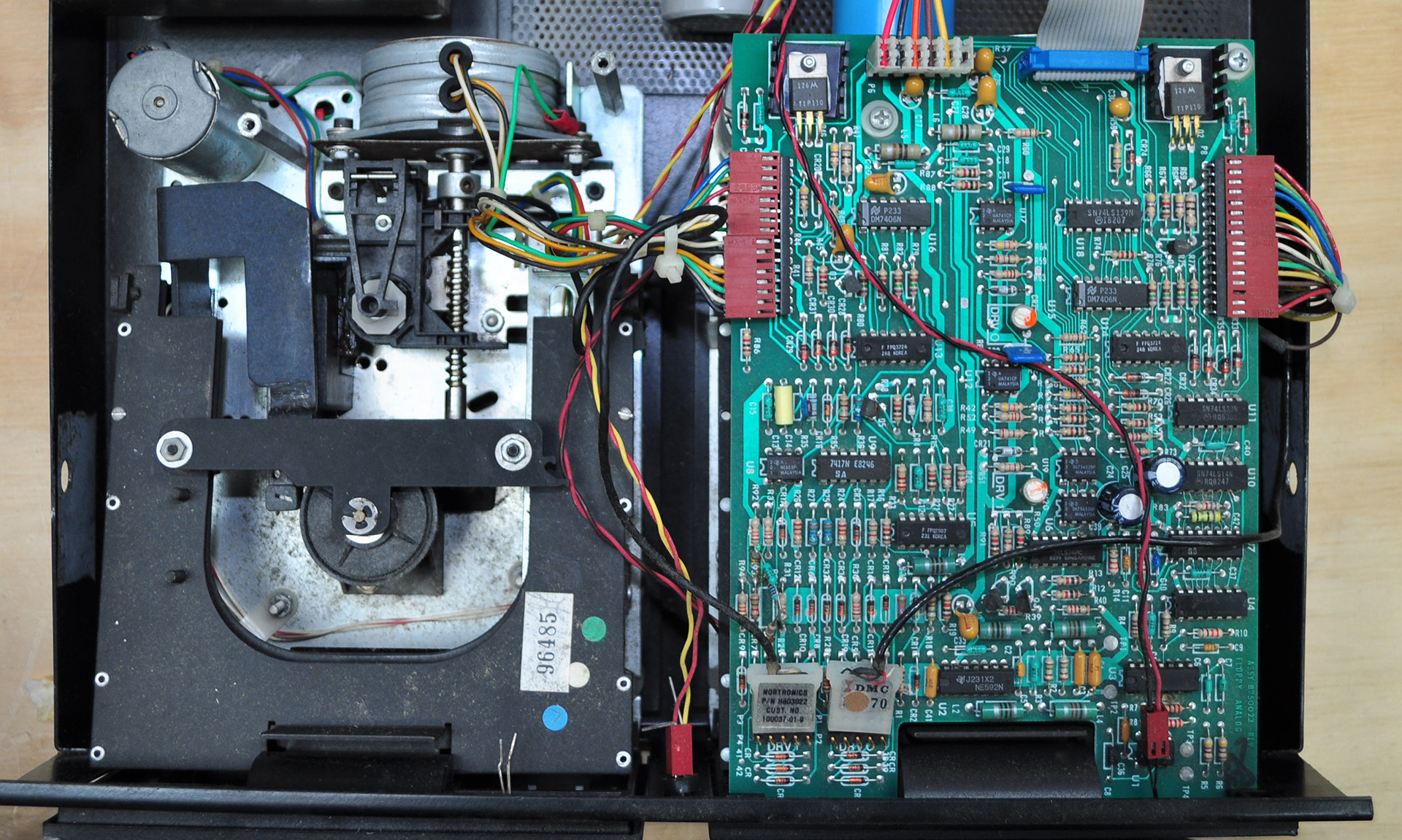

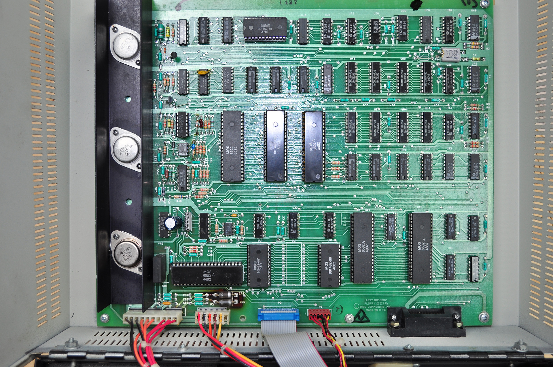

Random musing...
I wonder if I could bypass the huge mainboard in the 8050 disk drive and just interface directly to the Micropolis 1006 drive?
The Commodore 8050 mainboard includes dual 6502s and is basically a fully working computer by itself.
In my system, I don't need so much complexity, just a simple stream of data. I could even do without DOS altogether.
With a catalog of samples on another disk, I would only need to know the start and end sectors on the disk for each sample.
Such a scheme may be much faster and actually hold a lot more data.
This idea comes from reading over what WOZ did with the original Apple floppy. Genius actually.
Here are the Micropolis drives. Two drives share the single controller, which does step drive and head decoding...
Here is the 6502 computer inside the drive that allows the drive to act as an independent computer basically...
There are no black magic analog components on the mainboard, just basic digital, so I think I can do the same thing with my own mainboard.
All samples will be basic streams between 100k and 512k for the most part, so I really don't need all of this DOS complexity.
I will be giving this some serious thought and might do some tests this winter.
Brad

Just think how much smaller that board would be with the use of modern PCB design methods and fabrication techniques.
If it were me, I’d consider retaining the DOS capabilities. OS development for your unit would be much simpler when it comes to mass storage, and an IEEE-488 interface is not hard to rig up. I know you like working at or near the bare metal, as do I (my POC units are as bare metal as they come). Given the amount of work that is and will be required to bring your project to completion, I’d be thinking about the not-insignificant amount of time that would go into creating a roll-your-own disk controller from scratch, and then developing the firmware needed to run it. That is not a trivial engineering matter by any measure, especially when it comes to the timing requirements of interfacing to a floppy drive mechanism that has zero intelligence.

I 100% agree with everything you just said!!
But... I will dive off a cliff before I consider using any modern tech to spoil this pure design.
No CPLD, no microcontrollers, no LSI at all.
I will also not allow any work to be done outside my extremely limited shop no matter how much time and effort it would save me.
No way, never. I will drop this entire project in the recycle bin if I can't to it all 100% by myself using age appropriate tech.
You are not speaking to a normal person here... so the only logic that works is the 7400 on my breadboard!
I should have waited to post actually.
I have already found it quite trivial to read the binary stream right form the drive and control both the steppers and spindle motor.
Seems the Micropolis board already does most of the heavy lifting. It's all digital in and out!
Right now, I have the drive acting much like the VIC-20 dataset would.
This fits my original design ideas much better actually.
I wanted to have a file on the main OS disk called "Catalog.bin".
In this file will be basically the simple index to the disk number and locations of samples.
How it works is simple and fast...
In the OS when it comes time to loads samples into a channel RAM, the OS will read Catalog.bin.
At that point, the OS will prompt... "Insert Disk Number 013 and press Enter".
The controller will then know to just stream direct from a certain sector range.
Fast and easy.
As samples are added or deleted, the OS will update the catalog.
No need for any file system on the actual disk, so more room for data.
I will do more work on this soon, but already have the disk spinning and showing binary streams.

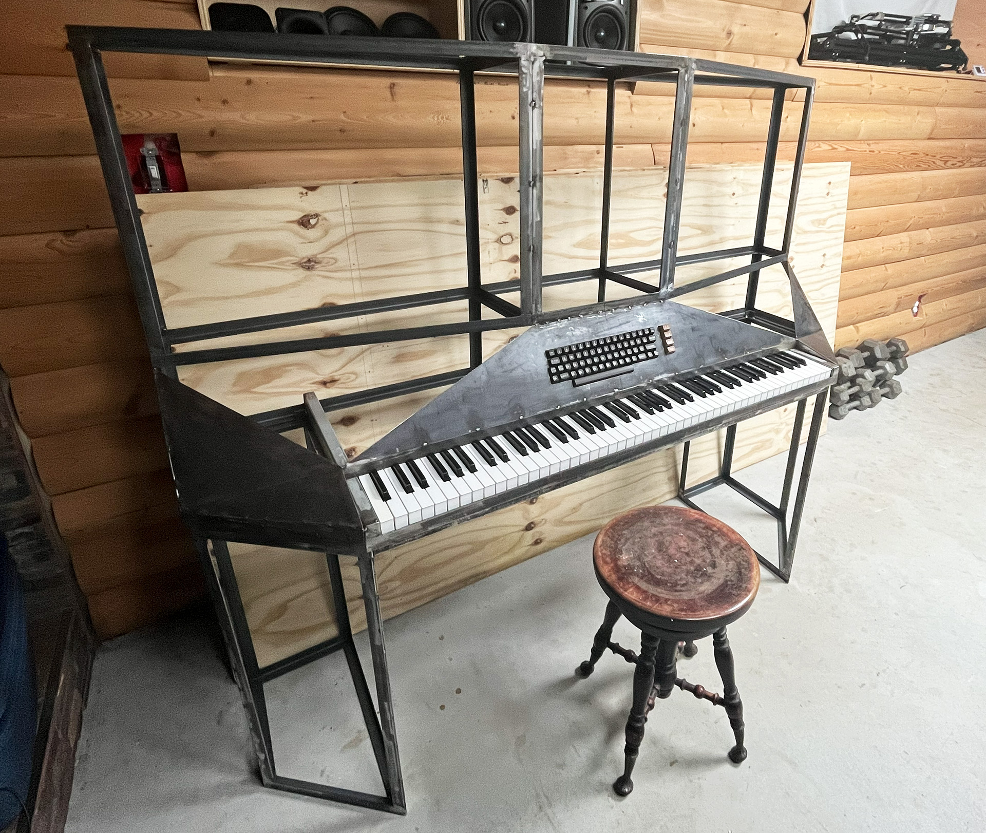

We went from green grass to 4 inches of snow over the last 2 days so I finally brought the Synth into the house.
I am far enough along to take inspiration from the frame and can clamp some scrap plywood on the front to mount the CRT.
Final design of the digital channels and the start of the analog filters section will now commence.
Getting the frame indoors was quite a challenge actually. I feel like I just did a full body workout.
My welding shack is about 2000 feet from the house down a very steep hill, now covered in snow.
The small cherry trees along the trail are not so small now, so I was banging through the bush with this beast.
Up hill, in the dark, through the bush in the cold... just like your grandpa used to get to school.
Oh, and I have a tall house, so it's 15 stairs up and then 15 stairs back to the basement.
I tried hammering out some 80's synthwave tonight, but only got silence.
Maybe I am too tired.... or maybe I need a circuit board with 1200 ICs first.

Exactly the same footprint except that this is 10 inches wider.
Looks good along with my 1890's piano stool. Will have to refinish it now.

I can see why. Damned thing’s as big as an old-fashioned upright piano.
Re: Vulcan-74 - A 6502 Powered Retro MegaProject
Getting a nice feeling for the size of the beast now.
