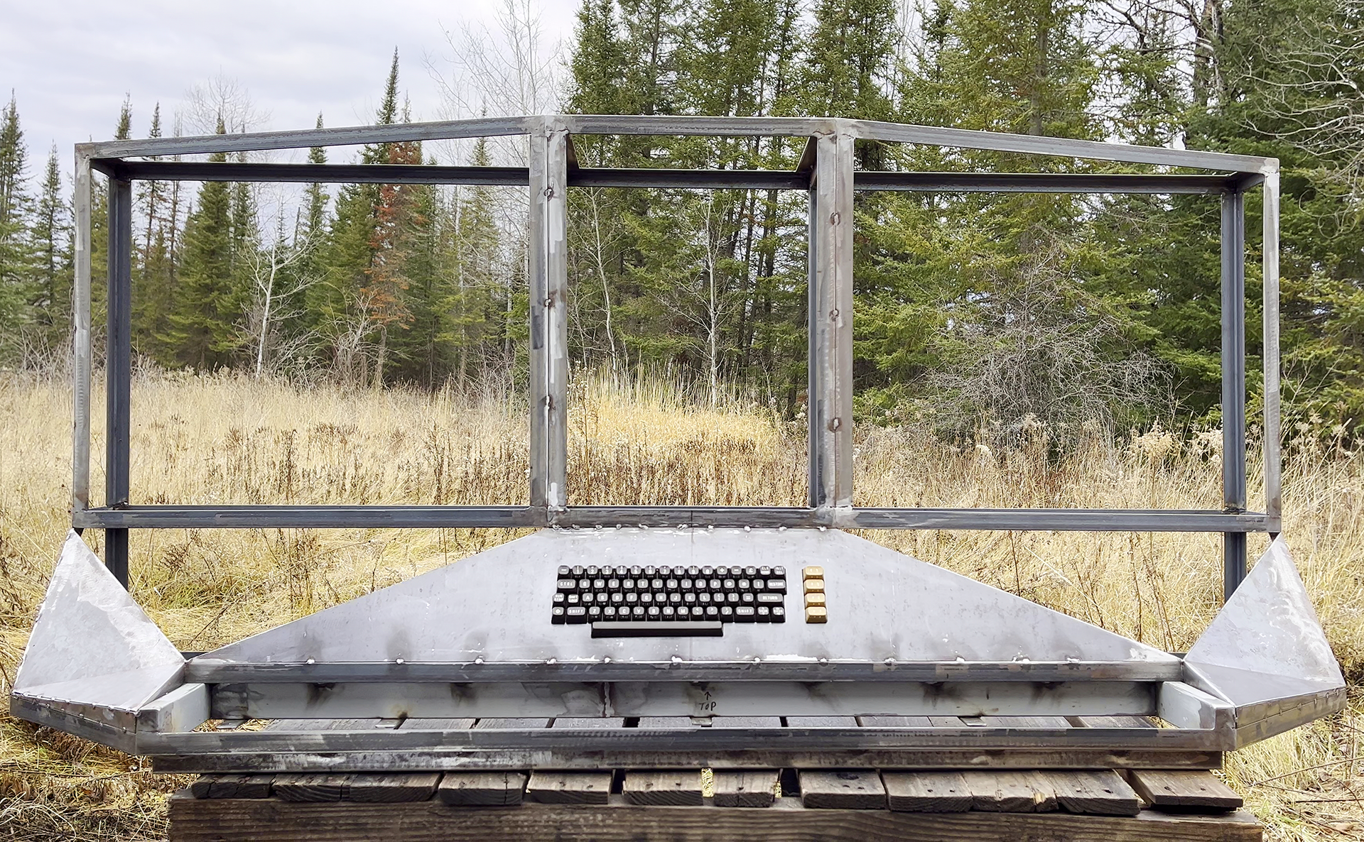

I played around with the color scheme a bit on the model and like where it went.
The look should scream out... stuck in the 70's but trying out the 80's.
Cleaned up the detail on the working keyboard as well.
Only the knobs and switches are undefined at this point.
The two large ones beside the piano keyboard are probably a go.
These are expression encoders that can be assigned to just about anything from pitch bend to low pass resonance.
I don't like the typical pitch wheels on keyboards, so I am going rotary with mine.
Going to try cutting the working keyboard cutout tomorrow if it isn't too cold outside.
So close to moving everything indoors for the year so I can dig into the circuitry.
The way electronic music is created is going to change forever in 1980 when this powerhouse is released!
Radical Brad

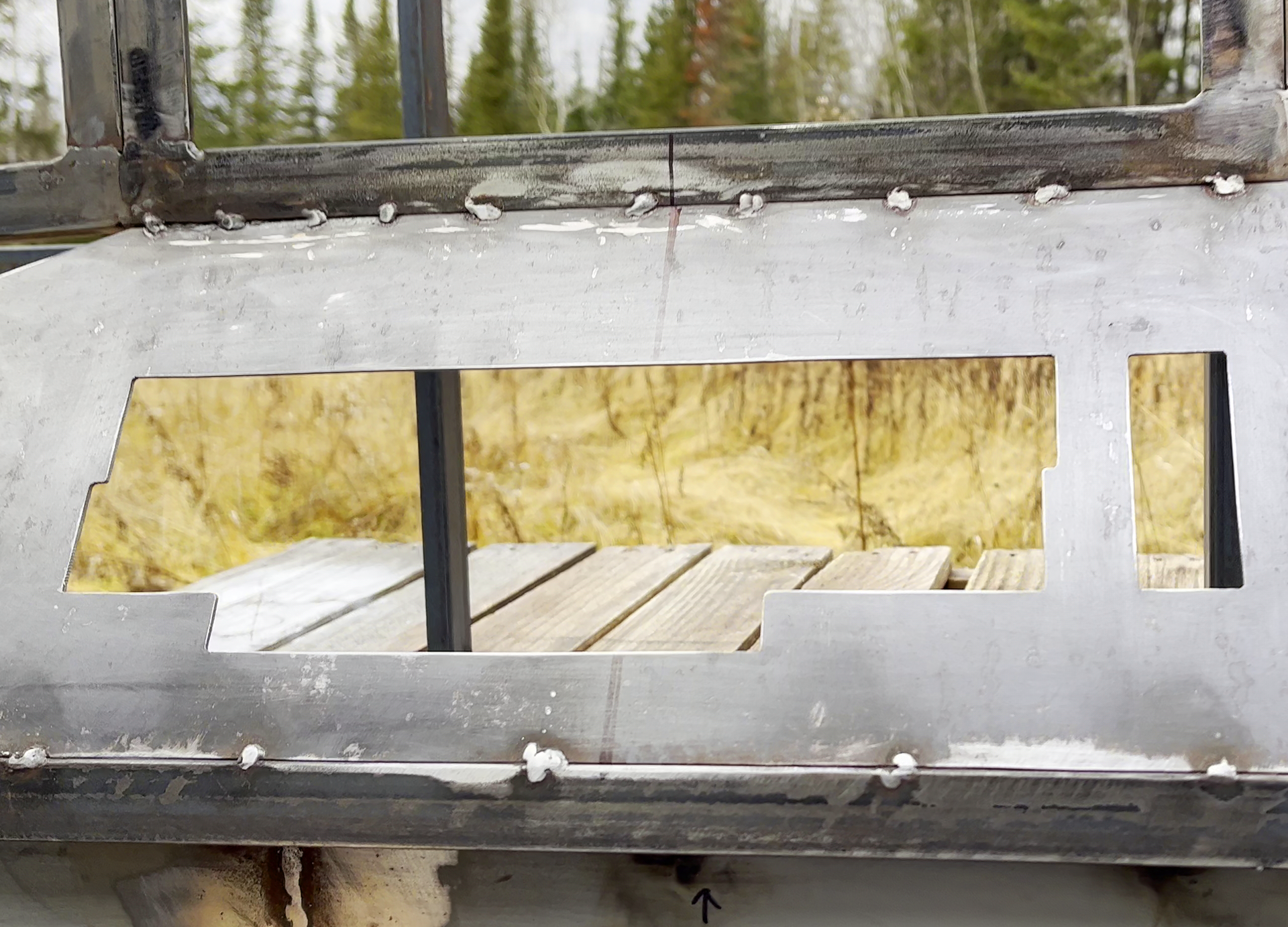

The rain held off this afternoon, so I attacked the front plate with my ultra high precision cutter.
I used the paper template to trace the cut line, and kept a bit inside the line.
Always better to take too little than too much material away on the first cut.
Another space-age precision tool was used to clean up the grinder cuts.
After 2 hours of good arm workout, I had something that fit nicely.
Will need a few small lengths of flat bar to make a keyboard mount, but that will be easy.
It looks like a lot of empty space back here, but the speaker boxes are going to take up much of that room.
There will be enough room for a power supply, the 200 watt audio amp and a few extras like the spring reverb unit.
Another small part completed thanks to a mild snow free El-Nino winter up here in the North.
Next I will make the keyboard attachment points and might even have time to do the speaker plate borders.
Brad
