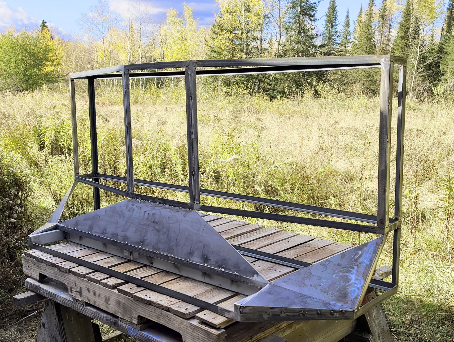

Had a few more hours outside in the back 40 and managed to get the side plates installed.
These were the most difficult parts of the build due to the compound angles and fold in the center.

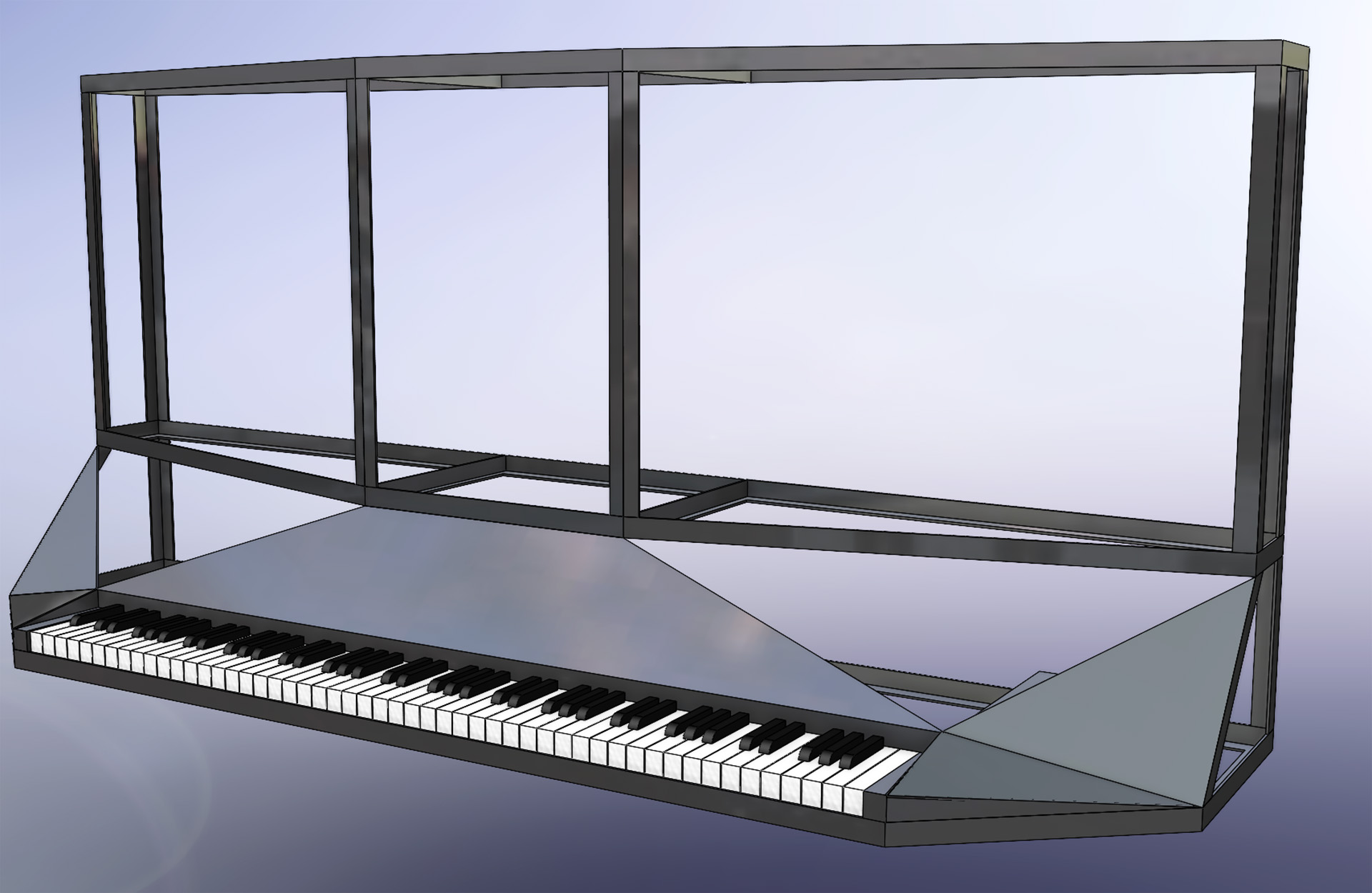

I am only using the 3D model as a reference, so I made a template from paper and cut it until it fit.
From there, I traced the template and hacked out the sheet with a grinder cutting disc.
The fold was made by running the cutting disc partway through the back along the fold line and then bending the plates.
Here is what I have now...
Since I am updating the 3D model AFTER I build something (strange, right?), here it is now...
Next will be the speaker grill inserts and then the brackets to hold the 12" CRT display.
If the weather holds off I might even get the legs done as well so it can roll around my indoor hacking lab this winter.
Final welding cleanup and body fill work will happen next year.
Later!
Radical Brad
