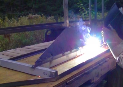

Wow, it has been 6 years since I did any real form of accurate welding, but it came back to me after a while.
Last thing I built with any real precision was my electric tractor, and that was in 2018.
I had half a day to spend in the old shack out back and managed to get the entire top segment of the frame together.
Welds are not complete or smoothed out yet, but it makes the project feel real to finally see it come together.

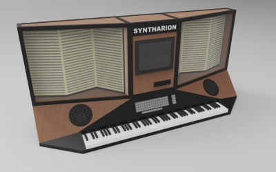

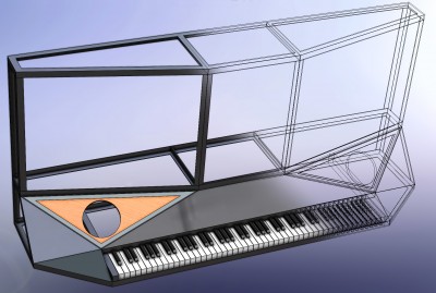

Here is what I am aiming for....

A few stills from the many videos I took today...
It probably took more time to get all of the action shots than to actually cut and weld the frame.
I am making a very detailed video series of this build later, so there can never be enough video.
Even made a head mounted iphone holder so I can do POV welding and grinding.

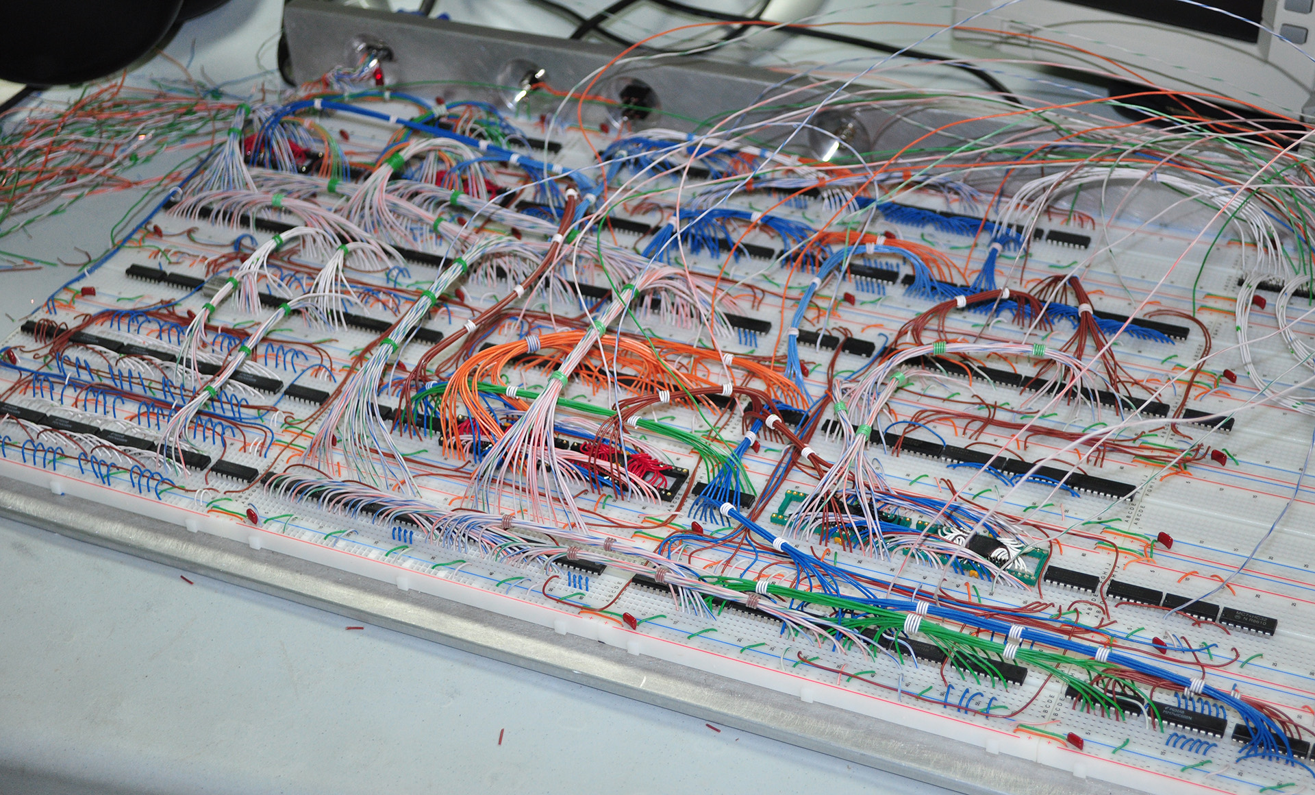

I don't want to give up the enjoyment I will get from hand soldering 16000 wires to 1000 ICs.
I get great rewards from these seemingly huge tasks for some reason.
Similar to how I walk deep into the back 40 and cut 10 cords of wood every year for for heating the house.
It may seem like a daunting task, but each day a bit more gets done and by fall, the woodshed is full.
Very rewarding!
I don't think the P2P wiring will be all that difficult really. Since each channel is identical, I basically just need to hand wire this 12 times...
I am going to use the same CAT-5 wiring I use on by breadboards as well.

There are times when I wish my cross-wired brain could take the path more travelled, but after 55 years I realize that it will never happen!
Hell, if I could mine the silicon and smelt the metal myself I would probably make the ICs too.
No way I am going to let some machine in China make my boards.... hand wired or death!
To me this kind of hard core prototyping is a true work of art, and I want my Synth to give off this aura as well...

Some adjustments to the base frame and front plating.
I like this better, plus the 1x2 square tube will make a great mounting point for the removeable caster/legs, putting the load on the strongest part of the frame.

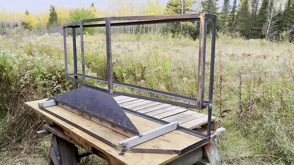

The trees are shedding their leaves and the sun is setting at 7:30 now so I am in a hurry to get the basic frame done before the snow hits the ground.
I am not worrying about the final weld and grind work, just the basic frame with all bars and plates installed.
If I have the skeleton sitting inside all winter, it will be motivation for all that wiring that is coming soon.
Started by framing in the keyboard with the 1x2 square tubing.
This will allow an attach point for the stand as well as ensuring that there is no flex in the frame around the keyboard.
Cutting the front plate. This will join the top and bottom parts of the frame and is the place where the VIC-20 keyboard & mixer controls live.
I will cut the keyboard access later once I can bring the frame indoors for fine dremel cutting.
Welding the front plate to the top and bottom half of the frame. It was starting to rain, so I put it into overdrive tonight.
Here is the frame now. Still needs the speaker grill plates and side plates, but almost completed.
It is actually not as heavy as I figure it would be, bust is still not your average plastic synthesizer frame!
Made a small adjustment to the front of the frame where the keyboard edge meets the front corner.
If the weather holds up, then perhaps I will get the other smaller plates installed this weekend.

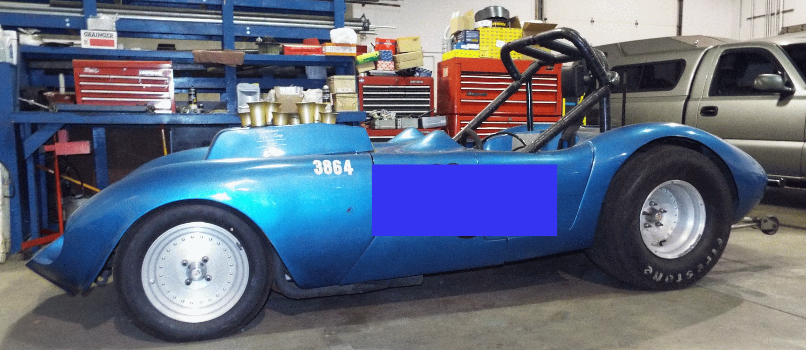

I made a vow (in 1998 when I started AZ / ChopZone) never to own any metal working tools besides an angle grinder, hand drill and basic AC buzzbox.
All 43 vehicles on my site were made using only those tools, so anyone can do what I do.
I live for doing the most complex things I can using the most basic tools possible... not sure why, but I really enjoy it!

My main concern has always been the time required to get something done.  I built most of my first race car’s chassis with a buzz box, and basic tools to cut and fit steel.  However, it was a very time-consuming process to get things right—about three years from when I started to when the car made its first run.
So when I decided to build the next car—which was expected to go a *lot* faster than the first one, I thought about the problems of building a frame that was square, straight and strong.  I also thought about the importance of having a roll cage that could withstand a high-speed crash.  A tertiary thought was about how much time would be involved with all the cutting, fitting and welding, especially when my job had me constantly on the road.
All considered, I decided being proud of being able to build a race car using basic tools wasn’t nearly as important as being able to build a car that would perform, be survivable in a crash, and not require a huge amount of time to complete.  Those factors led to me acquiring better tools, especially the MIG welder.  The build took about two years, start to finish, despite being significantly more complicated than its predecessor.  I credit a lot of that to having better tools at my disposal, as well as some experience gained from the first build.
