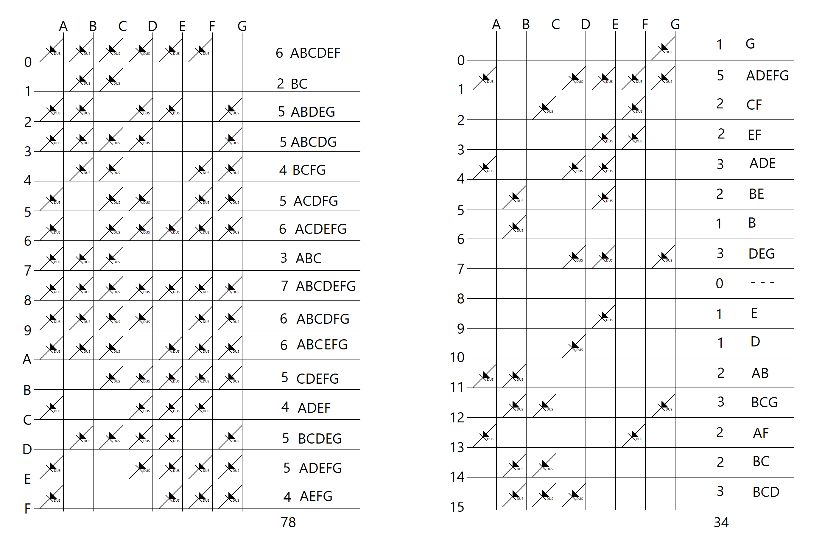

I'm not sure if something could be done with the diodes to split into two halves, as it were...
I did make a suggestion in this regard (shown again above), but I'll admit my diagram relies on the viewer's imagination. Broadly speaking, a row of decoders (I drew only one decoder) would run horizontally across most of the width of the board. Above the decoder row, and occupying the same width, would be the connection matrix for one nibble, and below the decoder row would be the connection matrix for the other nibble.
Each of the 16 outputs of each decoder needs to route to a diode-array, which in turn feeds upward to one matrix and downward to the other. That's what the diagram is intended to convey, although I've put the diode in a really silly spot, and I'm sure you can do better. The final result might be fairly "busy," with traces running up and down from the diode arrays. But, as you say, space is available (and the board does have two sides :) ).

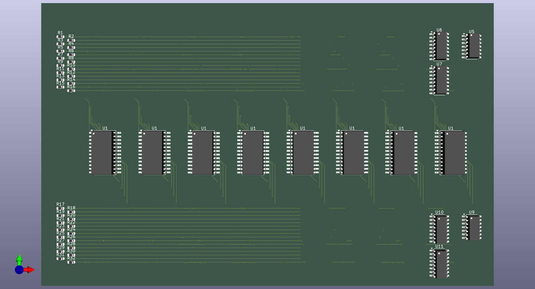

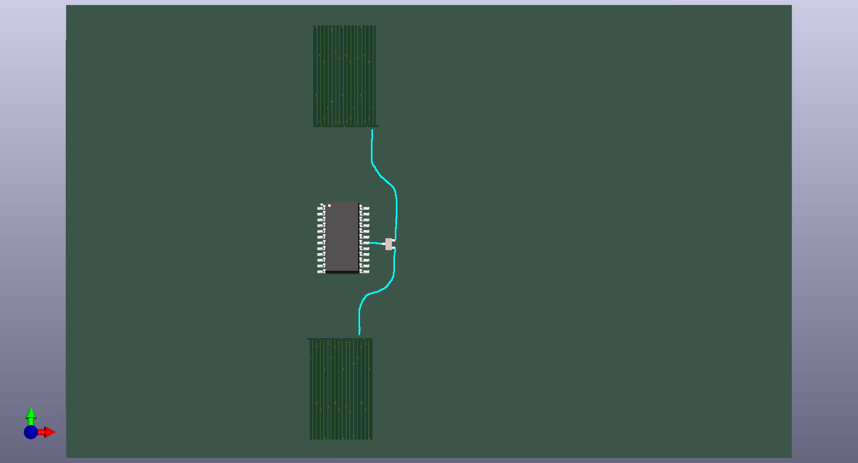

The other side is probably the best place for the diodes; that way there's only one via _to_ them and their columns can go up and down on the back, as with the muxer design. Lemme have a thunk.
Thing to bear in mind: with the 16-4 bit converter, each column is attached to one and only one row. As it's a ROM, we don't actually have to follow the layout; many of the muxer pins (and/or '154 pins) are attached to each other and don't need to go to the nibble rows, except for one...
My design rules: it has to fit on 100x160 board, double sided, use nothing smaller than SOIC pin spacing (in general) and use an 0.2mm (8 thou) for tracks and clearances; 0.6mm vias with 0.3mm holes.

Can I suggest you omit these fills? I mean all fifteen of 'em between the bit lines, and the same in the other section. They make the actual bit lines harder to see, and -- more importantly -- harder to cut...
Aside from what Jeff is saying, there is no benefit to be had with using fills in digital work, except possibly as a radiation mitigation method.  If anything, fills add parasitic capacitance to the assembly, which you certainly don’t want if you expect stable operation at anything faster than a 1970s-era pocket calculator.

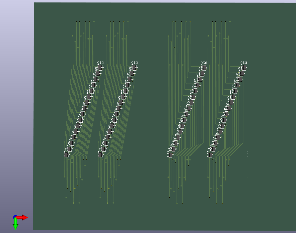

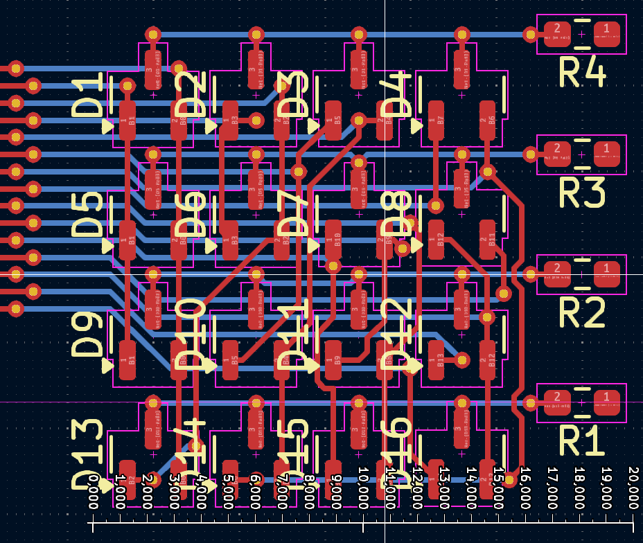

Jeff's idea about using double diodes looks as if it might work, but it's a messy board; even with SOT323 (smaller than SOT23-3) the overall width of a block of 16 bytes is somewhat wider than that possible with a SOIC-24W package. That said, it looks as with a bit of creativity, it might work. Move the pullup resistors up/down and shift everything left a little; there are still three chips and a 20-pin header to get on the board.
And the back:
(A lot of cut and paste on there, just to see how things fit).

And, just a reminder, the preliminary nibble encoder layout you posted here could be shrunk significantly if two-diode arrays were used.
Probably you're already thinking along these lines, but FWIW the left side of the image below suggests a space-saving pattern that cozies up more closely to its neighbours. :)

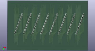

Your space saving squish has been considered, but for user clarity I would prefer to keep the same nibbles vertically aligned... though of course it's not actually necessary and indeed one could do point-to-point throughout.
But I think on aesthetic grounds, I think I'd rather have all the parts on one side :mrgreen:

Hmm...

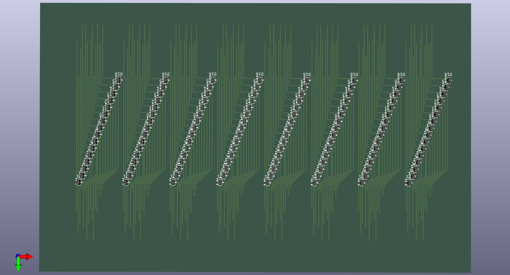

Using SOT23 double diodes, for ease of construction; it would be smaller with SOT323 packages but I suspect we could live with 20mm square for each nibble. The select lines (select low) come in from the left, sel0 at the top and sel15 not attached anywhere.

Inverting the Matrix aka Turning Logic on it's Head
Post by L0uis.m »
OK, an other idea.
I had a similar problem with a diode matrix I designed, and was able to reduce the anmount of diodes to less than half of the original design (thereby also reducing the overall current), just by turning logic on it's head (see tables below).
Instead of placing diodes representing ON state <br />I placed them representing OFF state, reducing the amount by more than 56%❗
Gr :D :D tings, Louis
May your wires be long and your nerves be strong !
