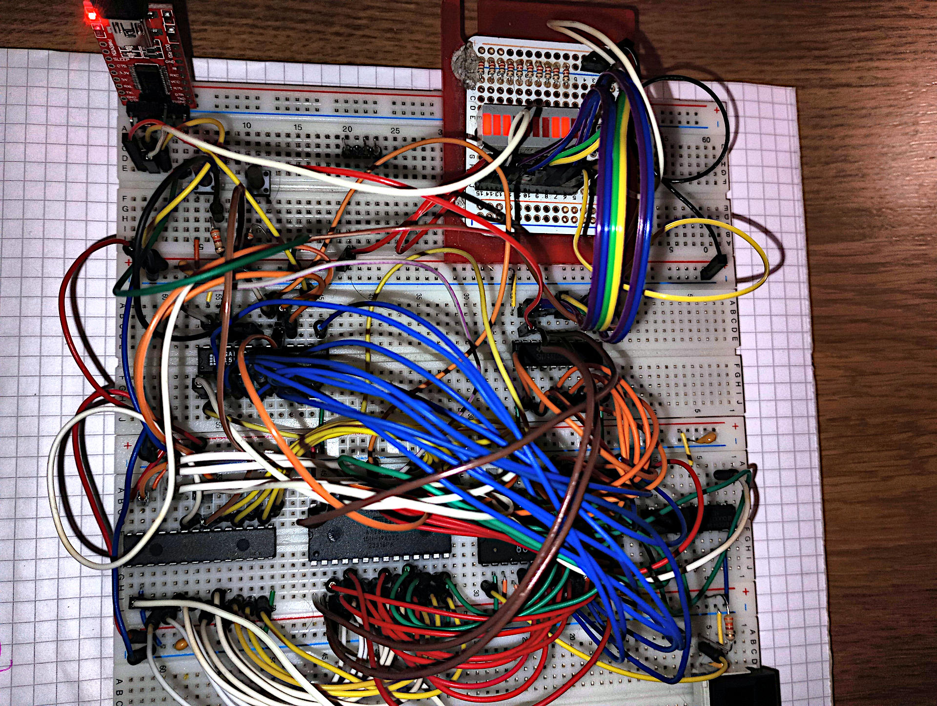

Garth, I have/had a LCD on my first build as I was following Ben Eater's videos. I haven't found it of any further use once I had serial capability. Thus, I don't plan to incorporate it into this current build.
A cursory summation of the ICs' current draw (based on my reading of the datasheets!) and assuming an operating frequency of 8MHz is coming out around 255 mA.
However, that doesn't take into account the work the VIA(s) may do in driving pins. Also, I haven't got a solution for serial comms yet. I was thinking of using Port A of the VIA to interface to a Nano that would supply power to the system as well as connecting to my PC.

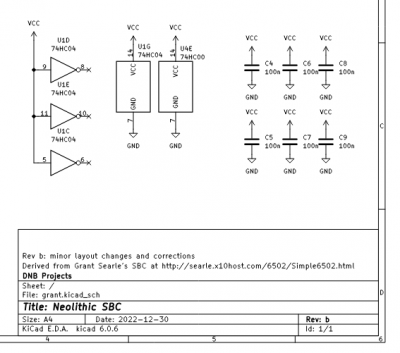

Right. I've had a go at the schematic. I've not done many and certainly never one this big before so, all-in-all, it'll probably be a little "rougher" than ones you're used to seeing.
Please feel free to comment on schematic drafting recommendations/tips as well as the substance of the design itself.

Decoupling capacitors between the power and ground, close to each chip? They don't need to be close on the diagram, but they do need to be there so they end up on the PCB, and they do need to be close there.
How do you do this on the schematic? I have seen quite a few where the decoupling capacitors are "floating" on the schematic, not close to anything. I don't understand how they are associated with the Vcc, say, of one of the ICs. Attached is an example from a more professionally done schematic - the Grant Searle Neolithic SBC (which is earlier in this thread). How do C4-C9 become associated with the various ICs? Or are they not - do we have to do that ourselves when laying out the PCB?
Re: Let's start at the very beginning...
See the first schematic near the top of the "Circuits Potpourri" page of the 6502 Primer.  In the bottom-right corner, you'll see the bypass capacitors, and next to each one it says, "at U1," "at U2," "at U3"...
Yes.

I'll generally _try_ and match capacitor numbers to IC numbers, and _usually_ mark the capacitor block as 'close to IC power pins' (though I forgot on that occasion. So IC1 gets C1, and IC2 gets C2... you get the idea. It breaks down a bit when you include something like an STM32Lxxxx microcontroller, which requires _nine_ capacitors if I recall correctly; in that case I'll often mark the capacitors actually attached to the power pins on the part.
But they are not optional; they've got to be there.
