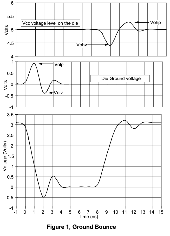

Once you know what an inductor does and what a capacitor does, AC analysis is initially a lot like DC analysis, except with complex numbers. Complex just means they go on a graph instead of a number line.For me it feels like there is more to it that matters to both my desire to understand radio and my interest in understanding crosstalk. Since every wire has some inductance and every signal path plus return path has some capacitance, it seems as though every trace in a PCB or wire on a breadboard is an antenna and resonant frequencies may play a role in crosstalk; Fourier analysis and FFTs are at best something where I recognize the
words but definitely couldn't pass an exam. High frequencies should be required for these things to matter, but I don't have an intuition for how much they'd matter - for example, if something like a 14cm run of wire would resonate at 1Mhz, can that affect breadboard circuits? I don't know. It may not matter at all, or it may matter a lot; but either way, my lack of understanding means that it's not just a matter of applying calculus to the schematic, which is completely devoid of the details that I'd like to understand.
