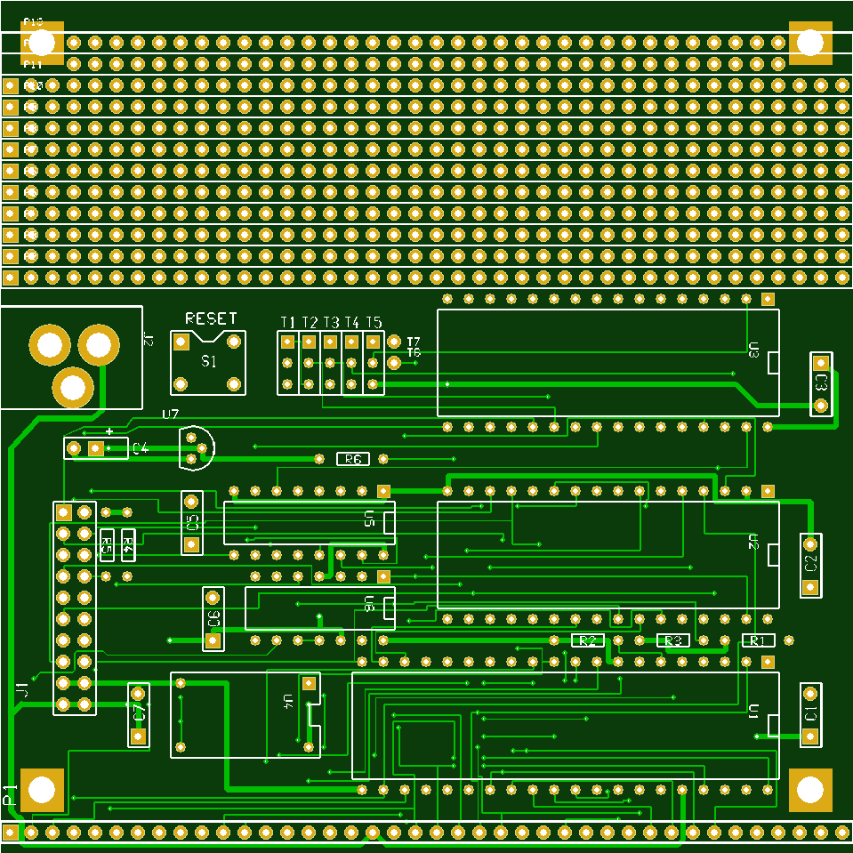

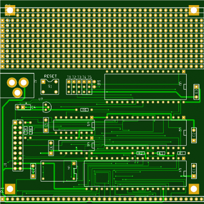

I had a "Layout-A-Rama" session yesterday and layout 5 pc boards. One of them is Prog65 rev0, the exploratory version of 6502-based EPROM programmer. At the risk of confusing newbies, I did combine two designs into one layout. It is a EPROM programmer with jumpers T1-T4 in "up" position and T6 connected to T7; or it is a 6502 SBC with T1-T4 in "down" position and T6/T7 disconnected. T5 selects one of two bootROM images. In hindsight T5 should not be in the same physical group as T1-T4. Oh well, this is why it is an "exploratory" version.
In programming mode, EPROM is at low 32K, FT245R at top 16K, and RAM from 0x8000-0xBFFF; 6502's RDY is controlled by FT245R's RXF#. 6502 basically executes opcode as provided by PC via USB connection to FT245R. In normal mode, RAM is at low 32K, EPROM at top 16K, and FT245R from 0x8000-0xBFFF; 6502's RDY is pulled up, and FT245R's RXF# is connected to 6502's IRQ. In normal mode 6502 boots from EPROM and use FT245R as console I/O. That's all, a simple dual-purpose SBC with 6502/RAM/EPROM, FT245R as I/O, and 2 TTL logic. We'll see whether it even work...that's why there is ample prototype area.
Sent them off to JLCPCB last night, received an email this morning that they are all in production. We are cooking with gas now! (Actually its electricity is coal-powered). Six set of pc boards (55 boards) for $27, but shipping (DHL standard) is still more at $27.07. I think JLCPCB is in the wrong business.
Something to note when you do your next PCB layout is to, where possible, avoid 90 degree corners in narrow traces. During production, there is a tendency for the etchant to "gnaw away" at the outside of the corner and reduce the trace cross-section. All board manufacturing processes that use chemical etching have this problem to some degree. The solution is to use two closely-placed 45 degree corners.

A bit of 7th-grade math tells me that the cross section is already larger by a factor of √ 2 at the corner, but your advice is well noted.

A bit of 7th-grade math tells me that the cross section is already larger by a factor of root 2 at the corner, but your advice is well noted.
From what I was able to determine when I got back into making my own PCBs about 10 years back (after a 30 year break!), the whole right-angled thing is pretty much a non-event these days with todays etching methods and chemistry. (And a quick google pulls up dozens of 'debunks' now too)
45° and curves do make it prettier though. (To some).
It's more a problem with narrow traces, such as the 0.006” and 0.010” ones I use on many of my boards. On the 1/4” honkers used to distribute power it's usually not of much consequence.
Suitably-routed 45° "jogs" will also reduce the overall trace length. Every little bit helps when you crank up the clock. :wink:

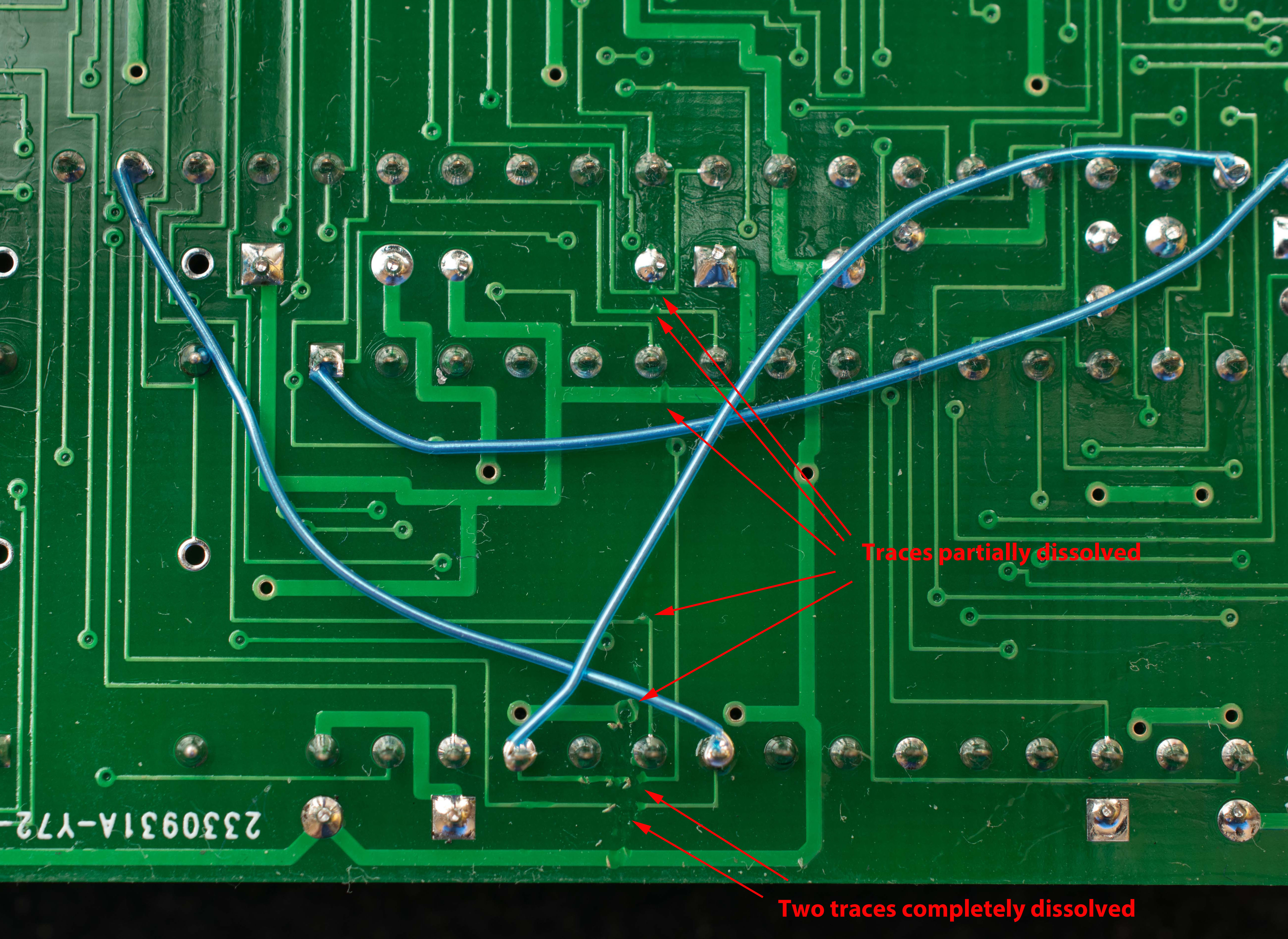

Since my ancient autorouter does not have the miter option enabled, I've been using 90 degree corners for the last 3-4 years without issues. I relied on autorouter completely but do add extra power/ground traces afterward. The boards produced by JLCPCB and Seeeds Studio are very high quality so the day of pc board inspection prior to assembly is pretty much over. Having said that, I did encounter a defective board from JLCPCB right after they restarted production post COVID. A drop of acid had over-etched several traces and cut two traces. The disturbing part is the board apparently had passed the electrical test. It is only defective one I've encountered in hundreds of boards.
