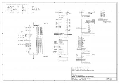

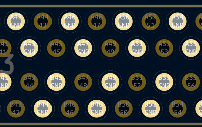

I'm leaning towards PCIe for the physical connector because of ground distribution and the issue that Garth has raised. The connector has 164 positions, and for the real PCIe standard, around half of those are ground, leaving 82 for signals. This is what it looks like physically:
82 signals would be plenty of space for what I want to include. If you look at my KiCad schematic, it is already grouped mainly by what would be a card in the future, so the signals that need to be on the bus are the ones connecting all the hierarchical sheets below. I might group one or two in a single card, like the glue logic and the CPU for example, but it is a rough approximation of what I need.
Going with DIN41612 would have the advantage of being period-accurate and being a bit easier to solder. You can also purchase pre-made prototyping cards. However the connectors are more expensive, I priced them on Mouser at around 2.5€-3€ per connector, of which you need 2 per card, whereas PCIe is less than 1€ per connector. I could also design my own prototyping cards.
That's all in the future though! The plan for now is to add a VIA so I can validate that I have all the right signals to drive the WDC bus interface, then do a 65C816 breakout board. It will contain everything needed to run this CPU with all the glue logic, demultiplexing etc. I'm thinking it will be useful for people getting into this CPU.
Good point. Seems to make a good choice for a high speed bus.
Do you have a link to a specific connector? I looked it up at Mouser, but all that were currently available did not seem to fit, or at least > 6€...
Looks like a good plan!
Question to your schemaitcs: where is /ROM_WE coming from?
At the moment from nowhere, it just has a pull-up. I plan to wire it up to the Teensy but first I need to solder the optional header on it to get access to more GPIO
