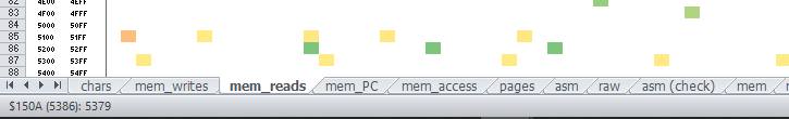

I have started to get a closer look at what's happening in terms of reads from and writes to memory. The problem is of course not collecting the info but rather condensing it sensibly. I first tried to group the access in pages, for the different subroutines as suggested by sark02 earlier in this thread. The info is of course helpful but only on a per-subroutine basis. Given the overwhelming number of instructions (and even subroutines) in Robotron, I decided to try to see the bigger picture first, on a per-byte basis.
It's work in progress so it's a bit premature to share it here, but maybe you guys have feedback to offer on how to progress from here. That's the reads from a couple of seconds of the intro (up to $CFFF, i.e. including the softswitches but excluding the higher parts of the ROM):
That's really the big picture - - a heatmap with all reads, each line of blocks a page. I can zoom in:
Address and access count of the selected block is shown in the status bar:
reads bottom.jpg (11.33 KiB) Viewed 1961 times
Beginning $2000 is the memory which is mapped to the screen. I had first assumed that I should not see any reads here, only writes, but you can see the effect of the code updating "sprites" in memory. The algorithm obviously needs to know what's in a particular area of the screen to remove and display pixels correctly. Related to displaying graphics are the pages $1200 and $1300. Access to the pages have the same color (i.e. exactly the same counts in both pages for each byte). These are the lobyte/hibyte lookup tables to translate logical pixel line into the where those lines physically reside in memory.

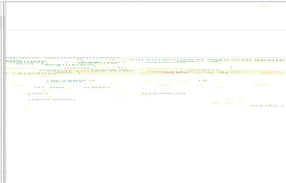

The Apple II is severly constrained in terms of memory. Consequently, Robotron uses for the "cut scenes" the actual game code to display elements like the player character or enemies. From a reverse engineering point of view this is fortunate, because I can use the uncluttered (and even scripted) movements of elements on the start screens to understand how the game moves "sprites" around the screen. For an example see the movements of the player character on the screen explaining the controls.
I've extended the read/write tracking of the workbench from my last post to project what's happening in memory onto the simulated screen. In the following pic you can see the "echo" of the beginning of the movement of the player character on the controls screen (i.e. what you see in the Youtube video, the character going from left to right first.)
Following the strategy suggested in my last post....
The workbench is reasonably fast enough to allow "slicing" the total dataset into smaller pictures = containing less cycles. I should thus be able to drill down to seeing a particular sprite drawn on the screen (write) and relate the bitmap to it's origin (read).
... I can visually do a trial-and-error to constrain the shown range of cycle counts (which I use as global clock) until I only see one particular "frame" of the movement:
The workbench can now show me the corresponding reads from memory:
The area between the horizontal lines is the video memory. The colors on the zero page (first line) show that there is some heavy indirect reading involved.
Looking at which code was executed between the shown cycle counts is of course necessary to understand what e.g. the memory related to the two green lines on the lower left contain: It's the actual sprite data, both for removing the first shown player character ("facing the camera")...

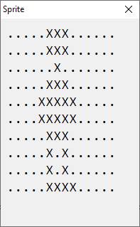

From inspecting the code and what's in memory I've gleaned some first information about how the sprites are stored in memory (resulting in the crude X. displays above), in particular how multiple sprites are stored in order to make it easy to horizontally move the sprite pixel-wise through the bits in screen memory.
This part of Robotron is quite central to the overall gameplay. The code takes generalised sprites (i.e. different heights, widths and "facings") and projects them onto the screen, inside bytes and scattered across the video memory (due to Apple II ideosyncrasies). In addition, the code needs to track the state of the sprite, to cycle through e.g. the left+right movements of the legs (or pulsing shapes etc.), which also needs to take into account the direction of movement. The algorithm is much more involved than I had originally thought it would be. A nice challenge! :)

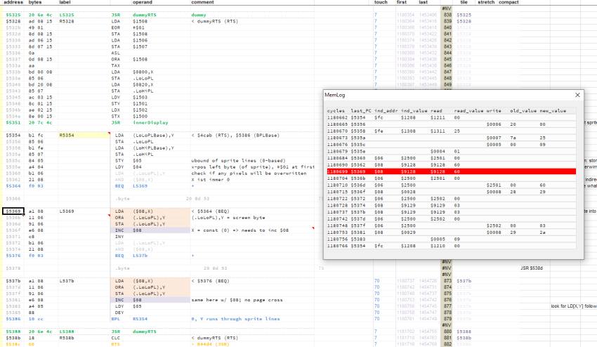

Having a good idea about how something works is still far from really knowing the details of how this is accomplished (oh yeah, Captain Obvious, tell us more ;) ). The "sprite projector" hinted at in the post above can serve as a good training ground to learn to tear into asm code.
Sadly (or interestingly, actually), my usual debugging skills can not so skillfully employed in the 6502 / Apple II arena. For the Apple II there are of course debuggers with single-stepping and breakpoints, but I think at this point of the learning curve I need more of an "explorer" than a "debugger".
My workbench has the ability to track all memory reads and writes, both absolute and indirect. That's e.g. what's behind the heat maps and the "screen echos" shown in my last two posts. For each read/write I track the cycle count of that operation, together with its PC. For the writes I store both the old value before the operation and the new value stored by the write. Although I do not yet log AXY (and SP only indirectly via the activity on page $01), some good understanding can be derived from relating changes in memory with the flow of instructions.
The pic above shows a part of the "sprite projector" and the memory log, positioned at a particular cycle and PC. I can move upwards and downwards in the MemLog window. This automatically synchronises with the asm code in the main window. I can also search forward and backward to the same PC, to compare changes in memory between different runs through the same stretches of code. I can also go in the main asm window to any PC and synchronise the MemLog to the first (or nth, forward and backward) occurance.
It's a bit like time travel debugging. For fully fledged time travel I would also have to store all changes to the registers, but that hasn't been necessary so far. Given the importance of the registers for, well, everything, that might come as a surprise. But because registers have to be loaded from somewhere and because this somewhere is usually not far from the point of interest, it's actually quite easy to trace the flow of data both through the memory and also through the registers. I'll see how far I get with that approach.
