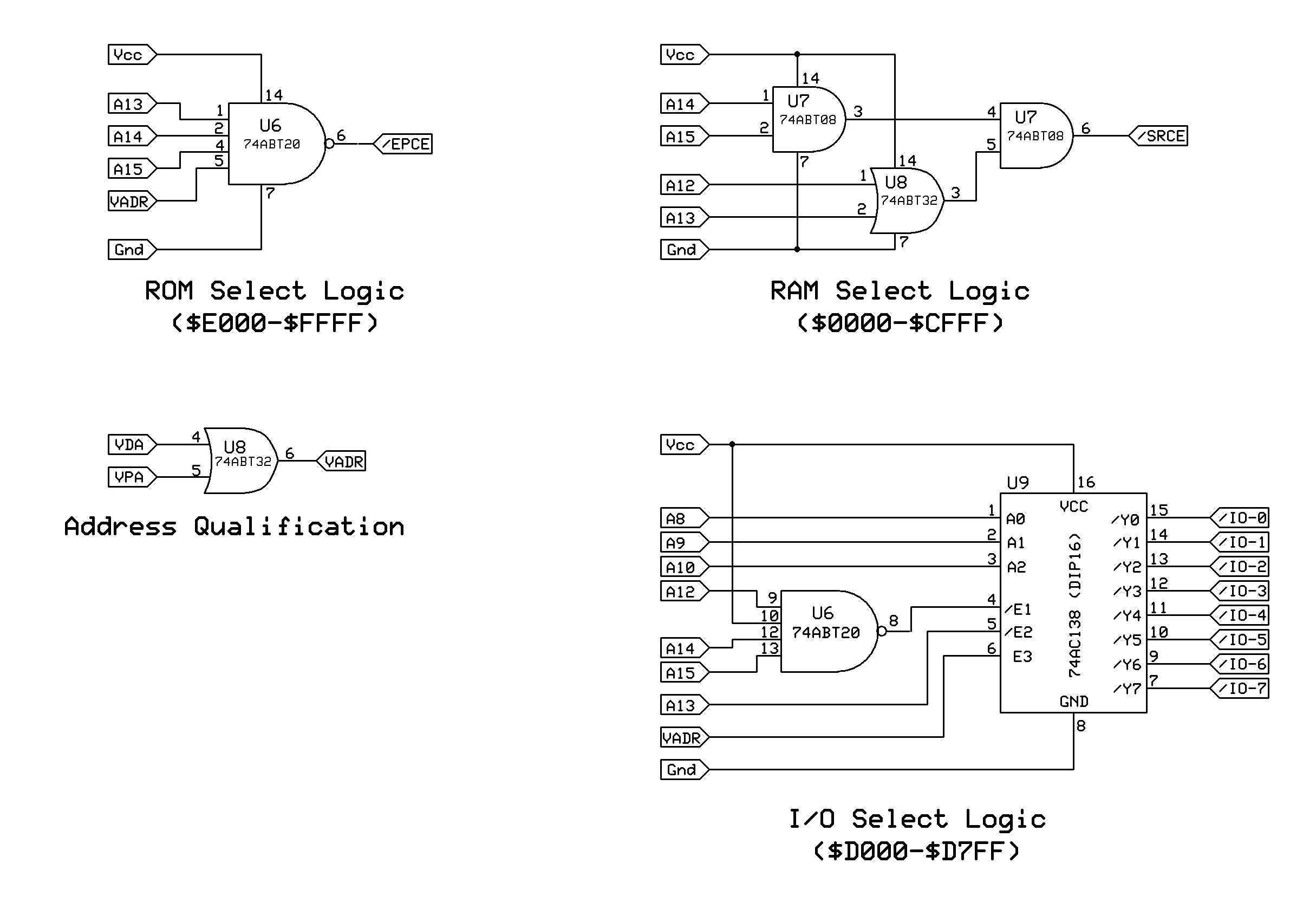

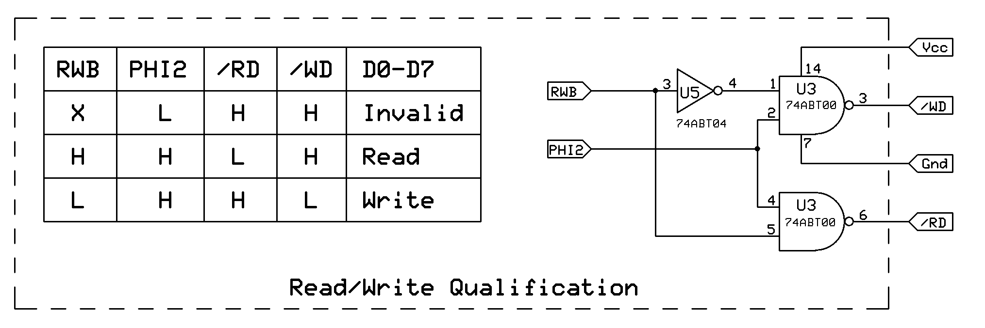

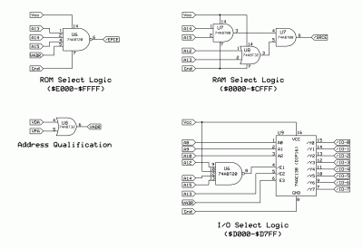

The required glue logic is trivial. If you are using a 65C816 you will also have to qualify chip selects with VDA and VPA, which can be done with a single OR gate. Here is how I did it in POC V1.1:
Chip decoding
Chip decoding
Read/write generation
Since I want to use through-hole components and discrete glue logic...
Everything that you need in through-hole glue logic is available in 74AC, which is fast enough to do the job.

This is my main concern- if writes/read require multiple clock cycles, then the chip can't be interfaced easily to the 65xx bus. Or am I misunderstanding something?
Hmm, could be. It's true that microprocessors such as Z80, 8080 etc use a fine-grained CPU clock running at a comparatively high frequency. Unlike 65xx, these chips require multiple CPU clock cycles to do a single bus cycle. However, the bus cycle is all that concerns you. The connection to an IO device (such as a UART) consists mainly of just a /RD and a /WR signal.
The second of BDD's attachments (above) shows how it only takes two gates to supply /RD and /WR on a 65xx system. :D

BDD... I stand corrected then. THANK YOU for that schematic. :D
