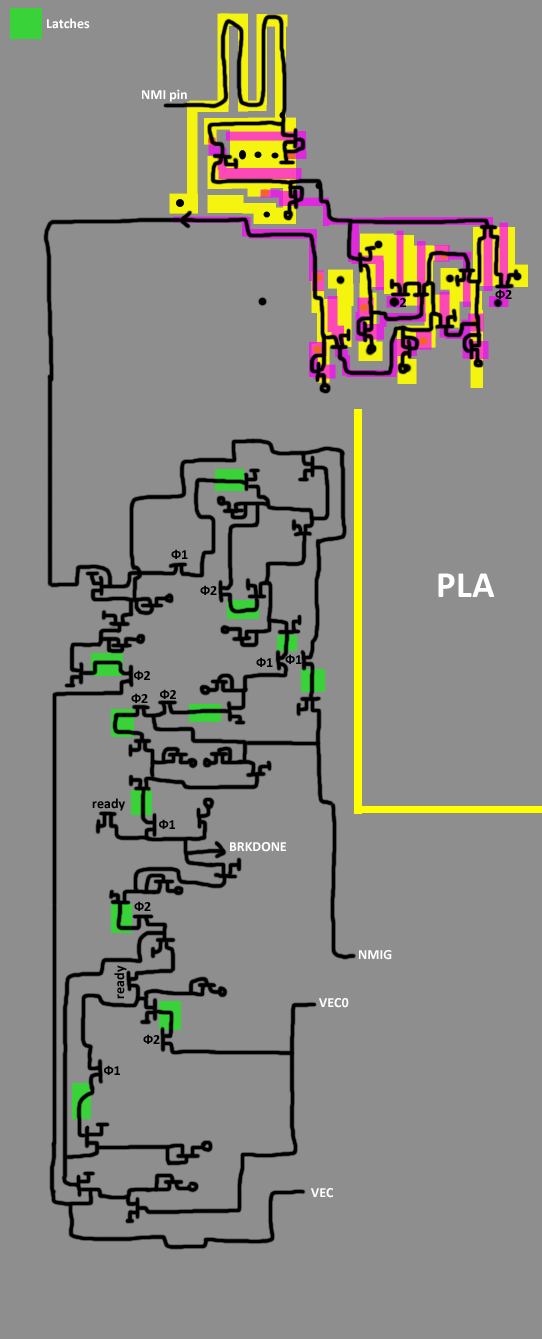

Re: Breaking 6502 apart
The last piece of 6502: interrupt priority logic.
Complete transistor-level circuit is on the way
Switched Google code project to MIT License.
