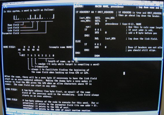

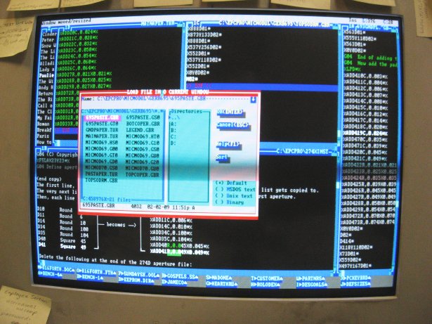

How about making it do the DOS/ANSI character set, so you get a lot of special characters including Greek ones we use in engineering all the time, ±½°, §6.2.2, a², arrows, scroll bars, and the characters that allow you to draw smooth boxes and diagrams. The DOS/ANSI characters are all that's used to generate these screens:
It's not a graphical user interface, but tiled, point-and-click, with dynamic window re-sizing, scroll bars, drop-down menus, radio buttons in dialog boxes, etc., with minimized windows showing along the bottom, done entirely with DOS/ANSI characters-- no graphics. I had about 30 files open at once when I took these pictures.

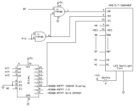

Ok, I finally figured this out. Sent 2 consecutive 8 bit color data successfully, and the software worked as expected thanks to the MK 6502 assembler.
Gonna require just abit of some software presentation here, IF there's no objections, which I will reveal in about a week. Over this time period, I'll update my past schematics on my past posts..
I thought I had a hardware problem but it wound up being a software delay issue (Maybe a hardware problem?, putting the delay in the right spot was the key, I will show an explanation and pics in the next few posts). I did make this hardware modification (shown below) to generate the /RD and /WR, which seemed much easier than generating a 6800 series (E)nable signal. Initially I just tied this line logic level high, as I had no intent to read from the device.
Thanks to Gene Zumchak, even though it's from an old Compute! magazine from 1980, (I think I saw this logic somewhere in the original MOS manuals as well...)
He showed how to generate 80xx series /WR and /RD signals from the 6502 R/W and 02 signals. Notice though the 6502 R/W is inverted. (... this did not make it work, but hopefully, I will be able to read from the display with this logic setup).
A clip from: http://www.atarimagazines.com/computeii ... page17.php
Here's the Display interface:

I hope someone can help me here. I found out after VERY extensive testing that I need a delay in between loading the Display data and storing the Display data, each and every single time. In my previous posts I was loading registers like this:
LDA #$00 ; Load register $00
STA $A000 ;
LDA #$80 ; Send #$80
STA $A001 ; Store it in register $00
Now I realize I need to do this to make it communicate properly:
LDA #$00
LDX #$01 ;
a DEX ;Delay
BNE a ;
STA $A000
LDA #$80
LDX #$01 ;
b DEX ;Delay
BNE b ;
STA $A001
Does this look like any kind of hardware problem to you guys? (I am not so good with timing issues, but this is a fairly simple project)
Also, can I make a macro that will insert this delay every time I write the registers so I don't have to manually type in the delay every single time?
