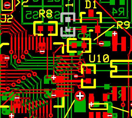

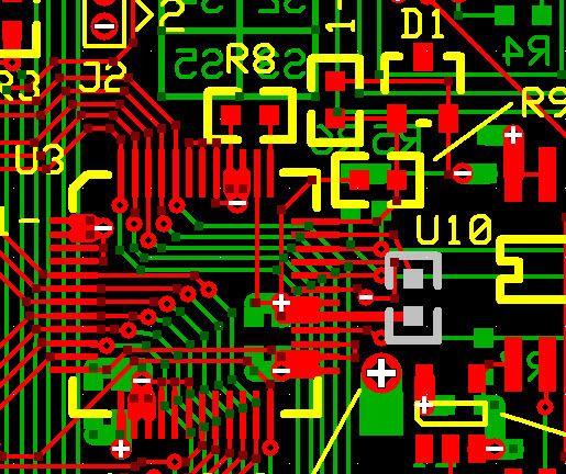

Ah, to let you in on a secret, all of the smallest (.008" I.D./.026" O.D.) vias on the board can snugly fit a stripped .010" WW wire into them even without soldering. While they are not guaranteed to be free of solder, looking at all 3 boards, not one of the vias is filled in.
A CLOSEUP shows you the possibilities. v1.0h is virtually identical...
Got some neato graphic designs on there too, heh. Will put the order in tomorrow.

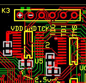

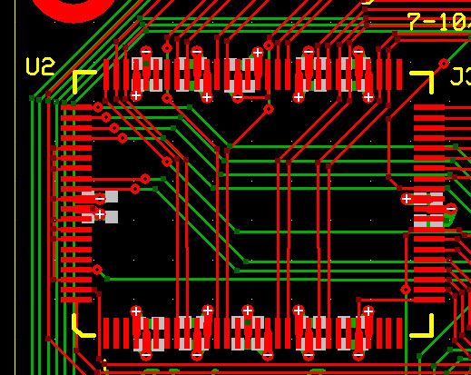

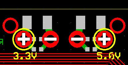

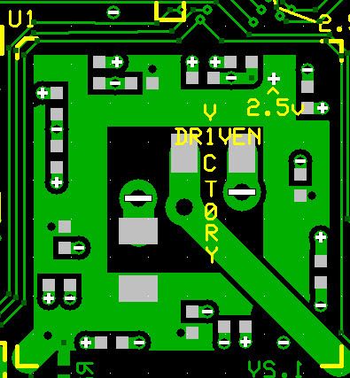

Some tips, in no particular order (parts are highlighted in white):
In regards to the:
(U2) SyncRAM: 2 0603 bypass cap's fit on each power pin on the bottom of the board.
(U5 & U6) FPGA PROMs: 4 0603 bypass cap's on the top.

(3.3V & 5.0V mains): 2 1210 cap's, 4 0603 cap's on the bottom.
(U1): 7 0603 bypass cap's on top.
(U1): 14 0603 bypass cap's on bottom. 2 1210 bypass cap's on bottom center.
