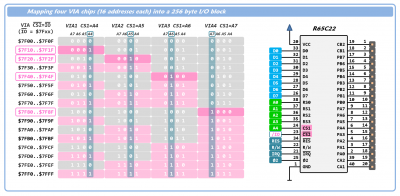

~io a5 a4 VIA
0 0 0 neither
0 0 1 VIA 1
0 1 0 VIA 2
0 1 1 both
It's obviously a question of never addressing the io/3x range, but generally I'd prefer something that physically excluded the possibility of two devices sending to the bus at the same time.
On occasion (rare, I know! ) my software has been known to do something other than that which I intended.
There's a lot to be said for a 74xxx138 (choose family to supply the delay your system can handle): two low and one high enable, and decoding of three address lines... so using A4-6 and an output - either polarity - for an iosel, and A7 and A8 if desired to add up to 32 VIAs!

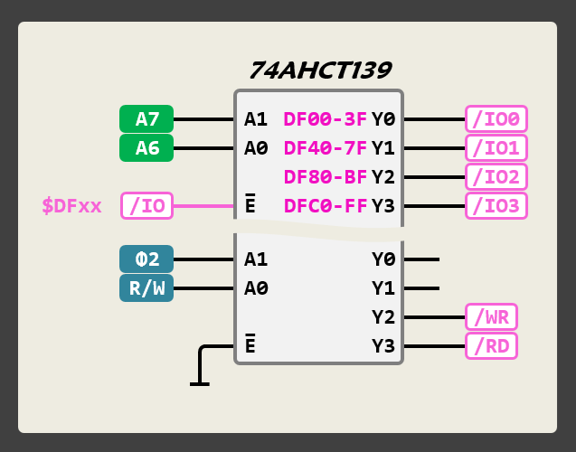

I agree. The 74xx138 is a versatile chip. You might also consider a single 74xx139 which could perform double-duty of sorts... That is, providing clock qualified read/write signals as well as four I/O device select strobes which could free several pins on the GAL... And, you could still connect two VIA's to one I/O select line.
Um, isn't there a risk there of inadvertently selecting _both_ VIAs?
It may be useful if for example you want to start the timers of both simultaneously. I can do that on my workbench computer, and in the 6502 Primer, but I don't think I've ever taken advantage of it, nor has it ever resulted in any trouble.

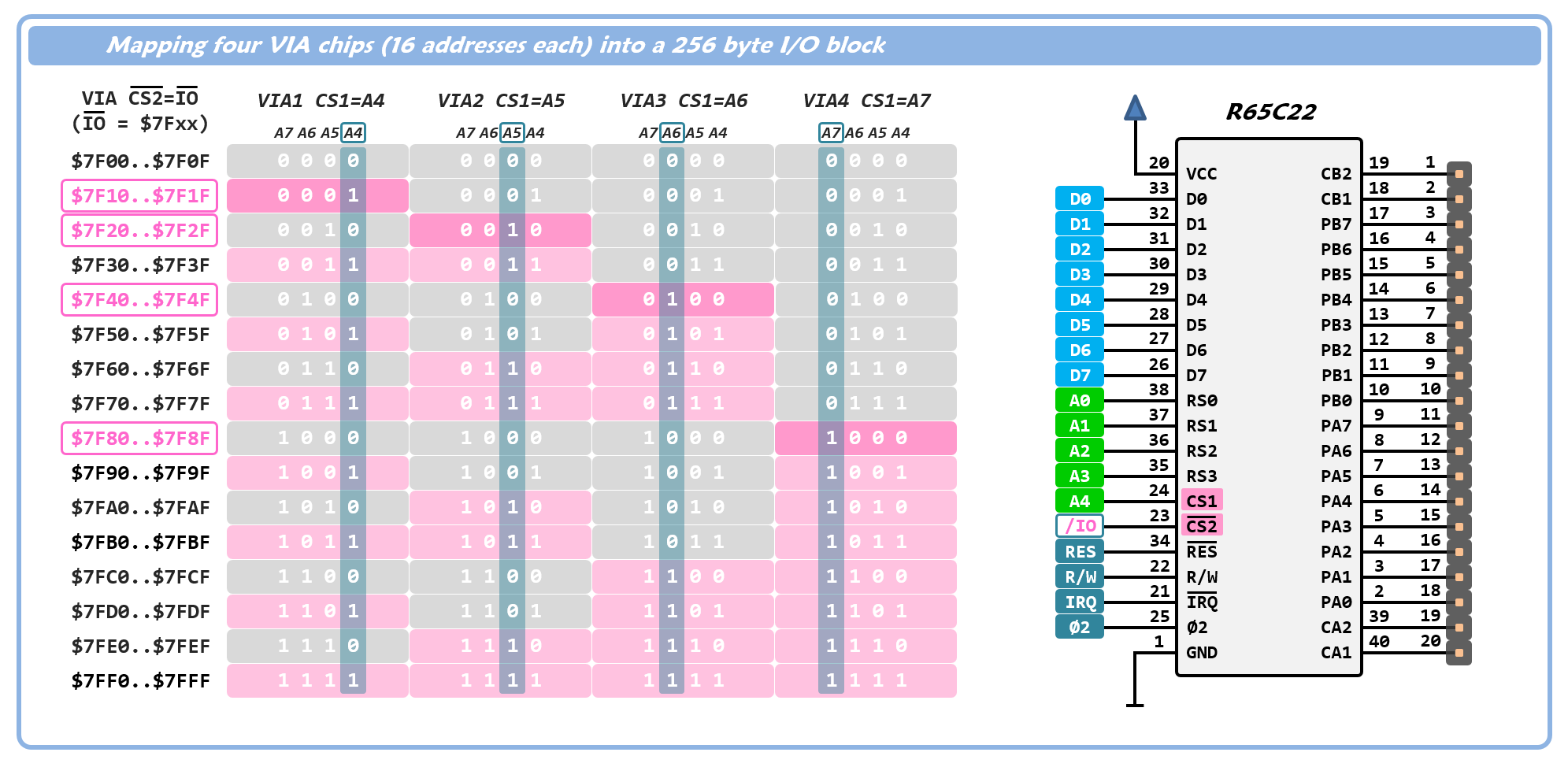

~io a5 a4 VIA
0 0 0 neither
0 0 1 VIA 1
0 1 0 VIA 2
0 1 1 both
Thanks for posting that. I can never read Michael’s drawings—the color combinations foil me every time.
With that truth table, it’s clear a decoding train wreck is waiting to happen.
What you note is akin to what can happen in a unit in which RDY is directly connected to VCC. The programmer didn’t mean to execute a WAI instruction, but due to a bug in the code, one got executed and RDY tried to short out VCC.
Avoiding this sort of thing is “defensive design,” which is essentially nothing more than anticipating circuit conditions that may lead to undesirable states. Oftentimes, expediency contradicts defensive design and leads to obdurate hardware bugs. My first POC unit was a victim of weird I/O problems because I didn’t use VDA and VPA to qualify addressing, as recommended in the 65C816 data sheet. It was expedient to not use those signals, but proved to be a mistake.

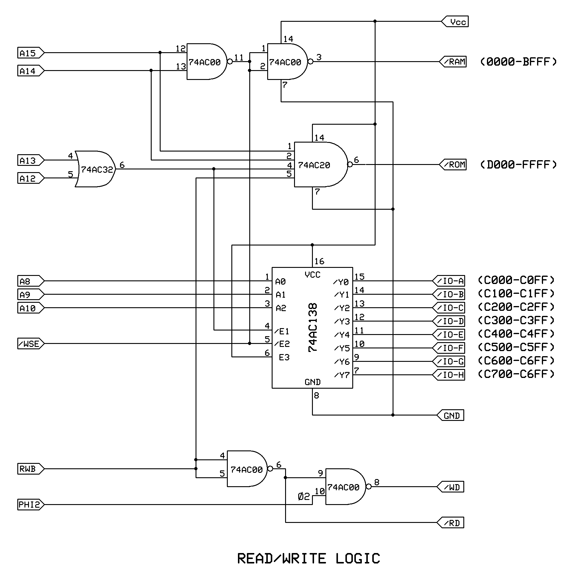

Since I/O is where the bulk of the decoding is needed, using a 74x138 eliminates most of the GAL’s raison d’être, eh? Might as well just build the decoding with discrete logic, as only a few more pieces of it would be required.
65C02 Mapping w/Discrete Logic
The above is a three-chip solution (not counting the decoder), including the qualified read/write. The memory map won’t be as granular as can be achieved with a GAL, but there would be chip selects for eight I/O devices.
You’d have to somehow guarantee the two VIAs can never be simultaneously selected during a read cycle so major data bus contention doesn’t occur.

I’ve used the 74AC138 in my discrete designs. Switching speeds for 74AC138 and the 74AHC138 are about the same as that of the 74FCT138, but with a higher VOH in a 5 volt system.
