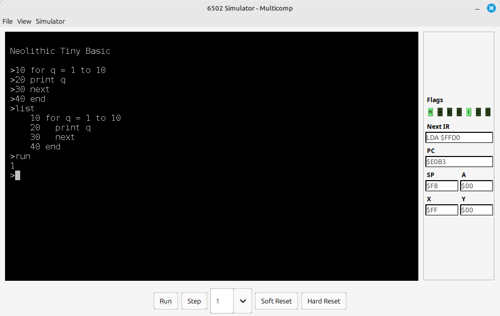

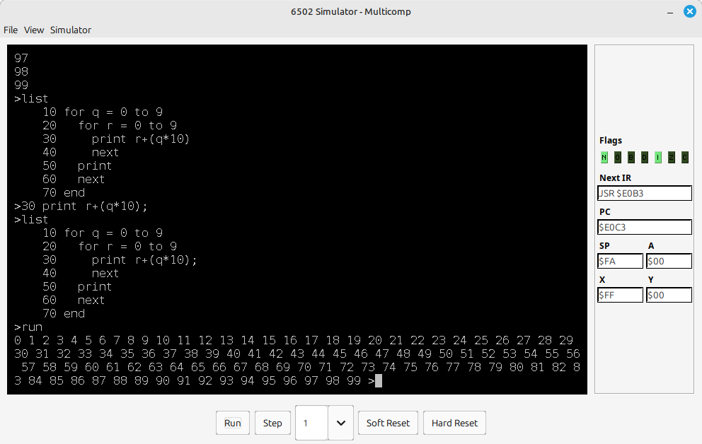

Dropped it in, it doesn't appear to have broken anything!
