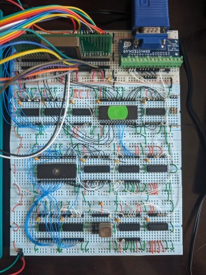

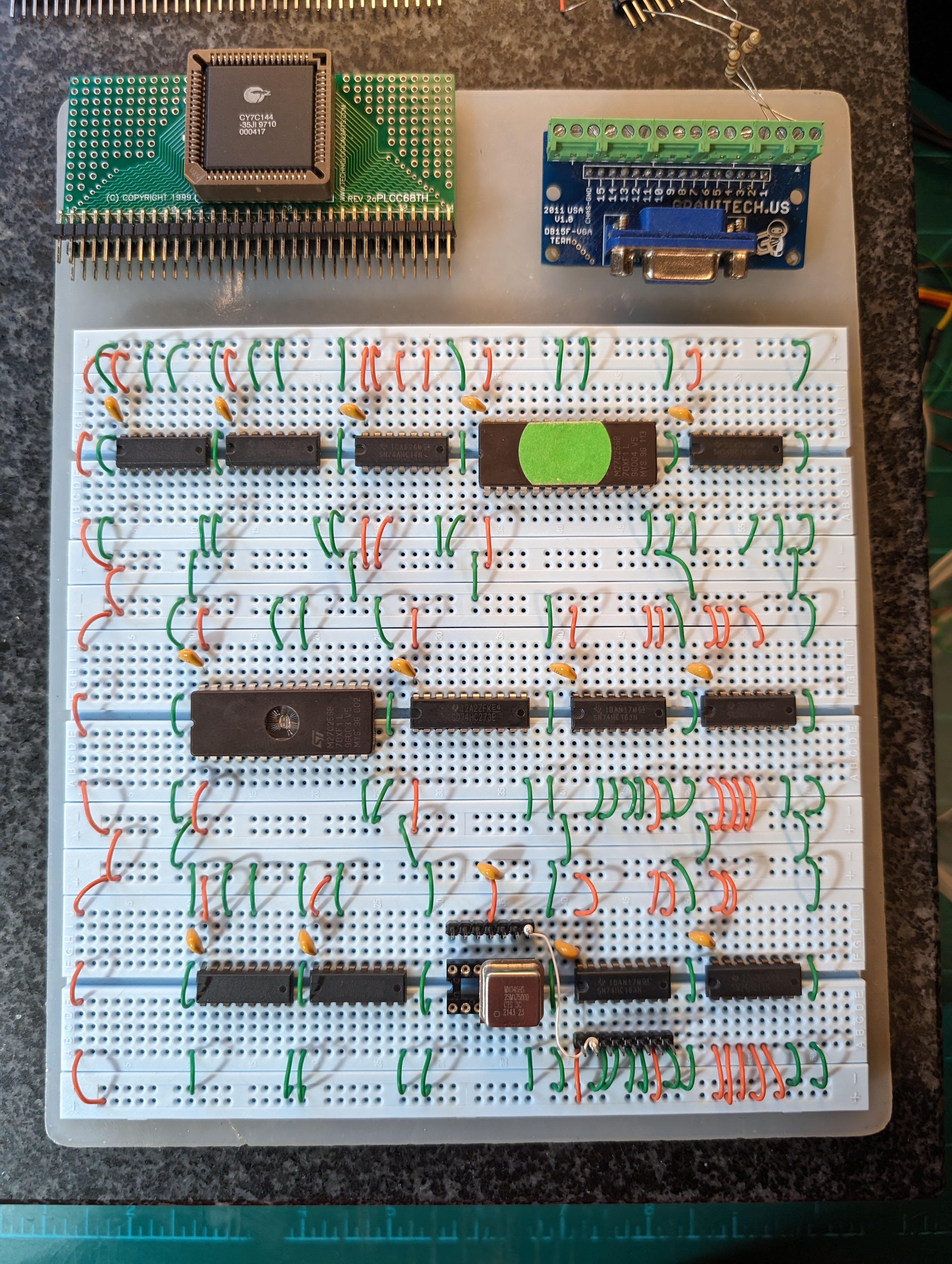

Since "finishing" this project, I haven't done much with it. It was sitting in a tub in my workshop collecting dust while I worked on other projects (mostly Blue August). It still had some messy wiring, and the way it was "installed" was that it had some ad hoc address decoding on one of Blue April's project boards.
Well, since I had so much fun with this project I thought I would rebuild the VGA board using the same construction method. I also took the opportunity to rearrange the layout a bit to make the wiring better. Here it is with the power grid wired up:
And here it is all finished:

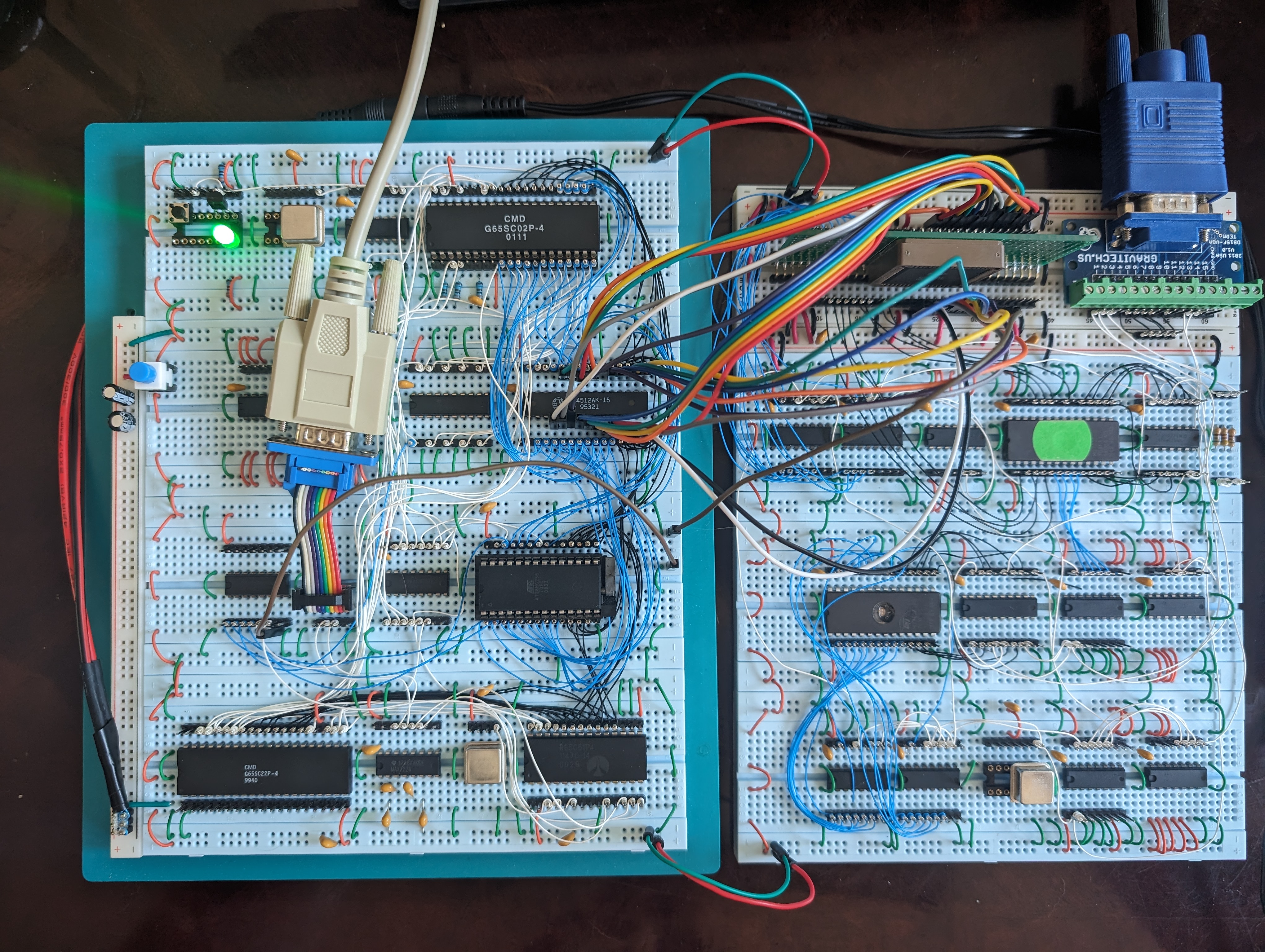

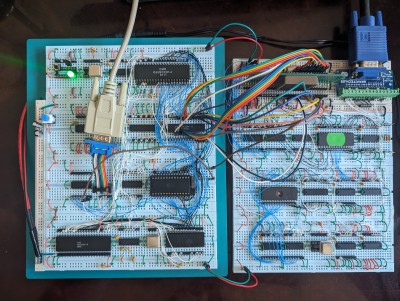

And here it is installed in the blue breadboard computer!
A while ago someone asked me to make a video of it working; I think it was George (gfoot) but it might have been Chad (sburrow). Anyway, I did that too. Sorry it took so long! Here's a short demo: https://www.youtube.com/watch?v=i76deH8oiyQ I shot it with my phone, which actually has a very nice camera, but it's kind of hard to operate it with one hand while typing, so the video is a little blurry I'm afraid. My video BIOS is very rudimentary so far, but I can clear the screen and output characters, so that's enough to show WOZMON working. :D
