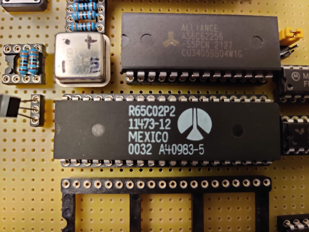

I just got the Rockwell R65C02 P2 in the post. Plugged it in and tried one of my existing pre-programmed chips. Darn me if it diddn't work (it did). Well after a fashoin since much of the initialization of variables to 0 using STZ was just ignored - which is odd since my datasheet says it should be okay on that chip (hex 64 for example - zero a zero page byte). After replaceing these instructions with LDA #0 and STA instructions my interrupt driven clock is working (the bit that reads the i2c realtime clock is failing but the clock is otherwise working fine).
So, whats all that about then? Does this mean I need heavier pullup resistors on the WDC chip?
Any thoughts on the STZ? That seems very odd to me. Here is a pic of the new chip. (If is indeed new, by the way, the pins never inserted - still splayed out, etc etc).

The R65C02 is fully TTL level compliant. So, at least with that CPU there should be no issue with the TTL spec'd memory. You should not need pull-ups with it.
What was your source? I’m suspicious of the date code and the quality of the lettering.
Oh and eBay.
I'll do a few more tests tomorrow on the unconditional branch and test and set instructions.
Still, it has done enough to show the CMOS vs TTL thing is likely the cause of all my troubles.

adrianhudson wrote:
adrianhudson wrote:
I have to say I am becoming more suspicious myself. I think it's probably a straight 6502.
Check the current draw. That is a dead giveaway. An R65C02 will draw less than 10mA. The NMOS version will draw around 65-75mA.

Anyway, this "Rockwell R65C02" that I bought from eBay (that isn't one of those, I reckon its an NMOS 6502 since it draws 80mA - thanks BillO) makes things very, VERY much better. If I treat it as the NMOS part it works fully - well as much as I have tested it, which is running a memory test program for 12 hours and an interrupt driven clock ever since.

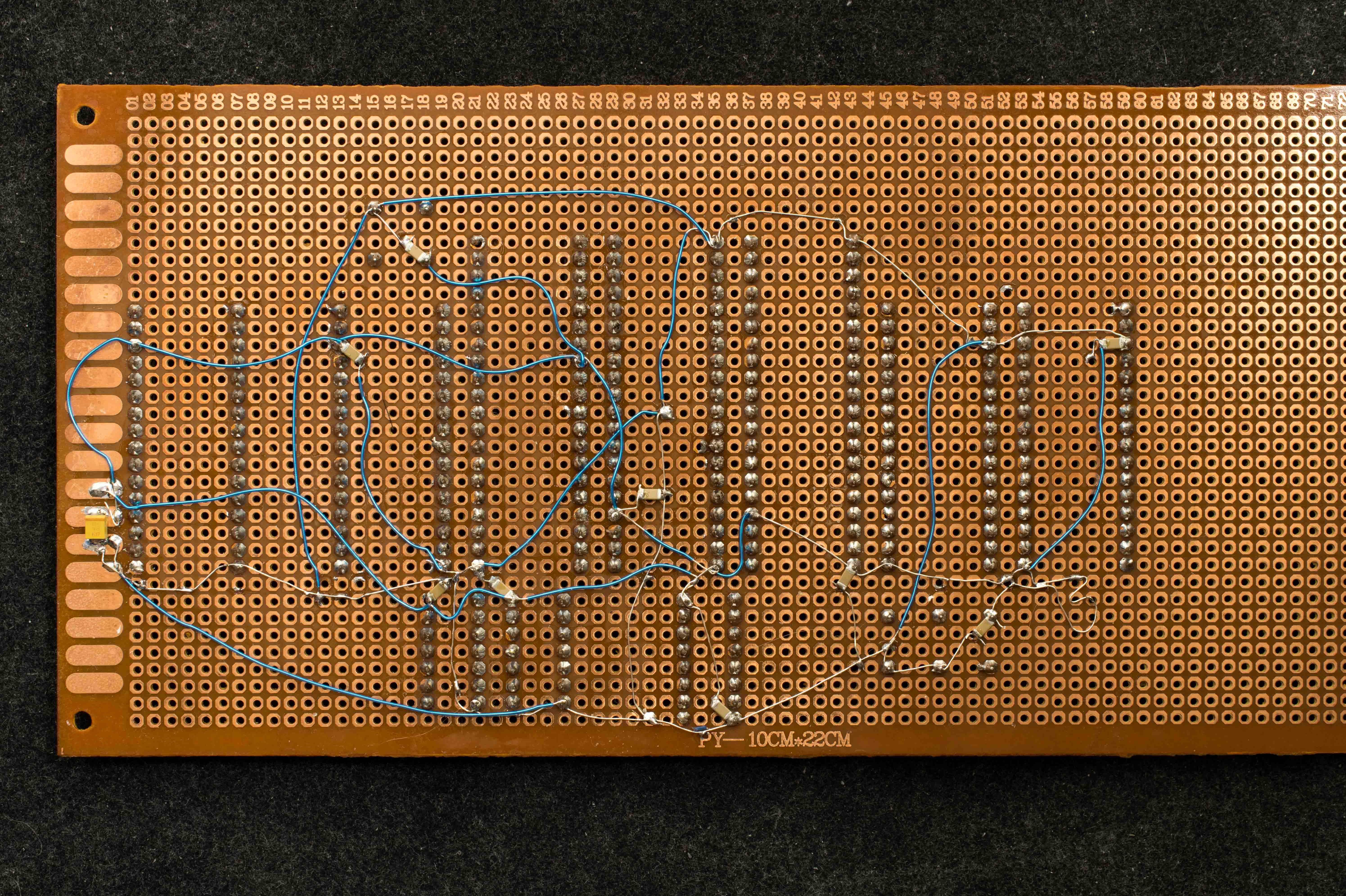

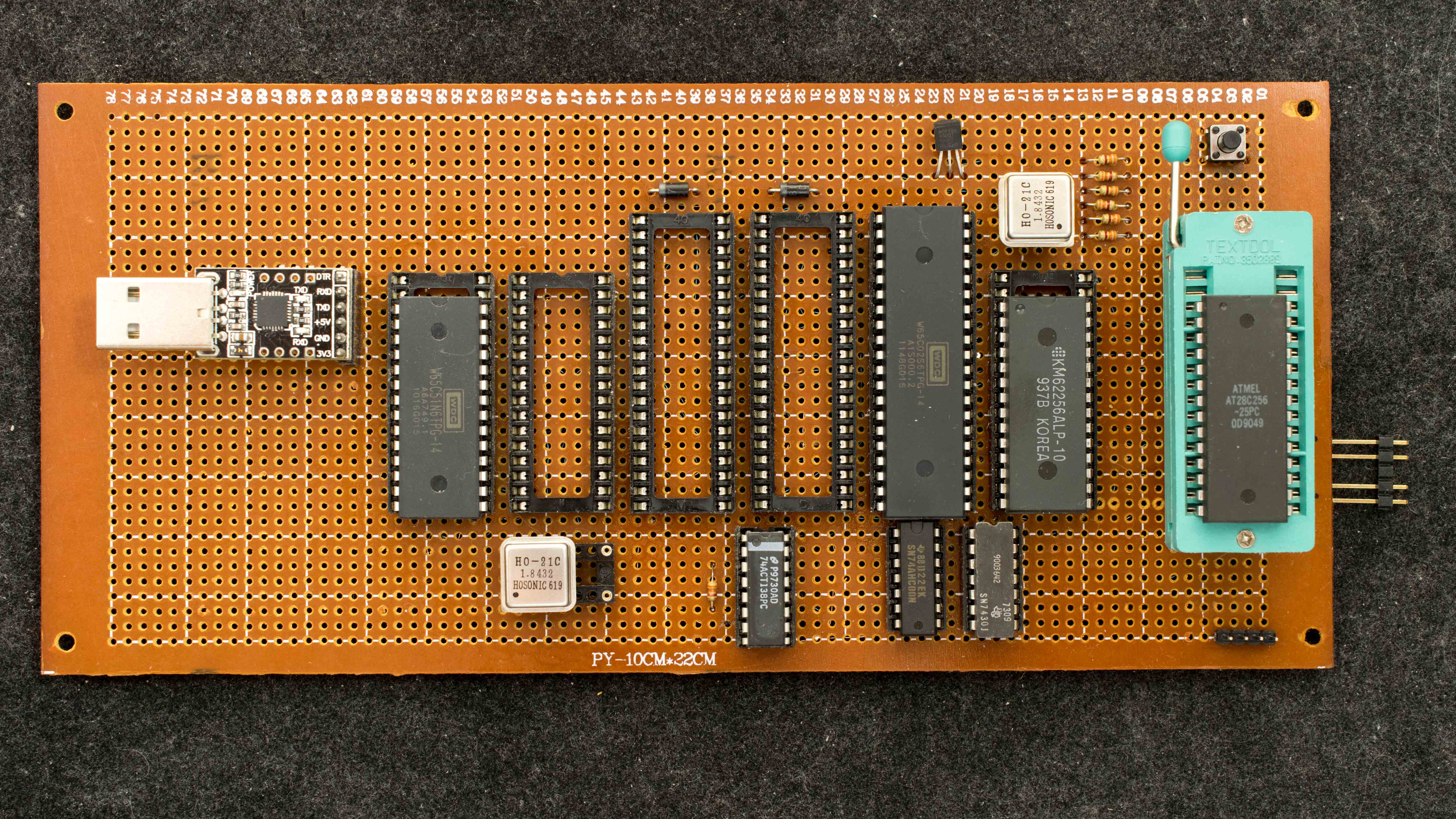

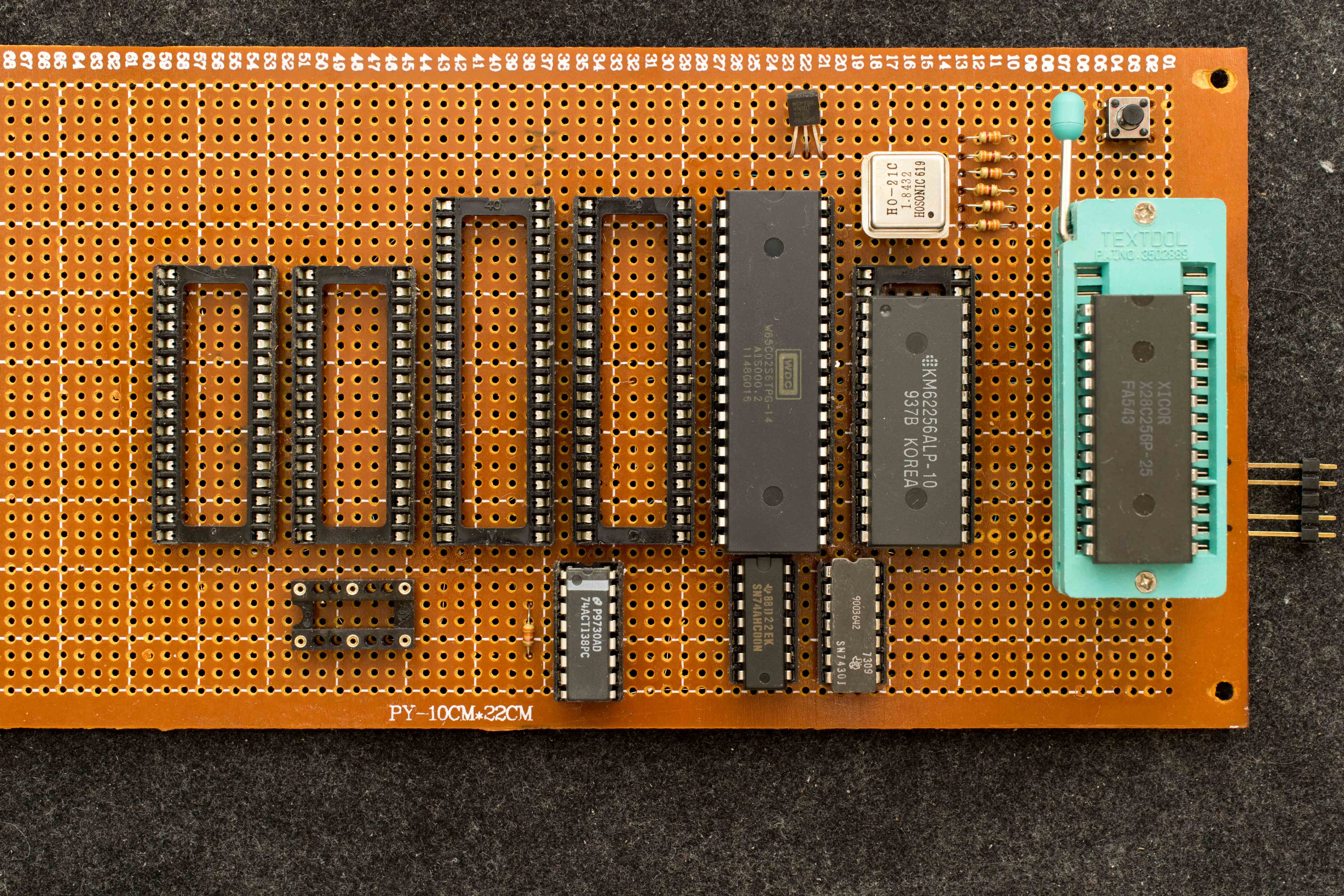

Re: Strange memory write problems
The problem is intriguing and yesterday was a cold and dreary day so I built up a prototype board following your schematic and layout. The schematic is as amended on 10/22/22, as suggested by floobydust. The protoboard is also a single-sided vector board. Instead of wirewrapping (I don't have wire wrap sockets), I did point-to-point soldering which is slower than wirewrapping so I only did the CPU-RAM-ROM portion first. The parts I'm using are:
7430
74AHC00
74ACT138
W65C02
KM62256
X28C256
1.8432MHz oscillator
First picture is power/ground distribution which is not great but generally adequate; 2nd picture is CPU-RAM-ROM wired; third picture is the component view. I powered it up this morning and no smoke. NOP test ran OK with current draws of about 20mA. Working on a RAM diagnostic that sending out test results like Morse code.
I can take scope pictures and test your software on this parallel prototype board.

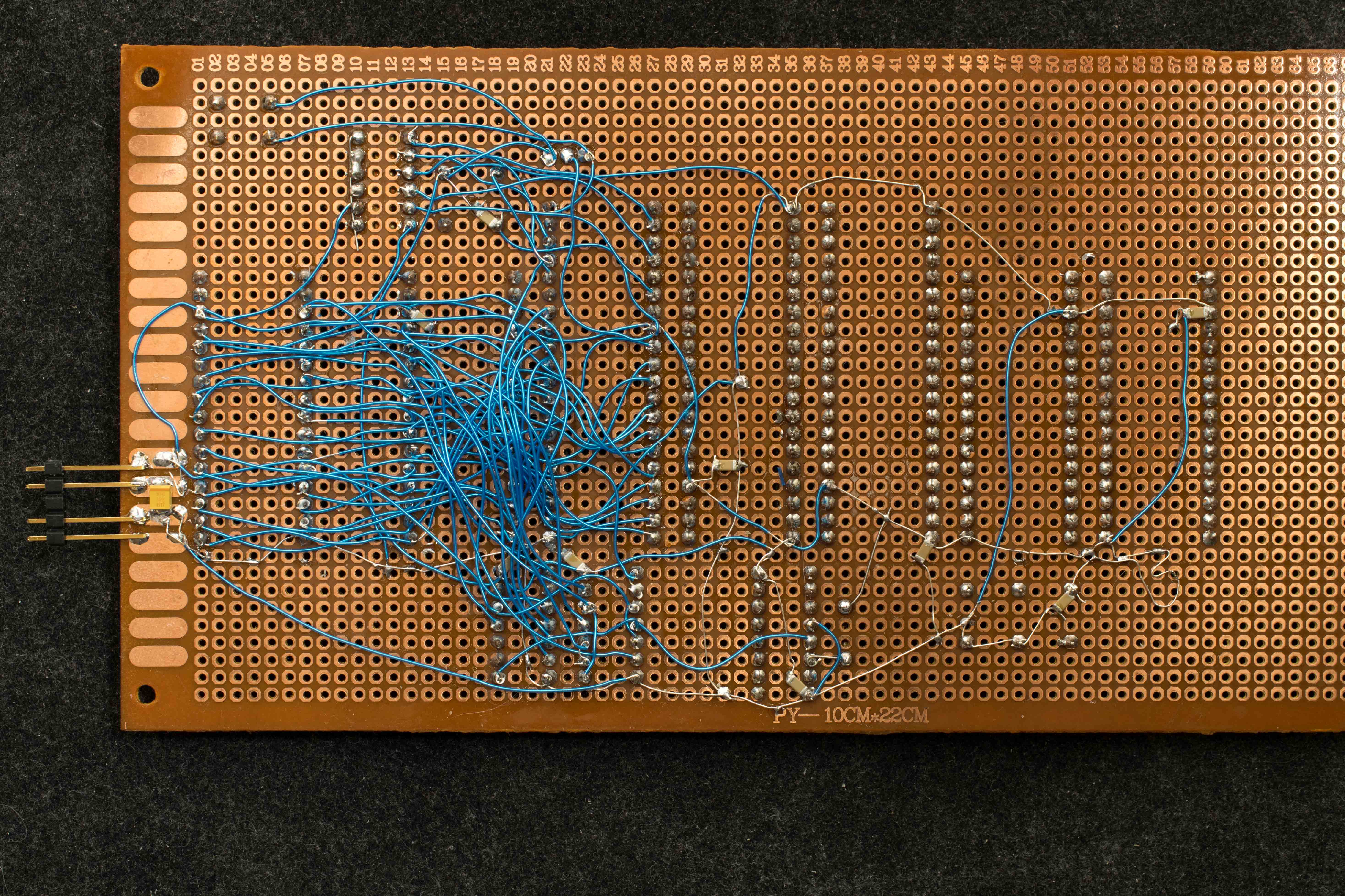

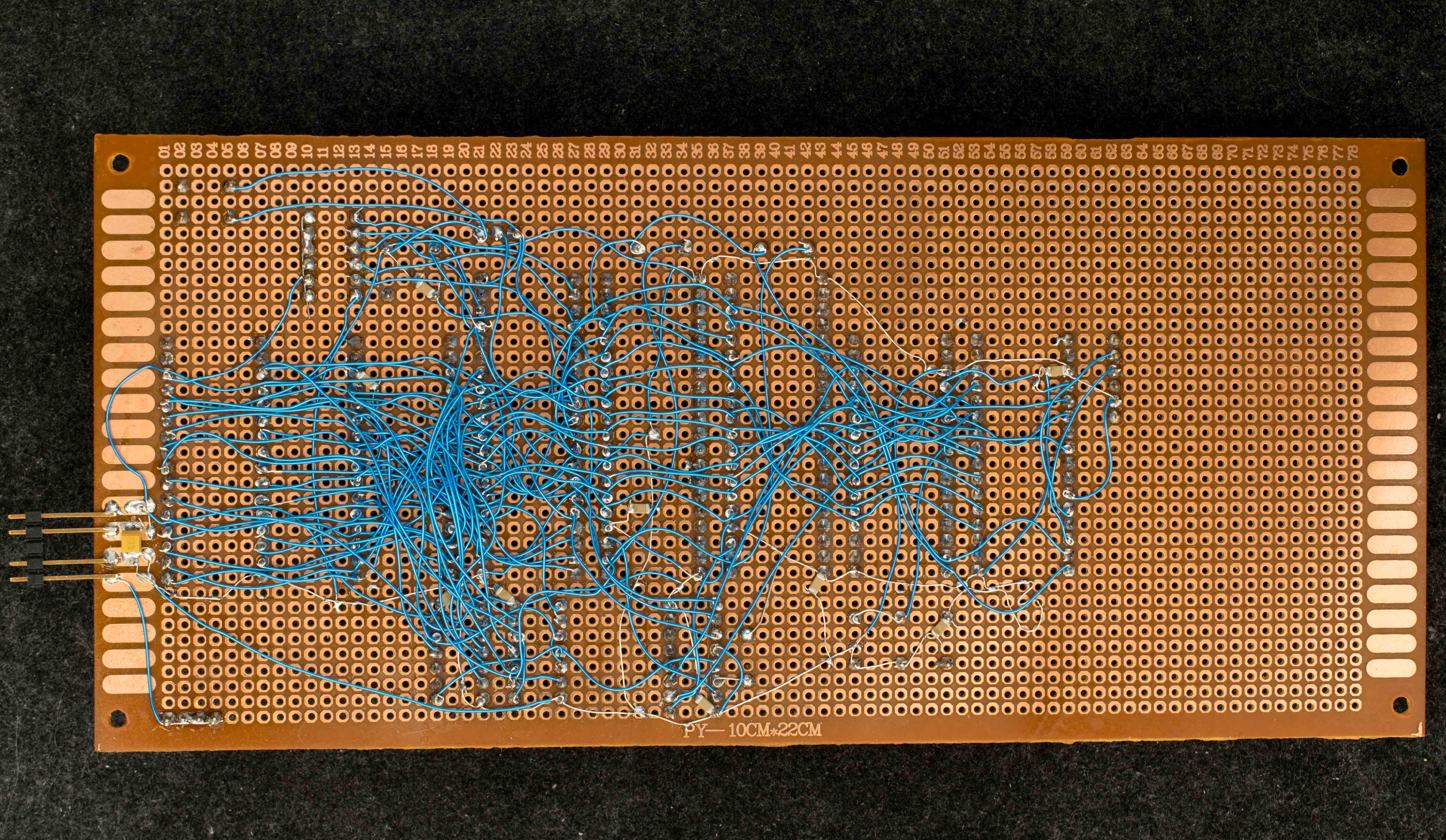

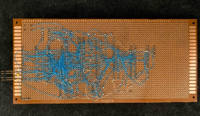

I finished wiring up the board. Powered it up and it is not working; memory diagnostic is failing; and I can see contention on data bus! So I thought maybe I'm duplicating the problem you experienced. However visual inspection showed a short between pin 22 (R/W) and 23 (CS2) of 65C22. Once the short is removed, it is working properly.
I'm running RAM diagnostic outputting the result over W65C51 for the last 30 minutes without errors.
I found an Atmel AT28C256 so I think my parts are very similar to yours except 7430 and KM62256. Data bus is not pulled up. Power consumption is 56mA running memory diagnostic with 1.84MHz CPU clock.
I believe your design is solid but there is an mechanical problem somewhere in your prototype. Please let me know if there are signals you want me to capture or software for me to run.
