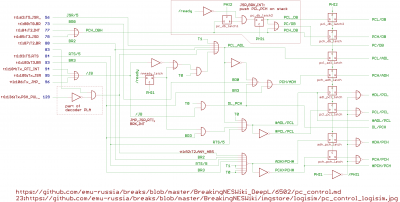

Posted: Tue Jun 18, 2024 6:44 am
by ttlworks
Three years later, while dissecting the 6571 core,
I noticed by accident that something went wrong with the polarity of the JB signal in my 6509 dissection.
I now fixed this.
Also, that error went into my schematic for breaknes,
and my fixed schematic for breaknes looks like this:
//This does not affect the schematics drawn by the breaknes team.
