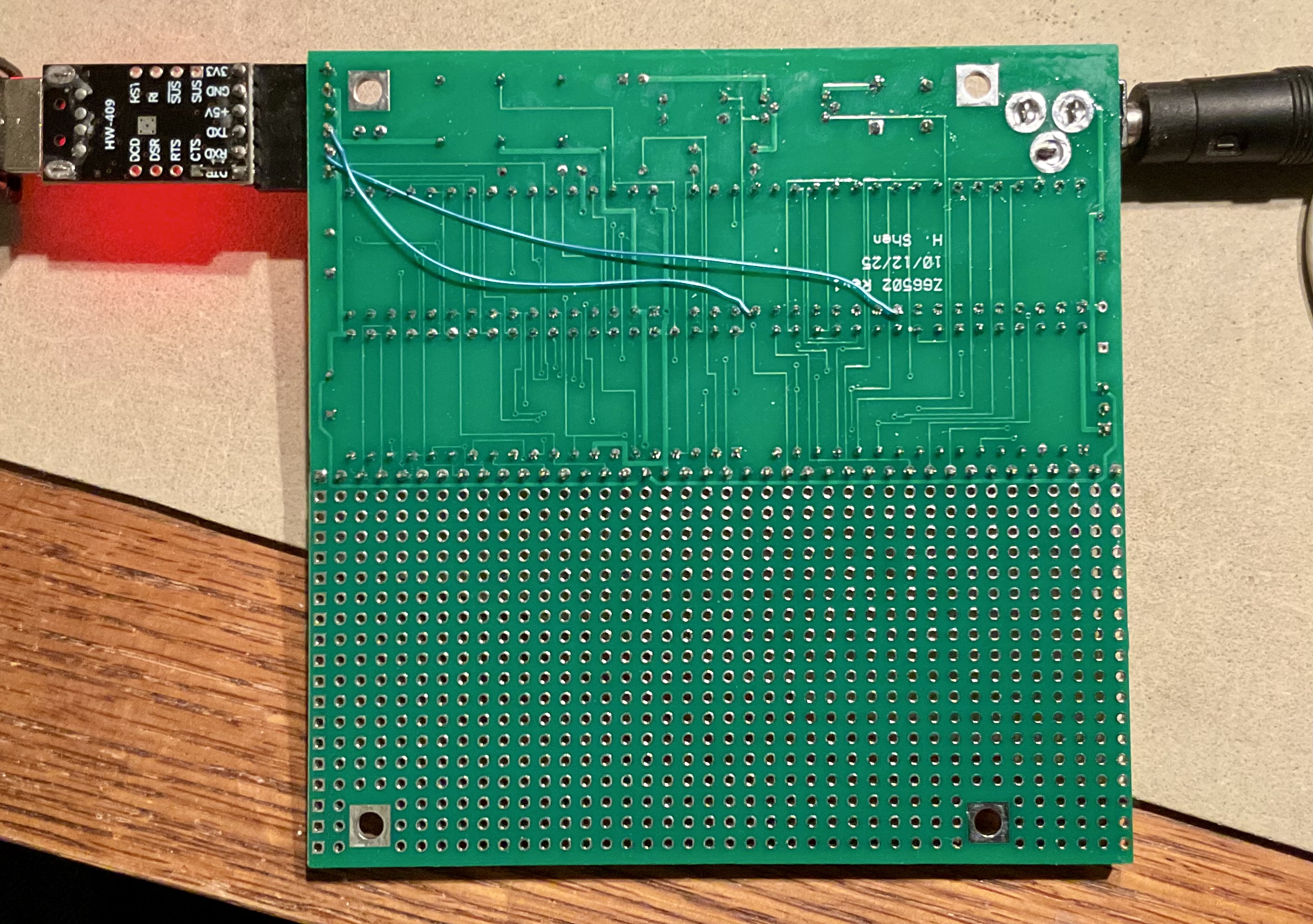

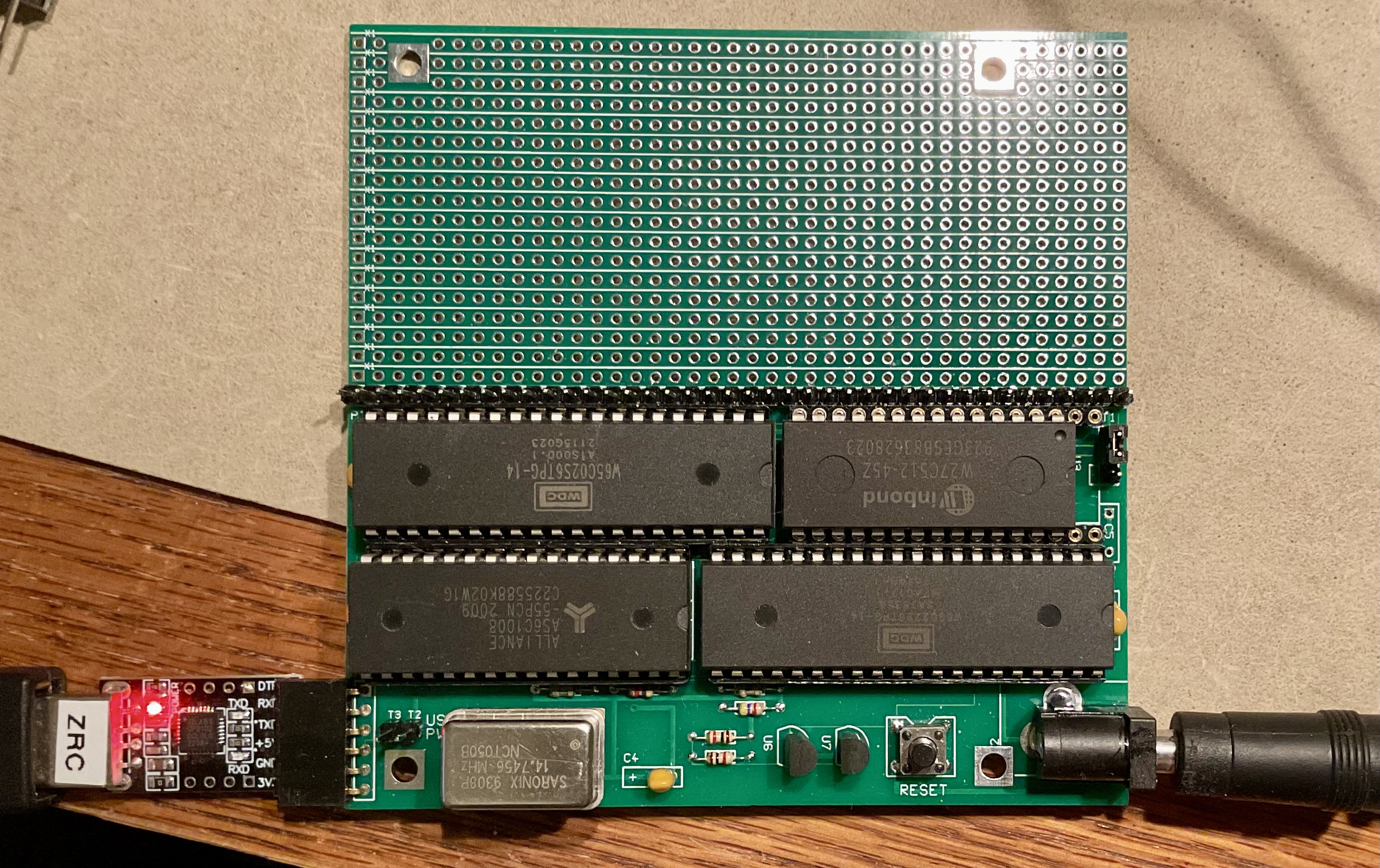

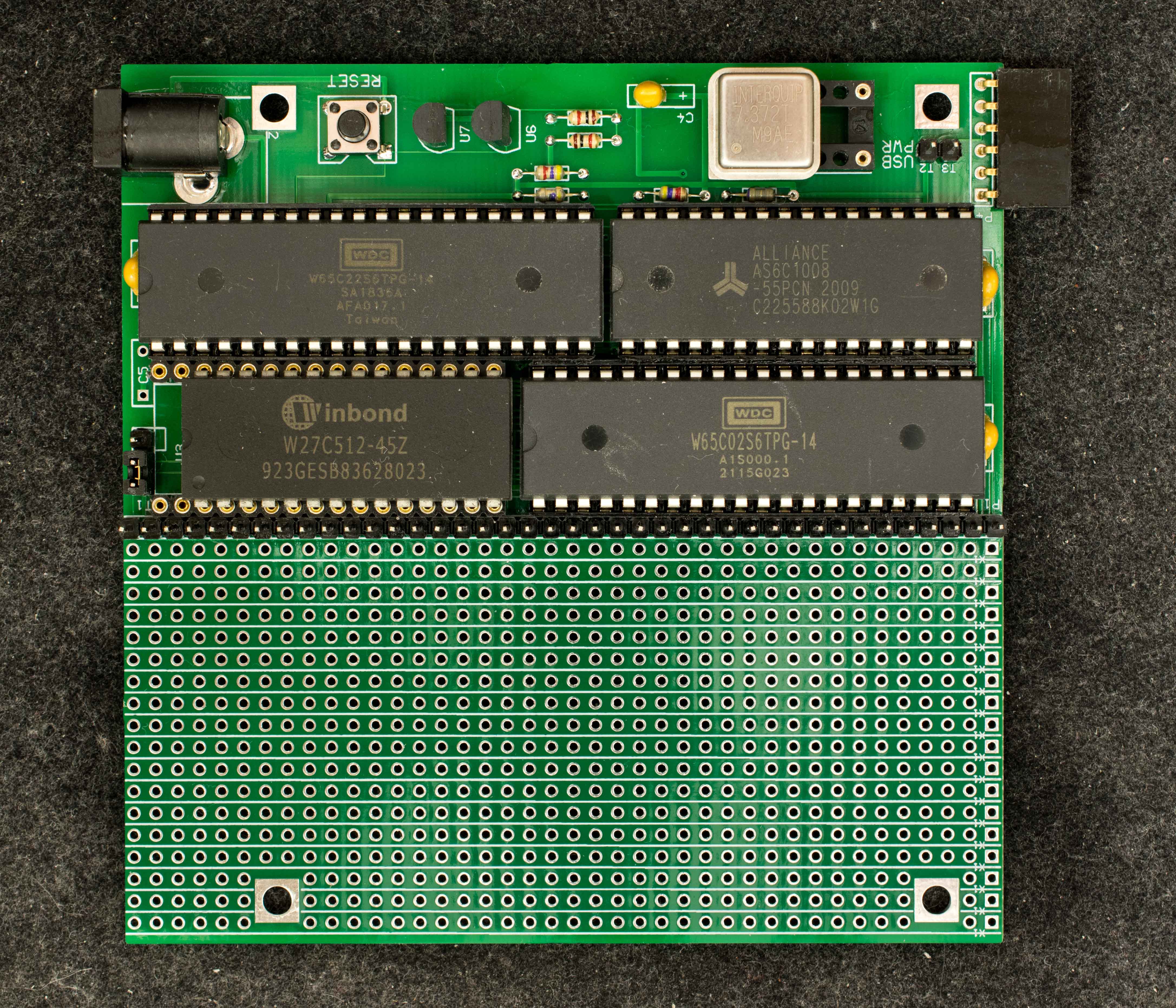

After 3-1/2 years, I finally got around to design another version of zero-glue 6502, this time with W65C22S. I was disappointed with the top speed of ZG6502 rev0 limited to 7.37MHz. I've thought the CMOS W65C51 should be able to run to at least 14MHz. So rev1 replaced W65C51 with W65C22S and I hope to run it to 14MHz. Half of the board is prototype area and serial port is not even hooked up. My first challenge is developing a bit-bang serial port using W65C22S.

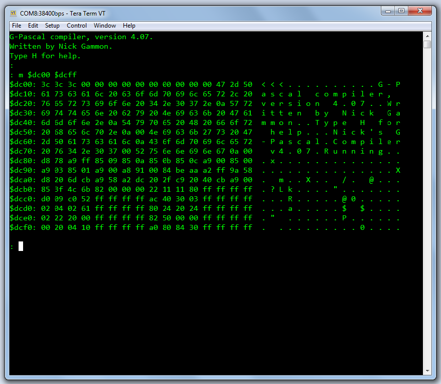

Nick Gammon's G-Pascal operating system may be worth a peek as it includes interrupt driven VIA serial drivers. I tested it on a little 8-MHz RAM-only board (below) that doubles as an EEPROM / Flash ROM programmer and it works quite well.

The problem with bit-bang serial port is the tedious cycle counting to get the bit time correct. That's a real pain when bit-bang serial port is the primary communication interface. So after reprogramming the flash a number of times, I decided it is lot easier to add a mezzanine board with a serial port that acts as the communication interface so I can load and debug bit-bang program for W65C22. Fortunately ZG6502 has a RC2014-like bus interface to accommodate a CPLD board with proven serial port design. Here is my software development platform. Since CPLD serial port is fast, I've also tested out ZG6502rev1 is operating correctly at14.7MHz.

My CPU clock is 7.37mhz, so I can do 115200 with 0.4% error. It is half duplex like you’ve said, so I use 2 stop bits to give the receiver more time. Raising CPU clock to 14.7mhz should give me more precision with bit timing at 115200 and handle receive more reliably.

Is the W27C512 ROM fast enough to run with a 14.7-MHz clock during that short period during start-up when you're copying ROM to RAM?

On paper W27C512 is 45nS access, so no, not on paper. In practice, it is faster than spec and furthermore its chip select and output enable are grounded, so the access is from valid addresses to valid data out. W65C02 addresses are valid significantly earlier than the rising edge of clock, so I’m able to run successfully. My guess is it can run close to 20mhz.

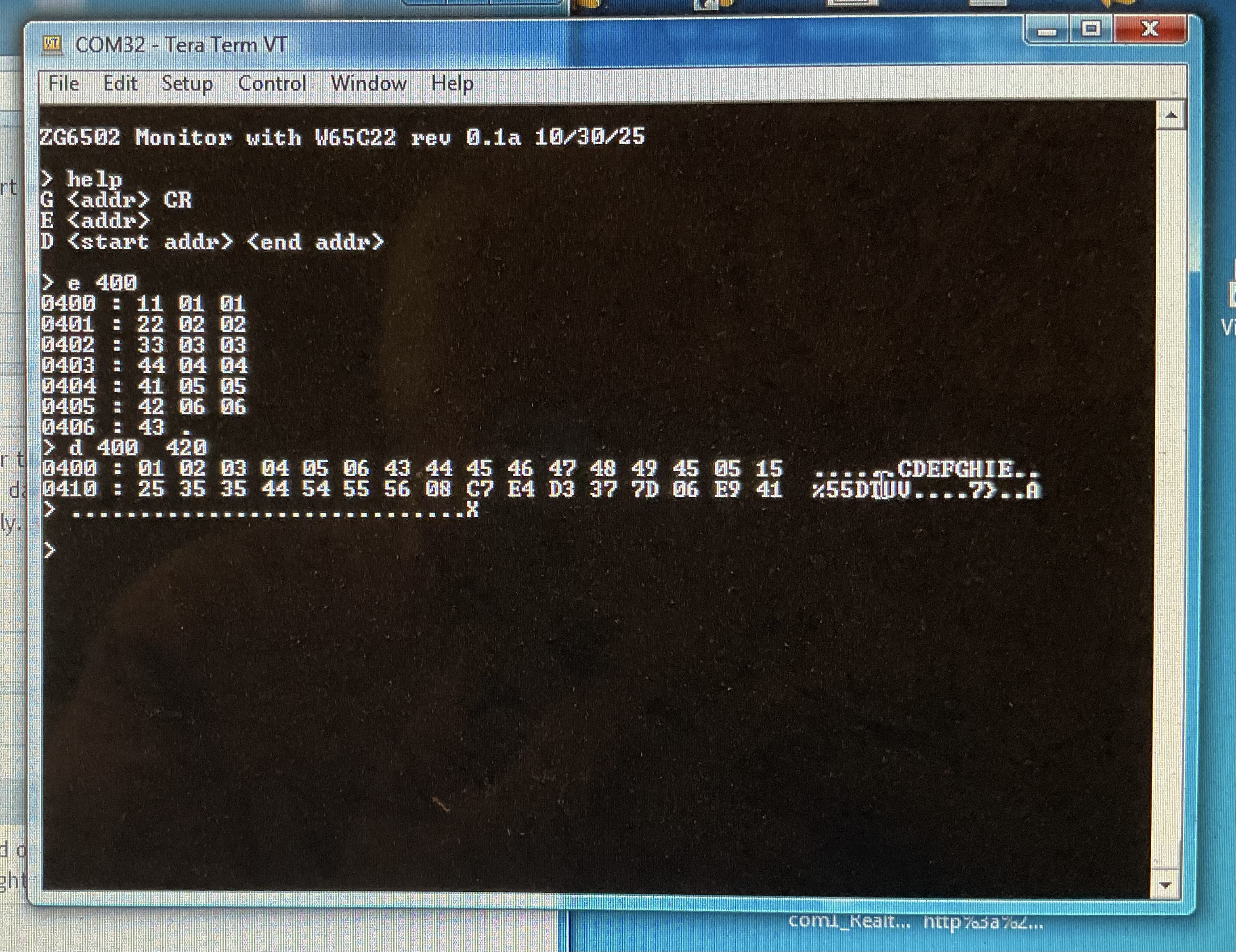

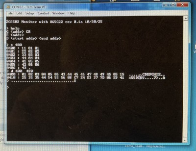

I’m successful implementing a bit-bang serial port using W65C22. Port B data[0] is serial transmit and port B data[7] is serial receive. The bit rate is 115200 at 7.37mhz or 230400 at 14.7mhz. The board can run at 16mhz, but won’t run at 18.4 mhz. It is half duplex so for file upload to work, the terminal emulator needs to set to 2 stop bits. The current consumption is 50mA at 14.7mhz, but about half of the current is consumed by the oscillator (22mA). I only need to bodge 2 wires; transmit and receive from W65C22 to serial port connector.
The simple monitor is derived from rev0 of ZG6502 which had W65C51 serial port. The W65C51 serial in and out routines are replaced with corresponding W65C22 bit-bang routines. It is a basic 4-function monitor that can display, modify memories, load Intel Hex file, and execute from user specified address.
Only 2 I/O lines of W65C22 are used for the serial port function, so there are lots of I/O lines available for experimentation.
