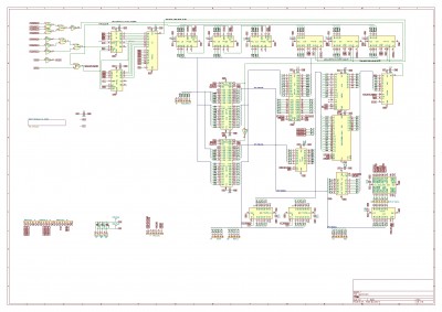

Here is the first iteration. It uses 3 dual pot rams now - one for the character value, one for foreground and one for background. So in the end you should be able to define foreground and background color of each character. It also sprouts basic ROM and 512 MB character RAM (simply because I have those chips lying around)
vga_text_v01.pdf
(455.26 KiB) Downloaded 48 times

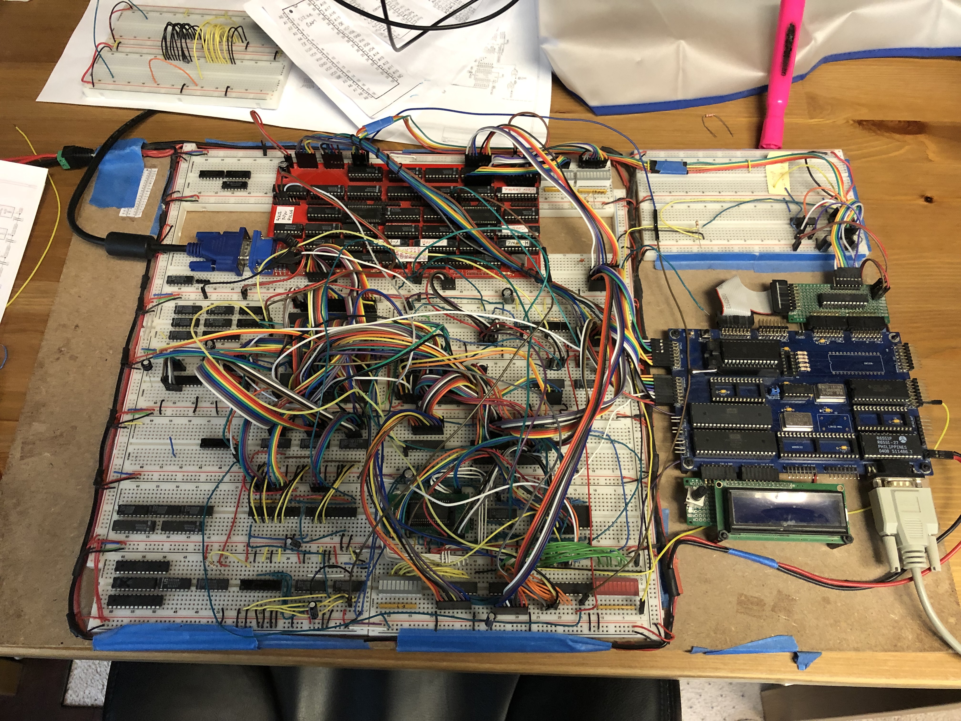

Again - it was a very long time since the last post - but the project is still alive. Actually it's better than alive, it's working. This is a test image of pure TEXT output.
Here's how it looks like on a breadboard:
I attached the schematics as well.
Now why did it take so long?
  • it was complicated - far more complex than I imagined
  • if you have only 30-60min each day at night when you are tired progress is slow
  • you don't have any time to yourself during Christmas vacation :P
  • you are bound to make many mistakes, and motivation to debug sometimes is low
  • especially when something works, than does not work next day
  • only after I discovered load from a logic analyzer might positively impact your design things became more stable
  • pull-up resistors are better stabilizers than load from a measurement device

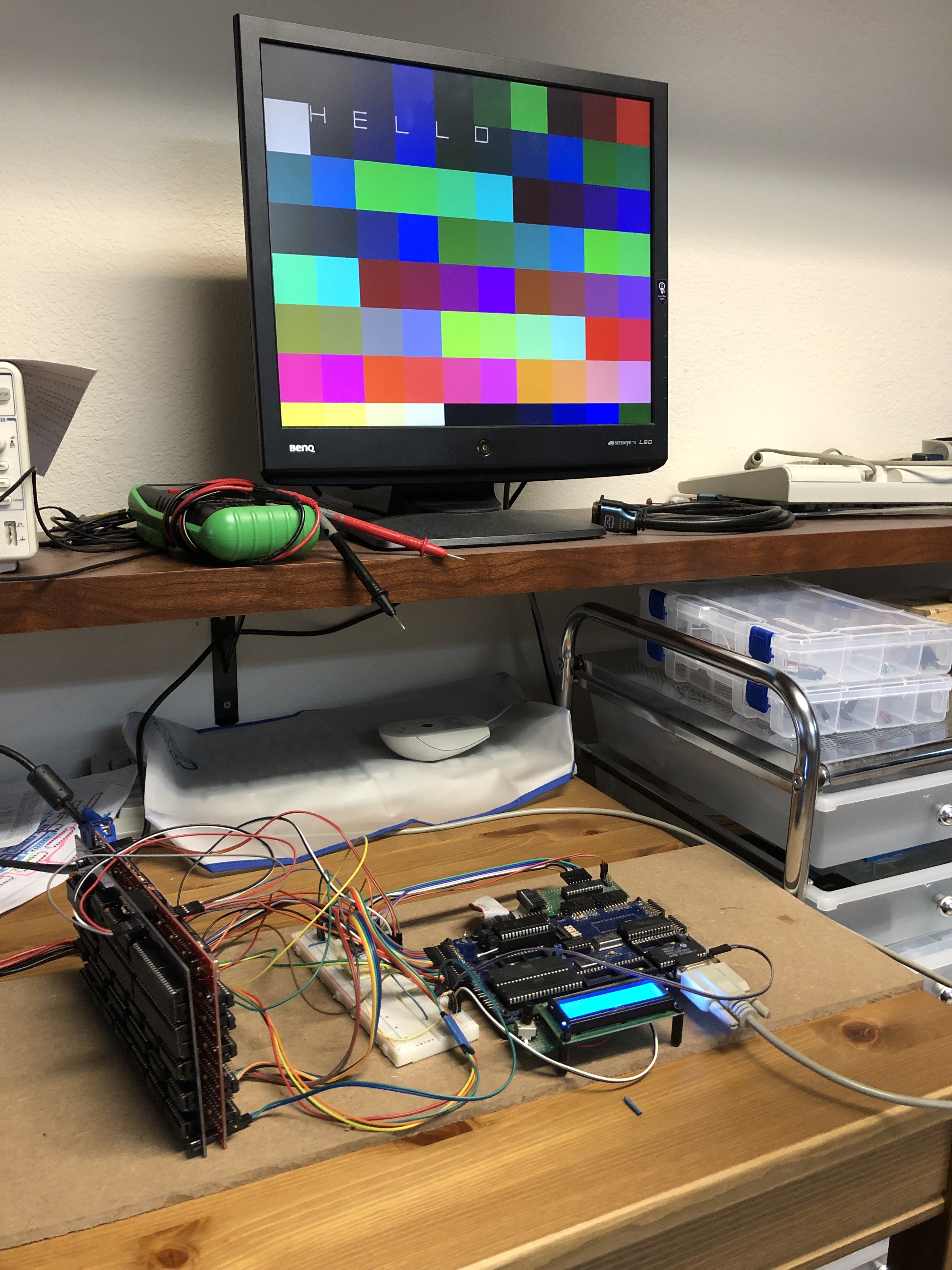

The PCB I created (and ordered from China) worked mostly. Here are both cards combined showing text output

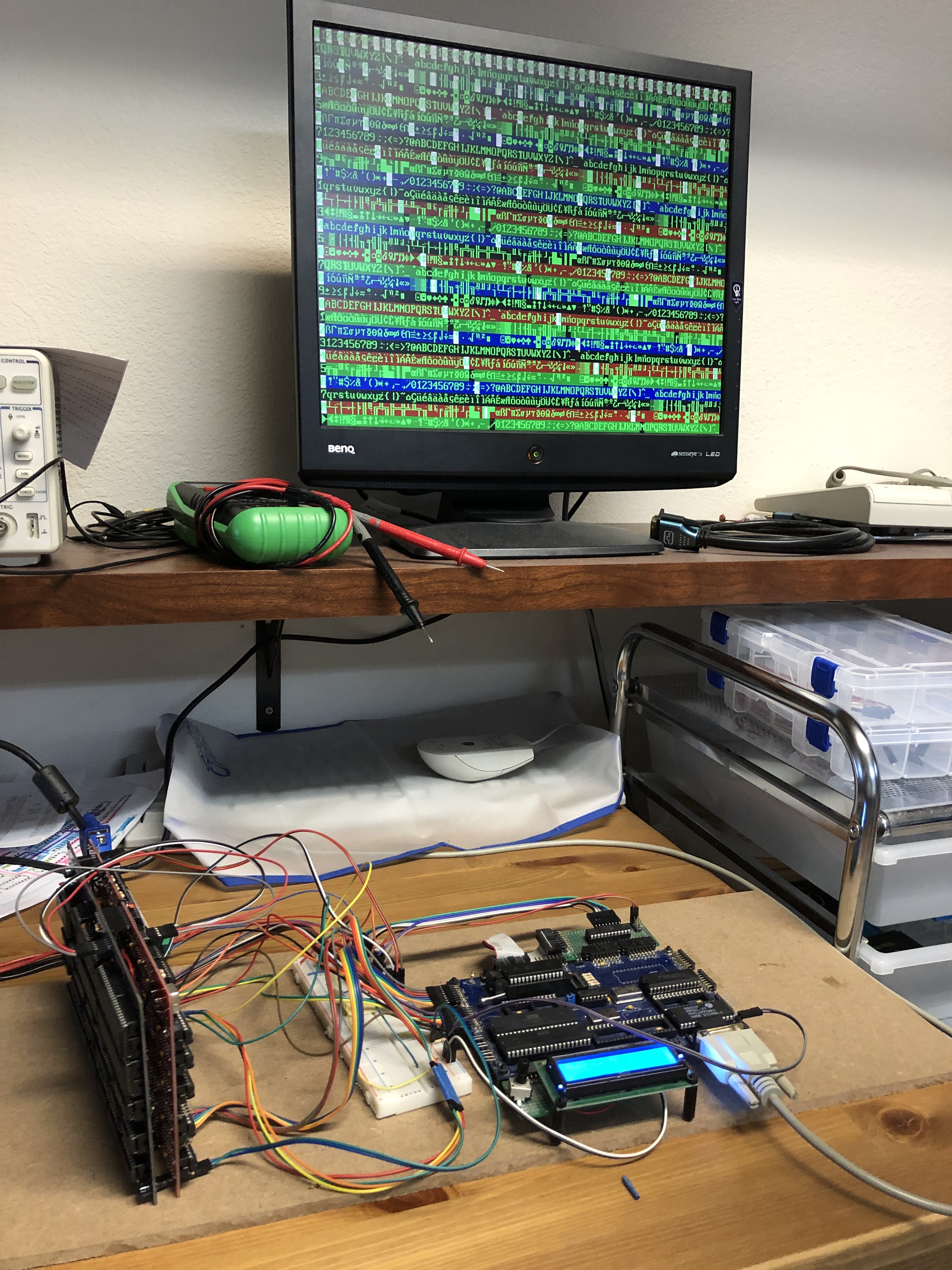

and here doing graphics
There are 2 problems still. Column 0 of the text output is not 100% correct, some timings seem to be off. Far worse is an issue caused by the 4 Y address lines connecting the 2 boards. If they are directly connected via short pin headers the output goes black. If I connect them via 40cm wires as shown in the pictures it's working. Either reflections, or timings, or cross-talk is causing an issue here.
