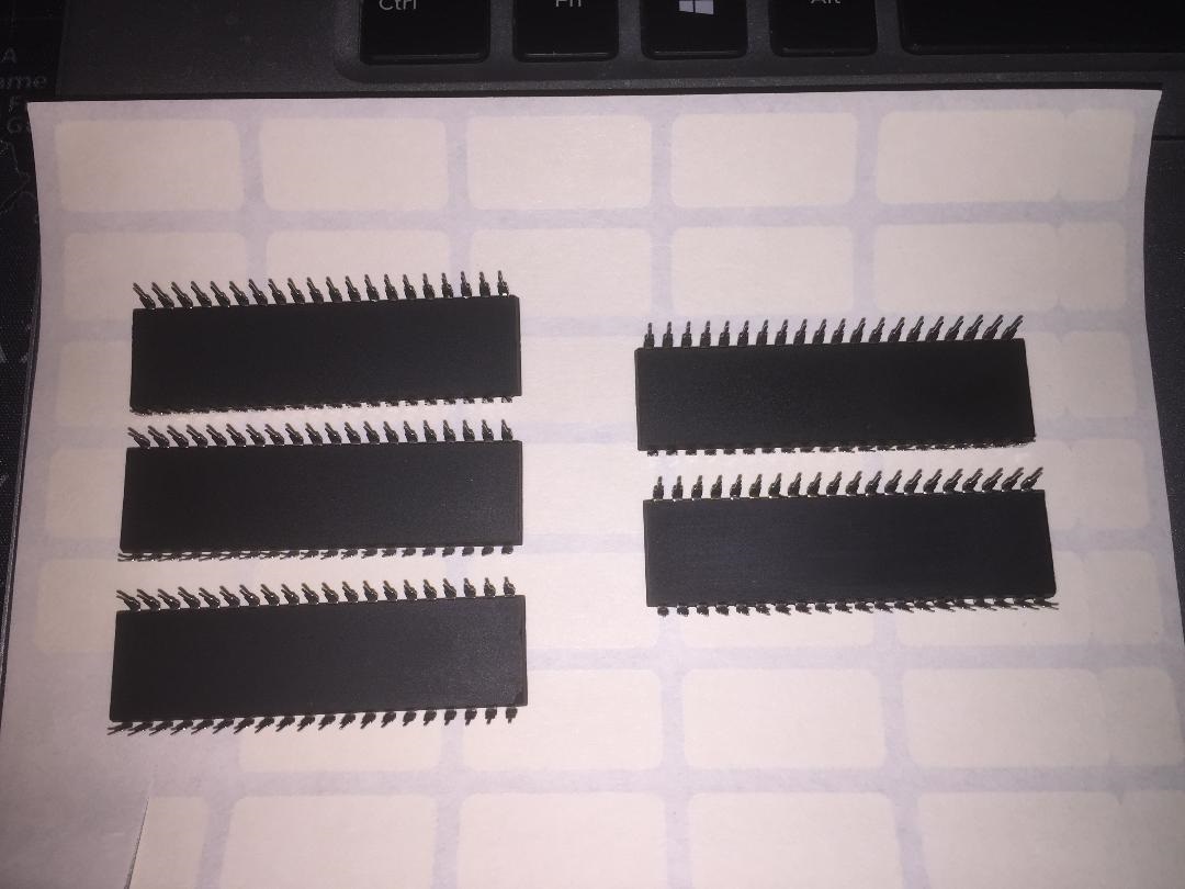

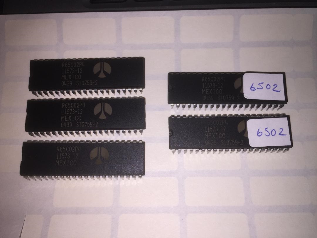

I ordered 5 R65C02-P4 chips from eBay seller smart_gogo as an experiment and they arrived today.

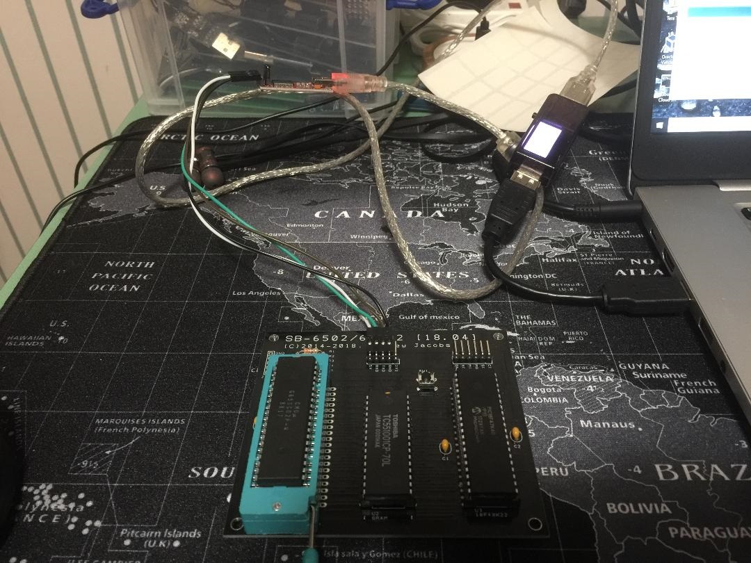

I've tried them all on my three chip board which works out the chip type from looking at how a JMP ($FFFF) instruction executes. I have also run a variant of Chromatix's code that produces a slightly more verbose description.
The good news is that all five chips are fully functional at ~1MHz but two are actually 6502s. I can't test them at a higher clock speed.
All the chips have the same marking and the bottoms are clear of any printing/engraving.
I power my boards from a USB serial adapter connected via a USB voltage and current monitor. The 6502 chips draw 0.12-0.15A compared to 0.05A when a 65C02 is installed.

Looks like one of them is missing the bottom line of the silkscreening - the one with the datecode! I assume the brush wasn't quite pulled far enough on that pass.
Two NMOS, okay, but are the other three real Rockwells or plain CMOS?
Possibly not the best photos. All the chips have all the lines.
I'd say two are NMOS 6502 and the other 3 are CMOS R65C02's. They are compatible with the 6502 pinout.
I wanted to test my board with R65C02s. Previously I only had W65C02s. The PIC firmware detects them as 65C02.
Do you measure the voltage at the board itself, after the USB cord and connectors? I had to use USB in a work project last year to charge batteries, and had to limit the current to 250ma at my charging circuit, because at 500mA the microUSB connectors and thin commercial cord were dropping the voltage from 5V down so low that the PIC microcontroller would go into brown-out reset. (Then I changed the design so the µC was powered off a 5V regulator from the 12V batteries that the USB was charging after a boost circuit. The current into the batteries, trading current for voltage, with some inefficiency, was only about 60mA.)

Its probably not that accurate a setup. A short cable from my laptop to the power monitor then a 1M USB cable to the FTI232RL module and 6" jumper wires to the board.
