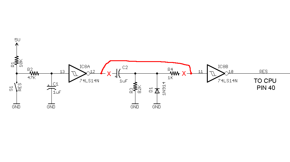

Posts: 3525
Re: Help using cc65
GaBuZoMeu wrote:
IF your EPROM isn´t selected at all there is no bus driving at all, so you frequently get $FF as "answer".
GaBuZoMeu makes a good point here. And single-cycle execution is one way to ensure your EPROM is selected when needed.
Earlier I mentioned a simple test for single-cycle execution. On reflection I see it can be simplified even further. But first:
In the PS to my earlier post I mentioned that a 6502 requires clock pulses as it performs its reset. This applies to the 'C02 as well. Your circuit will require a small change, as shown below. In red I've shown how to bypass components that limit the length of the reset pulse to a very short time -- too short for you, a human, to manually request a few clock pulses from the arduino. Hence the need for the circuit change.
(On 'C02 there's no need to limit the length of the reset pulse. FWIW, even on NMOS '02 the need is questionable. There's a forum thread about this here. Followups to that discussion don't belong in this thread.)
modified RESET circuit.png (7.63 KiB) Viewed 3399 times
Here's the simpler single-cycle test I propose:
  • issue a half-dozen clocks
  • press and hold the Reset button (which should force low the CPU /RESET on pin 40)
  • issue a few more clocks -- at least two
  • release the Reset button
  • issue two more clocks
  • stepping onward, and monitoring the RAM /CS input, you should see a dummy stack access lasting three cycles
  • stepping onward, and monitoring the ROM /CS input, you should see the vector fetch lasting two cycles (for the low byte then high byte)
The cycle following the fetch of the vector high-byte should be the start of your program. On the data bus you should see the opcode of the first instruction of the program. If this isn't present then you need to find out why -- there's no use going any further.
If the first opcode doesn't appear, maybe the ROM isn't getting a Chip-Select. Or maybe the vector bytes are muddled up somehow. To see about that, rerun the test but stop sooner and see what's on the data bus. You get the idea...
whew! Did I miss anything? Any questions? Good luck, and keep us posted! :)
