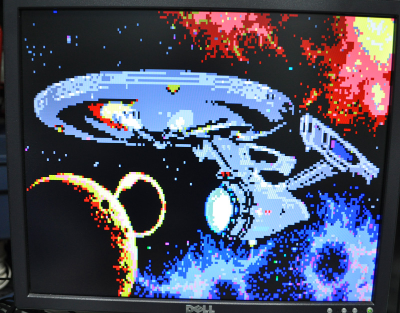

Here is an image being sent form the 6502 memory out to the simple Video generator memory mapped to address 12960...
Video is 216x120 Resolution with 16 Colors.

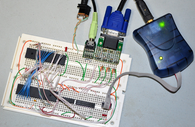

This is the current state of the hardware now...
A Vic-20 like Computer with 3 Chips and 10 Resistors.
There are 3 chips on the board : 65C02, AVR1284, and 74HC574.
The other black chip looking thing is the 25MHz oscillator.

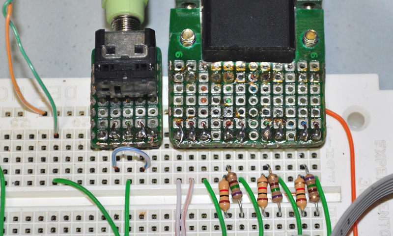

There are also 10 resistors : 6 for the Video DAC and the rest for the 6502 pullups.
Here is a closeup of the ultra complex, super high quality Video DAC (AKA - 6 resistors)...
The RGB+I DAC generates 16 colors : 8 hues with 2 intensity levels.
