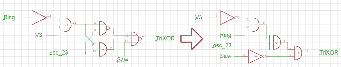

Posted: Tue Jul 19, 2016 12:54 pm
by ttlworks
Generation of TriXOR:
From the logic design point of view, it looks like V3 really gets inverted there...
but I don't know, why.
Generation of the Saw_bits:
