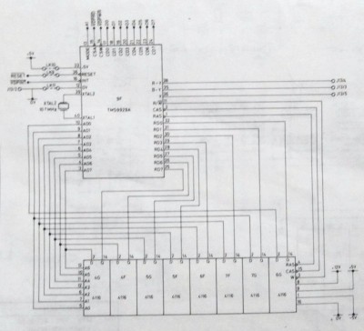

My CPU is NMOS so my logic ICs are currently TTL [ ... ] I am assuming they intend the designer to use a 74LS04 or perhaps 74ALS04 as the logic IC, because the schematic was created in 1982. That would mean the outputs of the NOT gates would be TTL.
74HC and 74HCT came out in 1982. I would use 74HCT. Its input levels are compatible with TTL levels (hence the "T"), but it takes a lot less current than TTL, and its wider-ranging output voltage is not a problem; in fact, 74HC(T)'s fanout is 10 LSTTL loads.

Hang on, if you're using a clock generator, you don't need to worry about resonance - and I thought you said that was your preference?
I would expect the pullups are needed, and are strong, because the expectation was that the inverters are TTL and don't pull to the rail. So if you choose a logic family which does pull to the rail, you can probably do without the pullups.
It might be important that the two inputs are driven as shown, which is to say with one gate delay of lag, so I'd suggest you do the same. Driving with an actual two phase clock might be worse, in this case.

You could try just connecting a timing crystal across the 2 XTAL pins without any extra components.
See the schematic from the MTX500/512.
Slightly blurry shot of the TMS9929A section of the MTX500 schematic
NB The MTX is a Z80 system, but I don't think that makes any difference.
