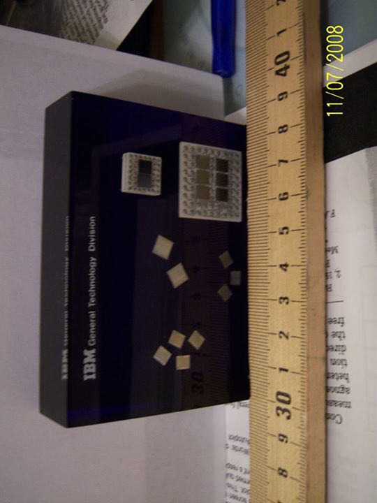

8) So, in summation, the FPA/FSA imager would best be done with a multichip module ( download/file.php?id=2948&mode=view, download/file.php?id=2946&mode=view ), and in some sort of geodesic shape, goldberg polyhedra ( https://en.wikipedia.org/wiki/Goldberg_polyhedron , https://www.jstage.jst.go.jp/article/tm ... 0_104/_pdf , and, formerly an awesome site, but presently somewhat diminished in functionality, http://polyhedra.org/poly/!).
My calculated Petzval/Coddington curvature ( download/file.php?id=2971&mode=view) should be assessed and questions about the fucntional human eye, in vivo, should be discussed. The work of G.H . Gliddon (Dartmouth and Rochester U, circa 1920s) should be assessed and re-done with modern equipment and optics (Low ref. index plastics/polymers, ideally, but CaF2 might be a low cost solution). The image sensors should be back-illuminated, probably CCD, though CMOS, I hear, is making strides to overtake the "industry standard" CCD. Backside thinned should be investigated, though the thinning of the silicon might (WILL!) cause the sensor to curl up on itself and straightening it out might require a bulkier package and reduce the space for fitting each sensor into the array. So, maybe too bulky for a FPA/FSA? Finally, one should note that the smaller the image sensor, and package, the closer the "linear", planar ICs can be made to fit the curved surface fo the "robot retina".
