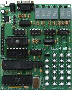

Re: Getting young people into 6502
whartung wrote:
quick web search for "Micro KIM" turned up as the first result http://www.brielcomputers.com/wordpress/?cat=24, where it says, "With a projected selling price of $99 the micro-KIM is one of the most affordable 8 bit computer kits available today. As a matter of fact, the micro-KIM was designed around the student market in an effort to offer students and schools a low-cost 8 bit CPU trainer."
It does however use RIOT ICs which are no longer made, and has very little memory. I guess the point really was to bring back the original 1975 KIM computer.
Here's a relevant quote from the webpage regarding the RIOT:
"Some components on the original KIM-1 are no longer available. The 6530 RIOT included a custom programmed ROM and has been replaced by a 6532 RIOT and an external ROM. "
The 6532 RIOT is available at Jameco; here's the link:
http://www.jameco.com/webapp/wcs/stores ... llDownView
There is also a 32k expansion card available for the microKIM.
Toshi

True, but the 6532 is not being made anymore, so when they're gone, they're gone, unlike the 65c22. Also, the price of a 32KB SRAM is about the same as the price of an 8KB SRAM, if they would just put it in to start instead of making it an add-on accessory board. It looks like the idea specifically to make it like the original, for better or for worse.
