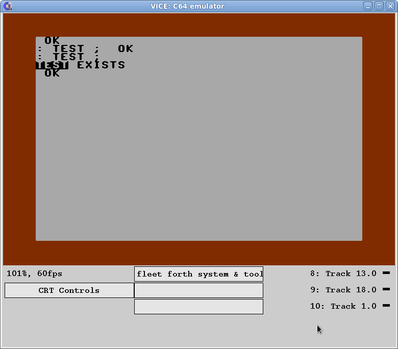

Re: Extra stacks
Posted: Mon Oct 05, 2020 4:07 am
by GARTHWILSON
IamRob wrote:
Another use for the ZP location is the loop variable doesn't get retained when LEAVE is encountered. So I will use: I Z! LEAVE in words that contain a loop that exits prematurely.
How 'bout just having LEAVE store the loop index in a variable, all in the one primitive so it's faster. I think I'll do that myself.
Re: Extra stacks
Posted: Mon Oct 05, 2020 6:34 am
by GARTHWILSON
Jim, you have quite a few words above that are neither part of any standard I know of, nor defined above. One I'll ask about however is REDEFINE:. It appears to edit the old word to redirect execution to the new one, for secondaries that are already compiled using it, so those secondaries don't need to be recompiled.. Is that what's happening? I've had a way to do that but I like yours more.
Re: Extra stacks
Posted: Mon Oct 05, 2020 8:14 pm
by JimBoyd
No. Sorry, I should have been clear about that. This section:
: >R >A ;
REDEFINE: >R
 OK
: 2>R 2>A ;
REDEFINE: 2>R
 OK
: DUP>R DUP>A ;
REDEFINE: DUP>R
 OK
: R> A> ;
REDEFINE: R>
 OK
: 2R> 2A> ;
REDEFINE: 2R>
 OK
: R@ A@ ;
REDEFINE: R@
 OK
is part of the log of the interactive session where I hand traced the word (DR/W) . I had modified it to make it easier to support the 1581 disk drive as well as the others.
"REDEFINE: >R" is a message from the system letting me know I redefined >R . It's harder to tell that from the print dump than a live session so I may change that message to something like:
"YOU REDEFINED >R"
or even
">R EXISTS"
or maybe
">R REDEFINED"
or even
">R WAS REDEFINED"
Your comment does give me an idea and I'll have to give it some thought.
I already mentioned the string "REDEFINE:" is a message from CREATE to let me know I redefined a word. I've changed that. CREATE will now print the name of the word followed by the string "EXISTS" when there is a redefinition.
: TEST ;  OK
: TEST ;
TEST EXISTS
 OK
One point to keep in mind with these session logs is that the printout does not show a distinction between what the programmer types and the computer's response. It is a faithful printout of the text sent to the computer screen.
