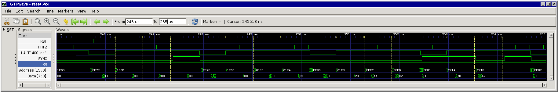

Posts: 11464
...One thing that does bring to mind however is that even at reset, the processor does immediately write to the stack in page 1 (since it comes up in emulation mode), before even the first instruction of the reset routine is fetched...
Hi Garth
are you sure about this? It looks like the nMOS 6502 doesn't do this - indeed it seems like a bad idea because reset writing to the stack is a destructive thing to do. (Even if reset was used as a warm reset, one wouldn't normally worry about preserving the stack content, but even so... maybe page 1 has something important mapped in, even peripherals, or the famous 128 bytes mapped into both pages 0 and 1.)

Posts: 11464
Hi Garth
Michael Steil says that the normal interrupt sequence is followed - there are three stack accesses - but that RnW stays high, so there are no writes.
Do you believe you saw writes, or did you just see the addresses?
(I'm interested in this because I want to trace the part of the design which adjusts RnW.)
ps. I'm not sure yet I agree with his statement "When a 6502 is turned on, the stack pointer is initialized with zero." but I haven't yet run this case through visual6502.
Posts: 8775
I'm sure I saw writes (ie, R/W\ was low) but I'd have to dig it up to be more than 90% sure.  The WDC manual also says they are writes, with R/W\ low.
In school in 1982 we were taught to always initialize it in the reset routine.  That was on the NMOS 6502 but what I find in WDC's data sheet is "All Registers are initialized by software except the Decimal and Interrupt disable mode select bits of the Processor Status Register (P) [which] are initialized by hardware." (page 11).  IOW, your reset routine has to initialize all but the D and I flags.
If you leave the entire page 1 of a 6502 for the stack, it wouldn't really matter if you initialize it, because there won't be anything to overwrite; but my own tests have shown that I don't need anywhere near that much stack space even with heavy use of subroutines and interrupts; so I use some of page 1 for variables and of course the stack must be kept in its place to avoid stepping on them.  [Edit, years later: There is another good reason to initialize the stack pointer, which is to make sure you don't accidentally index into page 2 if the stack wraps.  More on this in my stacks treatise, starting in the middle of page 4 on stack addressing, at http://wilsonminesco.com/stacks/stackaddressing.html .]

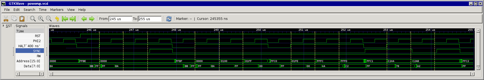

HiassofT
Posts: 36
Joined: 02 Sep 2010
Location: Salzburg, Austria
Post by HiassofT »
Very interesting, thanks for the info!
After Michael's blog post I was very interested about seeing this in action so I hooked up my logic analyzer to my Atari 800XL and captured some traces.
Unfortunately Antic dram refreshes destroy the nice pics, just ignore all cycles where HALT is low (in the pics I shifted halt by 400ns so that it's in sync with the stopped clock cycles). To make the actual CPU cycles easier to recognize I set a marker at the start of each CPU cycle.
Here's the powerup:
And here's the reset:
I hope that I'm able to capture traces of the 65C02 in a few weeks, a friend was so kind to send me a few 65C02s, now I only need the adapter board.
