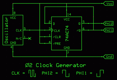

As an afterthought: Does the CPLD drive the CPU clock input?
No. The below circuit generates Ø2 and delivers it to both the '816 and the CPLD. In fact, I tried to arrange the PCB layout so the distance from the flop's Q output is about the same to both the MPU and the CPLD to keep clock skew out of the picture.
Clock Generator
Clock Generator
PHI1 is not used.

While contemplating this matter, I was staring at the schematic, specifically the clock generator circuitry, and thinking about what goes on inside the '816 while RDY is low. That's when I decided the solution might be in halting the clock during Ø2 high for the required amount of time and then letting it resume. I would be simulating externally what the '816 does internally during a wait-state (also when the WAI instruction has been executed).
The basic clock generator circuit in all my POC units is:
Two-Phase Clock Generator

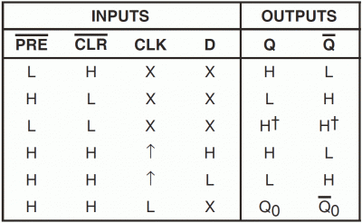

I use the 74AC74 flip-flop to strengthen the clock signal, assure symmetry and in the case of V2.2, generate the Ø1 signal that gates the bank bits latch and the data bus transceiver. As is typical of this sort of circuit, the /CLR and /PRE inputs to the flop are tied to Vcc, which causes the flop's Q and /Q outputs to follow the D input as the clock oscillator's output goes high on each cycle. Of course, /CLR and /PRE can be used in other ways, as can be seen by examining the flop's function table:
74xx74 Flip-Flop Function Table
In particular, note the first row in the table, in which /PRE is low. In this case, Q will stay high and /Q will stay low, without regard to what is going on at the CLK and D inputs. Q high and /Q low is the Ø2 high state.

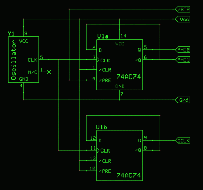

So, my thinking goes, if I assert /PRE when a wait-state is needed, Ø2 will be "frozen" high, causing the '816 to halt as though RDY has been brought low. With Ø2 continuously high, the state of /RD and /WD will be maintained. At the same time, Ø1 will be "frozen" low. Hence the data bus transceiver will remain gated to maintain the path between the '816 and the rest of the system, and the bank bits latch will remain closed, thus maintaining the state of A16-A19. So far, so good.
Naturally, solutions may give rise to new problems. Since it would be the CPLD that would make the determination when a wait-state is needed and how long it should be, it must have a continuously running clock input and most importantly, that clock must stay in sync and phase with the Ø2 clock when the latter is not halted. The unused second section of the flop can be used to produce the CPLD's clock, which is referred to as the GCLK.
Here's the modified clock generator circuit:
Modified Two-Phase Clock Generator
Note the netlist symbol /STP (top right corner). This will be an output from the CPLD. Normally, /STP will be driven high, keeping U1a's /PRE high—Ø1 and Ø2 will run. When the CPLD has determined that a wait-state is required, it will drive /STP low, driving U1a's /PRE low and freezing the Ø1 and Ø2 clocks.
Where the trickiness will come in is in timing. If this is to work, the CPLD must assert /STP immediately after GCLK has gone high in order to start the wait-state. When the wait-state has expired, /STP must be deasserted immediately after GCLK has again gone high so Ø2 and GCLK remain in phase.
Opinions?
Incidentally, I'd expect this arrangment would also work with the 65C02.
