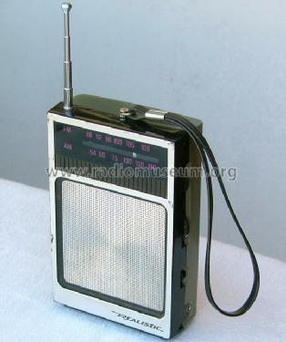

Re: POC VERSION TWO
I've been regularly using this Radio Shack Realistic 12-714 radio since Dec 1981:
:D I've fixed the earphone jack a couple of times, and the battery snap a time or two, and sprayed the volume control with contact cleaner, and today it works the same as new.

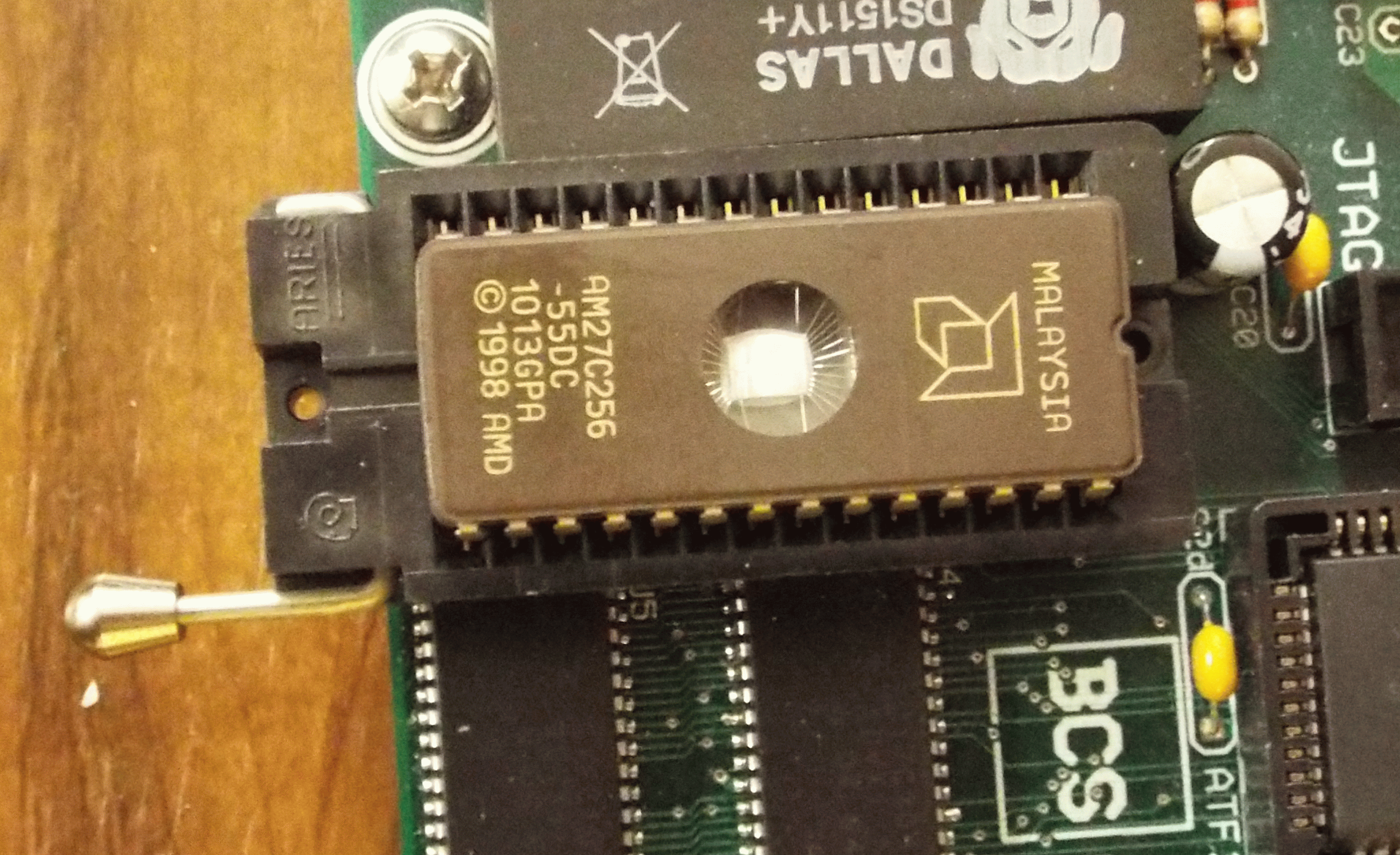

There was a bug in the older CPLD code but that wasn't the cause of the trouble. The trouble was coming from an unsuspected place.
When I did the layouts for both versions of POC V2, I allocated enough room around the ROM so I could piggyback a ZIF socket into the ROM's socket to make it easier to swap out ROMs during firmware development.¹
POC V2.0 w/ZIF Socket Installed
The ZIF socket I've been using was one I had used in the past for testing ROMs in the empty ROM socket in the Commodore 128. It had gotten quite a bit of use and had laid about for a while before being pressed into service with POC V2. The socket turned out to have an intermittent connection in it.
How did I figure this out, you ask? I couldn't get POC V2.0 to run properly after making nothing more than a cosmetic change to the test firmware code I was using, a change that simply moved some text from one place on the screen to another. In trying to figure out what the heck was wrong, I put the previous (working) ROM back into the ZIF socket and it too seemed to have the same problem. You can imagine the language I used when that happened! :evil:
So there I sat, baffled by what was going on, thinking I had a flaky ROM, when it suddenly occurred to me I was overlooking something else, which was the ZIF socket. It made sense: both versions of POC V2 were displaying similar problems, even with firmware code that had worked before. Also, as I was testing, I was constantly moving the socket from one unit to the other. In other words, I was moving the source of the problem from one unit to the other when I moved the socket.
With all that stewing in my little dinosaur brain, I yanked out the ZIF socket and plugged the ROM directly into the socket soldered into the board. I powered up, the unit came to life, the POST screen was displayed and the logic probes indicated normal activity on /IRQ and RDY.
I let the unit run like that for several days and then powered off. I unplugged the ROM, put the ZIF socket back in place and put the same ROM in the ZIF socket. Sure enough, the unit didn't boot. Just for grins, I powered down, pressed down on the ROM with my thumb, and then powered up. The unit booted and the probes indicated normal activity.
I also tried the above series of tests on POC V2.1, using a ROM I had burned back in November and knew was functional. Same results: with the ZIF socket installed, sometimes the unit would behave and sometimes it wouldn't.
I have ordered a new ZIF socket, which I hope to receive in the next day or two. Presumably it will function as it should and I can get on with developing firmware.
¹In future endeavors of this kind, I will solder the ZIF socket into the prototype's PCB instead of piggybacking it on the ROM socket. The only reason I didn't do that with POC V2 was the frugal Irishman in me didn't want the 15 dollar ZIF socket becoming a permanent part of the assembled unit.
Re: POC VERSION TWO
I've had a few problems with ZIF sockets over the decades, that they did not grab the EPROM pins firmly enough to make a good contact. The green 3M ones were the worst. Forcing the EPROM side to side to scrape the contacts as I slowly tightened the socket usually did the job.
Posts: 9425
Re: POC VERSION TWO
I can vouch that the green 3M sockets as being junk. I've had grief with them in the past.
I did try "scraping" the contacts by wiggling the ROM as I closed the socket, thinking that was all it was. It didn't turn out to be the case with this particular socket. I'm guessing it's an internal mechanical problem.

So, this was it? The ZIF socket? The authentic "Gremlin Brand ZIF Socket"? This is what's been causing your recent woes?
That's great you found it.
Posts: 9425
Re: POC VERSION TWO
It appears to be the socket. :evil: It's an Aries socket, which is not a cheap brand.
