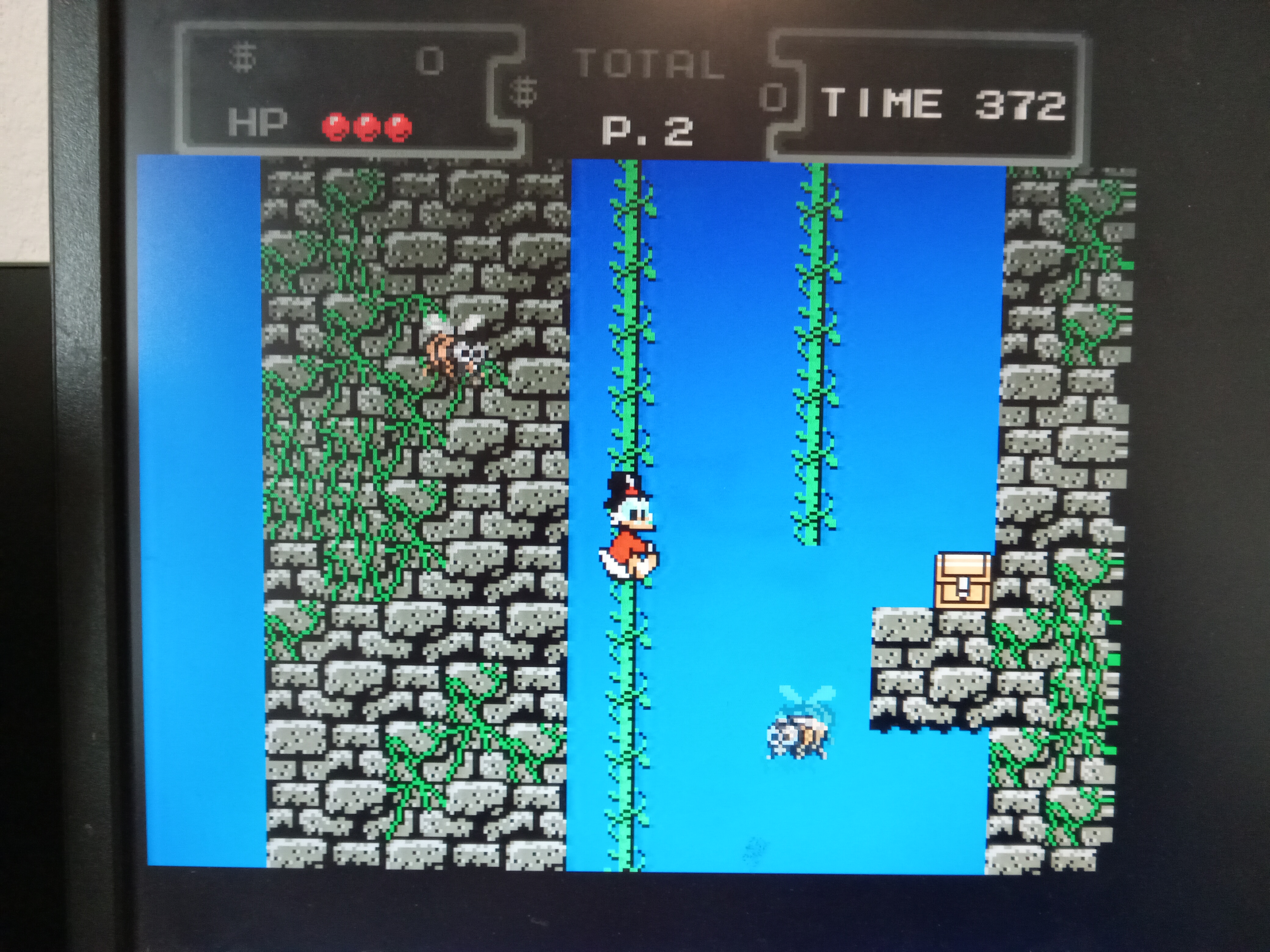

Thankfully I found one game that really hates my emulator: Duck Tales. It has been caused more of these exceptions than any other game. It happens to be UNROM game which makes it easier to track cartridge access locations. So I'm leaving Scrooge McDuck hanging on a vine between some bees in hopes of a glitch. Too bad this game has a timer, else I'd leave him hanging there all day. Tuck it in, Duck!
While doing this, I found that it is indeed reading from cartridge ROM before glitching, and both times it was a branch instruction (first was BEQ and the other was BCC). It seems to be reading from the ROM correctly, so perhaps it was the branching that has been causing all of this. We'll see! More testing ahead.
Thank you again John. And everyone! These little comments help more than you know.
Chad
EDIT: Without having to make a whole new post, I just wanted to give a small update. Duck Tales isn't glitching anymore, but Kirby glitched twice within a minute! Tracking it down, it is coming from LDA abs and LDY abs instructions. Huh? Going to the code I found my general cpu_read() function returning an unsigned char but being added to an unsigned long. Hm. So now I did:
addr = (unsigned long)cpu_read(pc++);
addr += ((unsigned long)cpu_read(pc++)<<8);
value = (unsigned long)cpu_read(addr);
Since then Kirby hasn't glitched at all. Hm! Regardless going forward, I think I have a way to at least narrow down the exception, now that I know what to do and what to look for. Yes, typecasting isn't as straightforward as I had previously thought. Alright, thanks everyone!

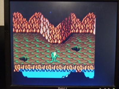

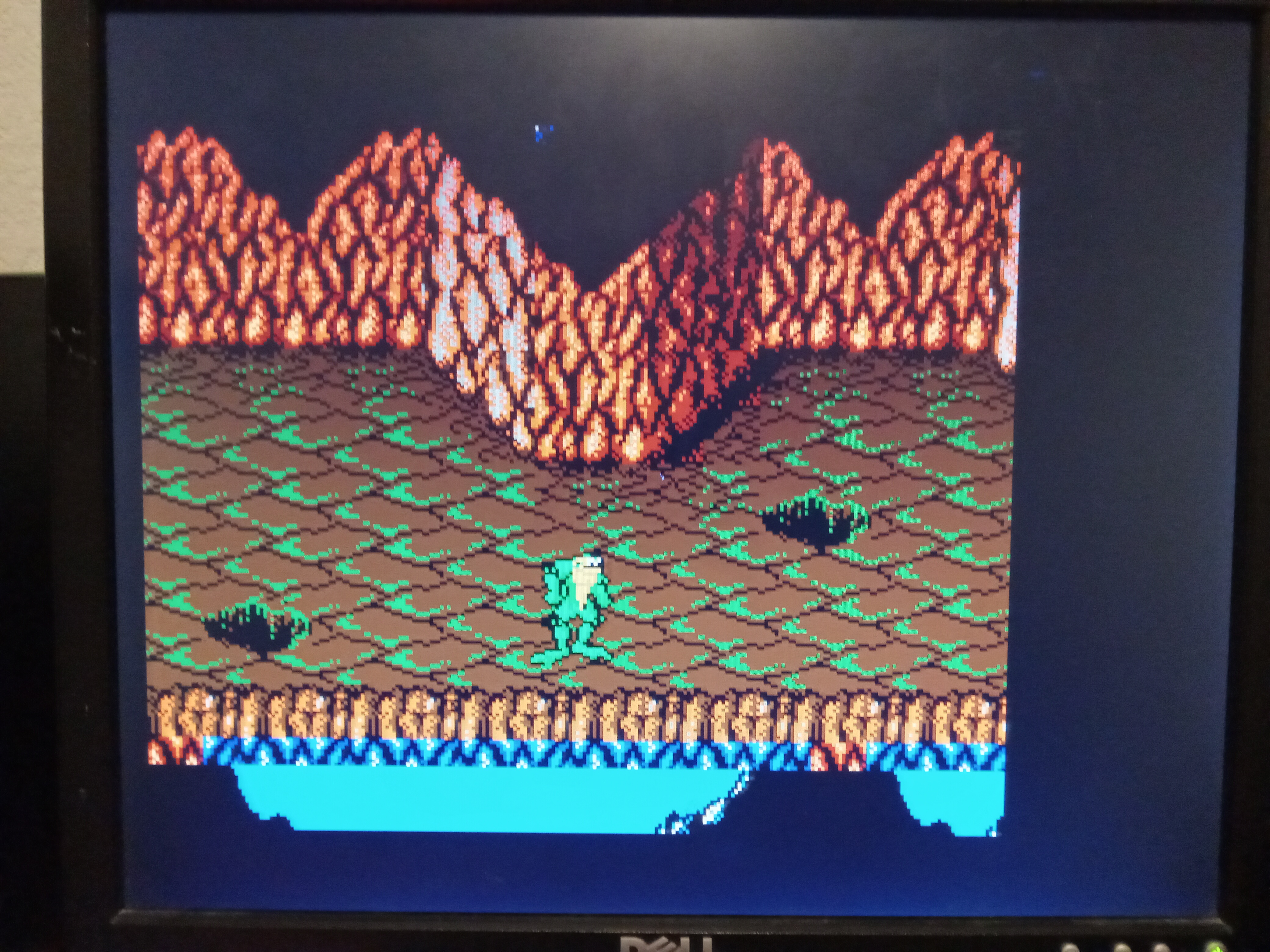

This made me think though. Something I haven't mentioned is that I've been burning the NES ROM's onto the chip each time I load a new game, or after reprogramming it. As in, half the chip gets burned TWICE as much: Once for re-programming, once for loading the ROM onto the chip. Perhaps that also is contributing to its issues. When I am burning the ROM into flash memory, I now have a read-back function, comparing it with the original on the SD card. So far that's never errored, but it is there now. But again, who knows what happens at high or low voltages? There would have to be some extensive testing.
In the end, turning ECC code protection off has been working great (for now!). I really wish I could have thought about a possible electrical issue earlier, I could have saved a lot of time and heart-ache. But, of course I learned a lot, and that's important too. Yay for learning :/

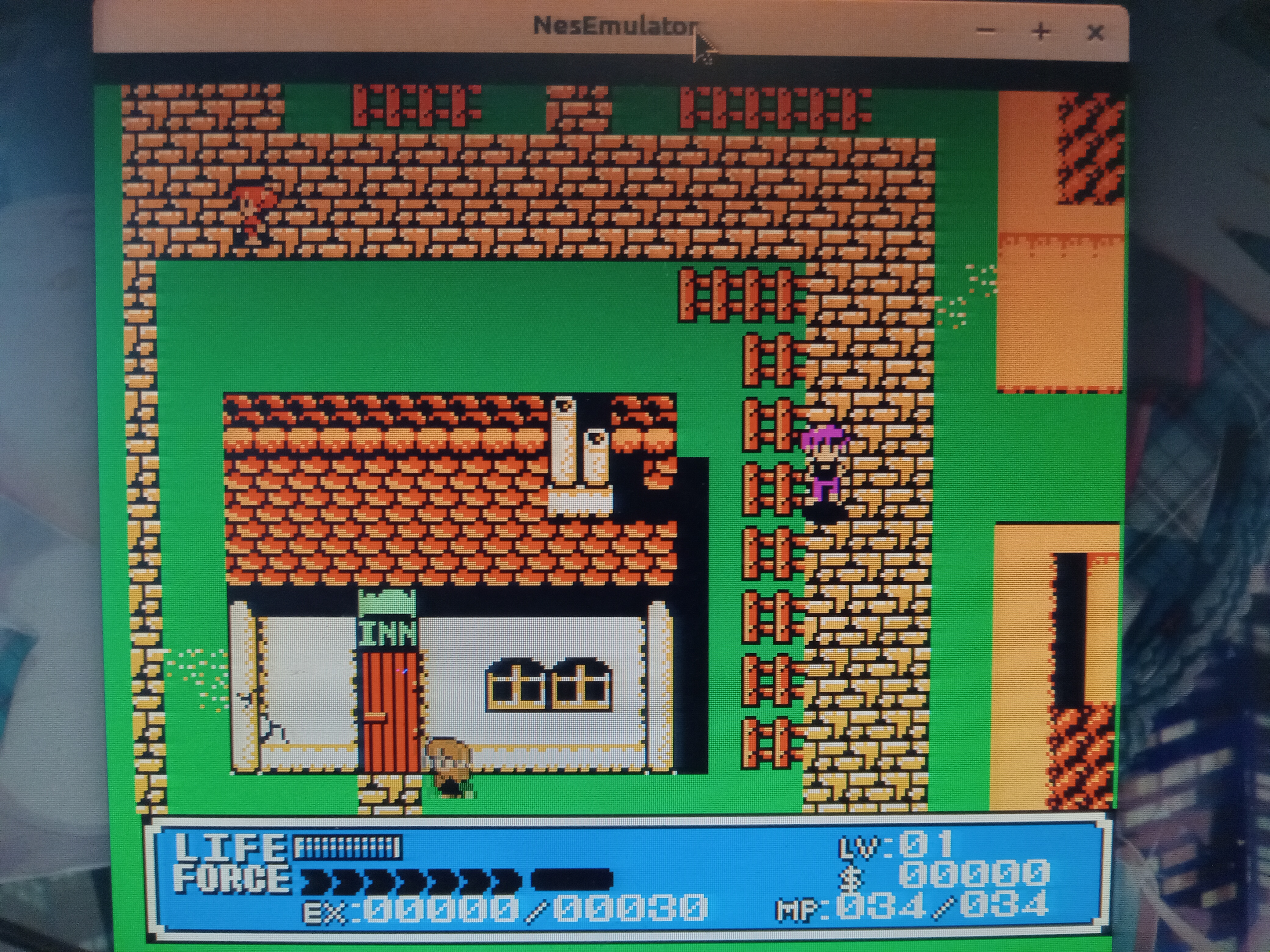

Because of my lack of racing-type games, I decided to (re)implement the ANROM mapper. I got RC Pro AM 2 to work really well, and Super Off Road to work ok enough. Of course the infamous Battletoads game is also an ANROM, and I decided to try it out. And yeah, it's playable, but no status bar, and the scrolling is weird. Oh well, I'm leaving it on my main list simply because it is Battletoads, it gets a special place in every emulator's (digital) heart :)
Alright, 55 games on my list now! They have ratings of Perfect (i.e. Super Mario), Great (perfectly playable, minor graphical errors, i.e. Kirby, after hacks), Good (incredibly playable, major graphical errors, i.e. Zelda), and Fair (mostly playable, severe graphical errors, i.e. Battletoads). Again my code and list is all here:

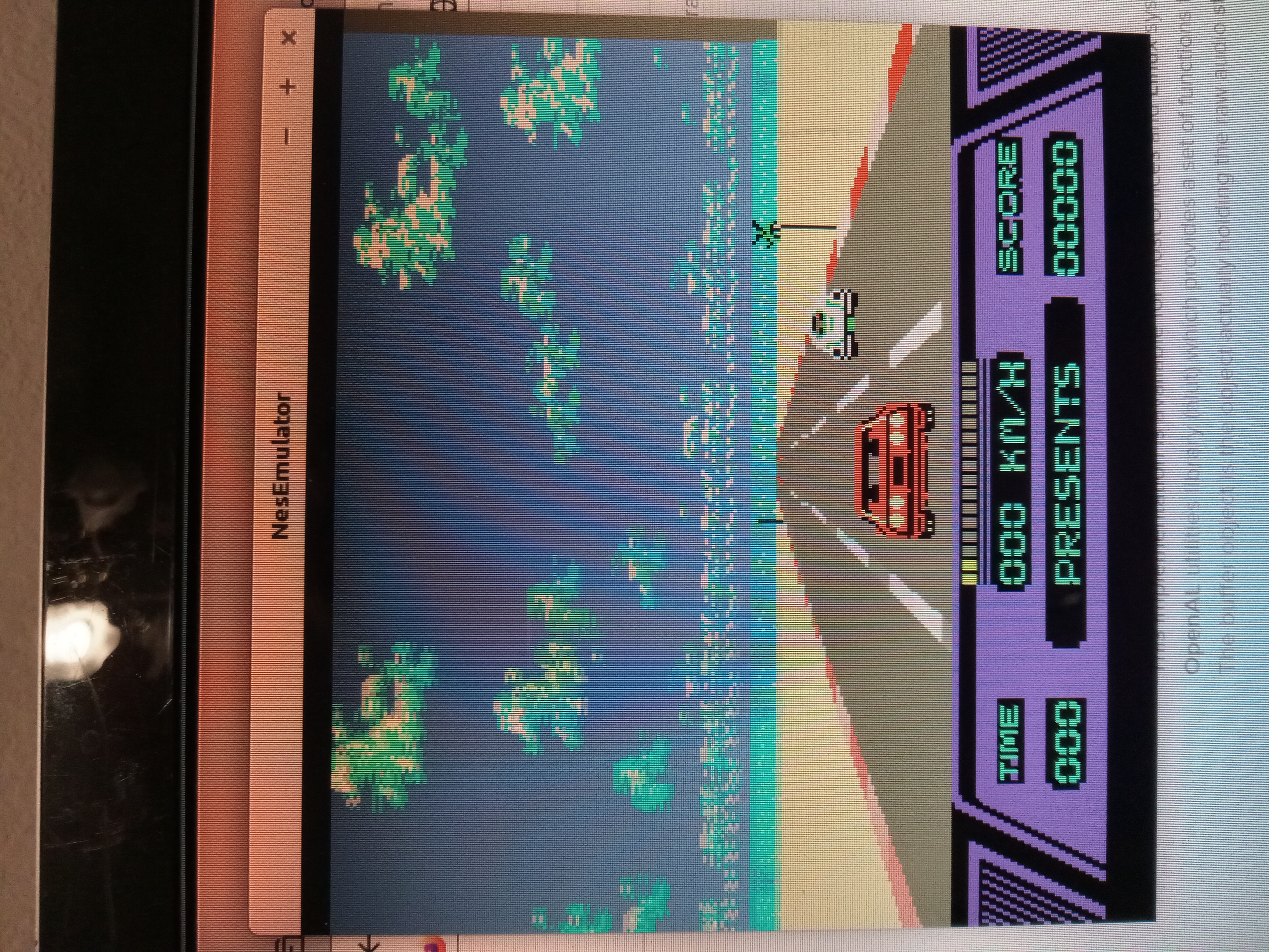

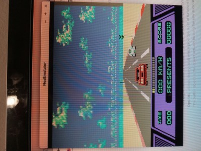

I couldn't let it go!
See attached, I got Rad Racer to work!!! That game always was so glitchy, but it finally works :) How?
Short story short: I ported my NES emulator to my desktop, running it with Linux/OpenGL. Once I got my old emulator fully ported, I decided to start messing with the PPU registers. What I had been doing is drawing a full scanline at a time. This worked well in most cases, but did not work well in games like Rad Racer. What I wanted is to draw each background tile as it should be drawn within the frame's CPU cycles. After a bit of crazy math, it works really well now :)
But now Mario 3 isn't working. Why? Because I had to hack the sprites last time. I'm still drawing ALL of the sprites at once, which does not work well with Mario 3, Kirby, Ducktales, Gradius, etc. The hack I did last time was "draw top sprites at Sprite 0 Hit", then "draw bottom sprites at V-Sync". That works, and currently I will still have to do that if I want to keep this emulator "microcontroller friendly". *shrug* At least I'm making some progress.
I plan on un-porting this to the PIC32 soon, but being able to compile/run SO QUICKLY using the desktop helps so much, and it doesn't burn out my chip in the process. Going forward I think I'll try to make all development and testing on the desktop first, THEN port it over when I'm happy with the results. Learning :)
There's the update. Thanks!
Chad
